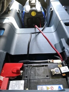

*Update* Dead truck Part 3-Battery/Drain/Charging Epic fail

There have been a number of charging issues on the Eco/Boost as well- I am hoping that this is such a catastrophic voltage drain that it's easy to location/fix - Already had a smart junction box and engine fuse panel replaced for a separate issue- Had my battery replaced in November since I was getting charging faults- That turned out to be a loose battery lug from the factory that we didn't notice until the then brand new battery started to fail as well - Hey at least my new jumper charge brick actually works :)

*UPDATE* After sitting at the dealer for 4 days- They were able to have the quick lane oil change guys change the battery- Still couldn't fit me into the 3 weeks backed up service schedule- Hearing that all my local dealers are booked up a month in advance currently mostly due to recall work/etc.
- Anyone experiencing this ?
So the oil change guys say the charging system looks ok - lol. No idea on why any other random service tech could not put the diagnostic laptop on my truck (takes all of 5 minutes) in 4 days is beyond me -
So I am now on my 3rd battery in one year- I can either pick up the truck today or let it sit and linger while they try (probably not very hard) to get a master tech to give it a true voltage test shakedown...
Probably just going to go get the thing and see what happens.

Yowsa- Going from bad to worse here- Left the dead truck all day on the battery charger, came home and started no problem. Let it sit for just 30 minutes and it's now completely dead ! How can a fully charged battery go dead in 30 minutes ? Nothing is attached- Just wow
Check that it was fully charged, if you have a volt meter check the voltage after you disconnect the charger then turn on a load like the headlamps and check again you may just have a 'surface charge'.

**UPDATE** Went and got the truck after they replaced the battery- Advisor told me Ford is having issue's with the AGM batteries they have been using and lots are failing- Hopefully mine is good to go from here but if not the charge pack is ready to go as per usual -

Yes on my second AGM, glad they are finally admitting funky badish batteries.
Had everything else done, so battery was the only thing left. Mine likes to start resting at 12.1 and drops into low 11 high 10 volts between uses now. That's an improvement
