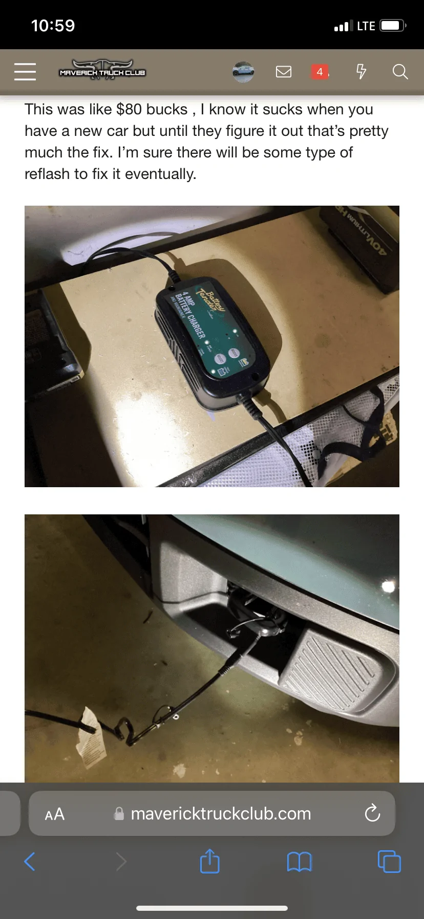

So my 2023 XLT Hybrid has a battery drain issue. In only 7 weeks of ownership / 2,000 miles I've had numerous "deep sleep" notifications and 2 completely dead batteries which required a jump (I used my NOCO GB40 - but have since upgraded to the Hulkman 8.5) to get started. My truck is currently AT the dealership for the 2nd time because the technician wanted to replace the Battery Control Module (I might have that term slightly wrong) because after they dropped in a new 12V last week, the problem still kept persisting and I was forced to bring my truck back to the service department.
Here are my ideas for 'solutions' to the parasitic drain, assuming the dealership is unable to 100% resolve the issue. I don't want to be negative, but it really appears that for MOST of the reports on here, despite numerous interventions by Ford, the issue is never quite resolved. Thus, I want to be proactive and perhaps mitigate the issue as best I can. The alternative is worse for me....getting rid of the Maverick and paying more / dealing with locating a new vehicle. I waited 17 months for this truck and I still LOVE it.
I'd love input or ideas, many of these quasi-solutions come from interactions and/or posts from members of this forum:
1) Upgrade my 12V battery by installing a 'beefier' alternative to the factory Motorcraft - that will still fit the under-seat dimensions
  • Duralast Gold Battery T4-DLG Group Size 99 470 CCA ($220)
2) Purchase a Direct Mount battery maintainer to leave under the hood
  • Noco Genius2D ($40)
3) Get myself a traditional, plug-in battery maintainer for parking in front of my house
  • Noco Genius 5 ($70)
4) Buy a 12V Solar Trickle/Maintainer for any camping trips or long weekends out in nature
  • Eco-Worthy 10W Solar Panel ($40)
5) Continue to carry with my Hulkman 2000A Battery Jumper as back-up
  • Hulkman 8.5 2000A boost pack ($125)

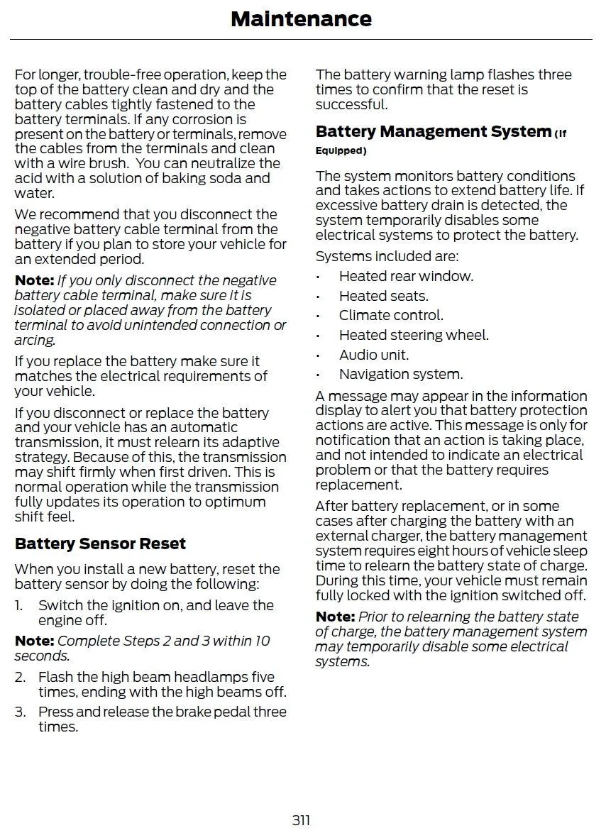

  1. Did a BMS reset (high beams + brakes) after getting a new 12V battery from Ford

Howdy, the Duralast battery or the Diehard flavor I installed in my 'Hybrid Battery Replacement" thread are not really 'beefier', they are same physical size, same vent, and same specs as the OEM Motorcraft battery, and they are all T4 batteries.
I've had a number of Motorcraft batteries in the last few years that failed very early and I question whether the replacement your dealer used was any better, or whether they charged it prior to installation. That's why I chose a Diehard with a fresh build date in order to rule 'Motorcraft battery' out of my equation. And mine has been problem free for ~7 weeks now after going into Deep Sleep every ~3 days for 6-7 months and me charging the battery each time.
Your problem may be different from mine, although I experienced ~2 dozen Deep Sleep issues with no interior lights, etc. and charged overnight each time, my truck never failed to start.
I'd also be curious of the manufacture date on your 'new' replacement battery..
Good luck!!

🤓 I would suggest dividing the problem in half. Is it a charging issue as mentioned in another thread or is it a drain issue. A continuous aux battery power monitor could be used or just create a 12v socket if one not available and just watch it with a plug in display. I am a new Maverick owner. About 1K miles no problems yet.
