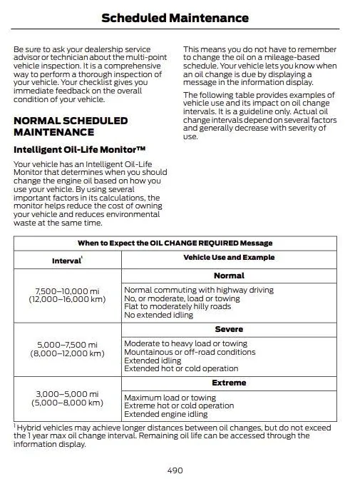

No on the exact breakin period but from what I've read it is the first 500 miles now with new cars/trucks. Just drive the truck normally and no towing during that period. As far as the direct injection this should do the trick for cleaning them without disassembly.
II Kings 9:20
Dec 2, 2021
56
Buckeye Nation
Accord, X5, Genesis AWD, Pacifica, MDX hybrid
BREAKING-IN
Your vehicle requires a break-in period. For the first 1,000 mi (1,600 km), avoid driving at high speeds, heavy braking, aggressive shifting or using your vehicle to tow. During
this time, your vehicle may exhibit some unusual driving characteristics.
That's generally the rule of thumb for most cars. Sounds good for the Mav.

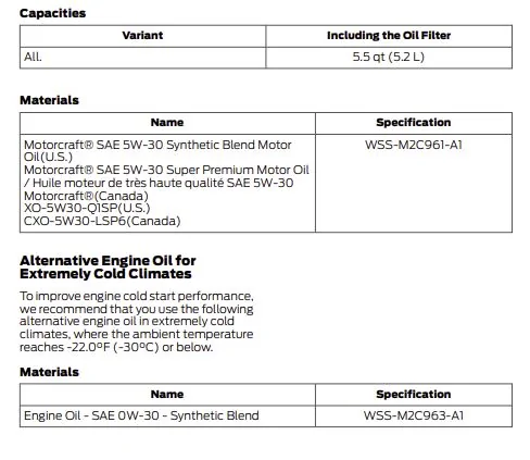

So I did some researching on what oil to use and my conclusion is unless it is a climate issue is stick with a 5W-30 oil. Specifically the Walmart full synthetic Super Tech oil.
That is the short answer.
Long answer after brain cell loss and bruises on my head after banging it against the wall along with glazed eyes researching oil standards this is why.
First since this is my first rodeo with Direct Injection engines I did some research on them and came across this video.
The main suggestions that they recommend for those that don't have a long attention span and seat restraints for oil issues is add an oil catch can, use fuel injector cleaner more often and use oil that has a NOACK evaporation level of 7 or less.
After trying to research that and almost killing myself trying to sort through the BS I'll cut to the chase and hopefully save another life or 2 and say anything 5W - 30 should meet that threshold if it is full synthetic. I don't think it is overly important since build up or not cleaning sludge buildup more regularly is the simpler solution instead of hang wringing over NOACK evaporation ratings.
So now to what Ford recommends.
The book says 5w-30 blended synthetic part# X0-5W30-Q1SP
So my next question was is Motorcraft oil any better than Walmart's Super Tech.
Looking here.
https://www.motorcraft.com/us/en_us...oil/sae-5w-30-synthetic-blend-motor-oils.html
They go on about a Ford motor spec WSS-M2C946-B1
So what does that relate to other motor specs or Ford so I found this.
https://www.oilspecifications.org/ford.php
It lists every spec except for this. So let's go to the MSDS
https://www.motorcraft.com/content/...l/Product-Data-Sheet-5W30-Synthetic-Blend.pdf
Okay now we are getting somewhere
API Service GF5 / SN
That also applies to their full synthetic 5W-30 oils
So what does that mean?
http://www.pqiamerica.com/apiserviceclass.htm
Their service number is not current since they list SN-Plus which took effect 2017. More than that Direct Injection engines are more susceptible to what is called pre ignition. SN-Plus is supposed to be formulated with that in mind so you'd think Ford and in turn Motorcraft would be formulating and recommending engine oil that is to that spec especially for a newer vehicle like anything made after 2017 that has a DI engine like the Maverick.
So lets look at the GF rating.
https://www.api.org/products-and-se...categories-and-classifications/oil-categories
GF5 was obsolete after May 21. Oil is probably fine for the Maverick and still acceptable for older vehicles but the fact of the matter is either they haven't updated their MSDS sheets or Ford is recommending oil that is and was considered obsolete for a vehicle that they didn't start producing until after May of 2021.
Will this cause the engine to blow up, probably not and will Motorcraft reformulate their oils to the newer specs., most definitely it is only question of when not if unless they already did and haven't updated their data sheets.
So lets go to something cheaper and more widely available. Walmart's Super Tech full synthetic oil.
The API Service is GF6A / SP
They are up to date unlike Motorcraft and cheaper.
So what about SP rating
https://kendallmotoroil.com/news/your-quick-guide-to-the-ilsac-gf-6-and-api-sp-motor-oil-standards/
Key statement
" API SP will be fully backward-compatible with previous API service categories, including API SN PLUS, SN, SM, SL or SJ."
That means it should be good for a Direct Injection engine unlike Motorcraft oil that is recommended in the book.
And for some background on Super Tech oil.
https://mechanicbase.com/reviews/supertech-engine-oil-review/
If Warren Oil makes it to industry standards, unless those standards are no good the oil should be fine for a Maverick.

Nice breakdown. As long as the oil used meets or exceeds the "ford standard" it should be fine, as far as overall performance. I know that for the hybrid it says I need to be using the WSS-M2C962-A1 which corresponds to https://www.fcsdchemicalsandlubricants.com/Products/Details?cid=70&pid=474 (happens to fall into the GF-6 and API SP/SN+ categories. We have to remember that some of these specs have nothing to do with physical performance of the lubricant, but which types of seal materials or other components with which the oil may come into contact with. Just like ZDDP or sulfur phosphorus additives that help with pressure and wear, these additives can become aggressive towards specific materials in the right conditions (anyone that has had to rebuild a worm drive and found that the bronze gear looks like it was eaten by something, that was the extreme pressure additives eating the gear).
So yes, use whatever oil you want, just make sure that it meets the applicable standard for your vehicle.
