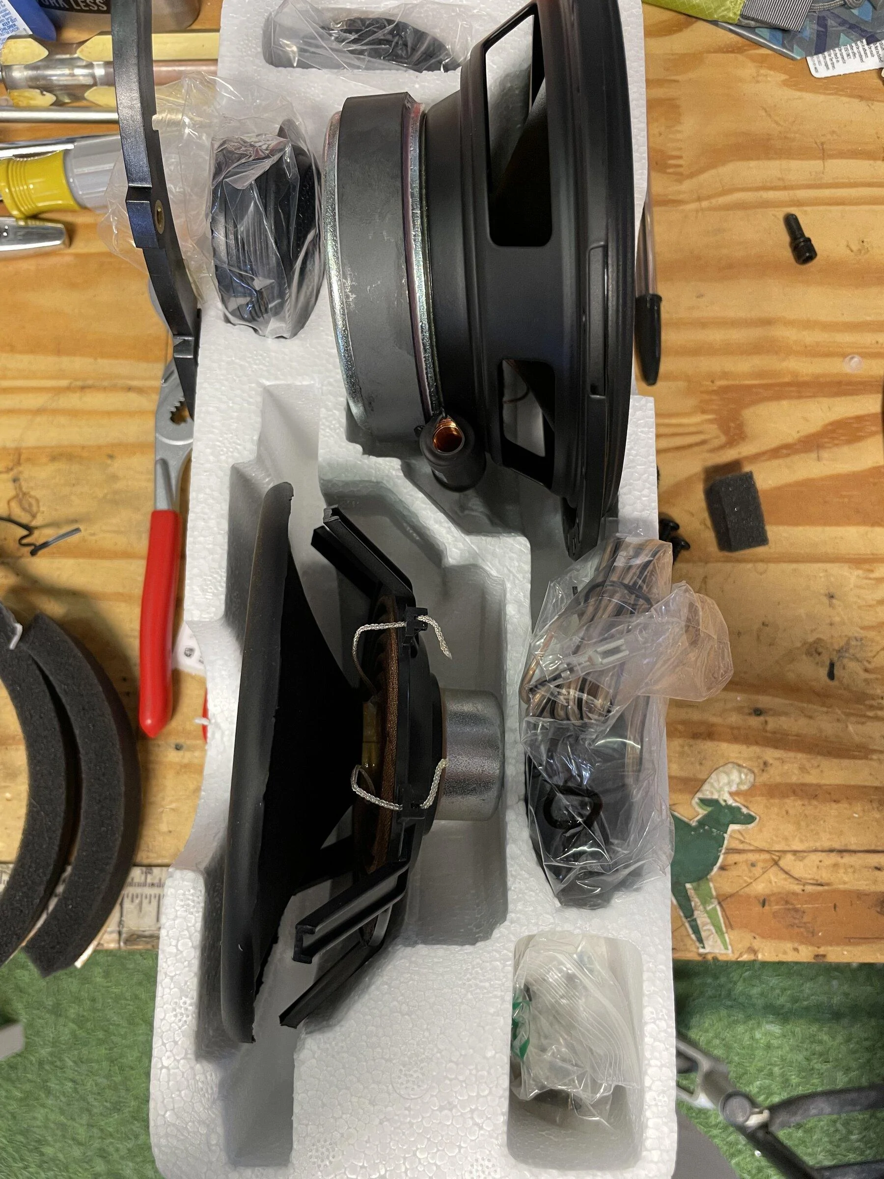

Does anyone know what's the max mounting depth with spacer without hitting the door panel?

I just installed Focal RSE-165s (components) w/ 2.5” depth in the doors and didn’t have clearance issues. Haven’t gotten everything finished yet but will update when I do!

Did you install the tweeters in the dash, sailpanel, other? Seems the tweeter mounting can be as challenging as dealing with woofer depth. Thanks!

Tweeters are “installed”, idk how well they’ll hold up but we’ll see. They’re more press fit than secured in there.

Thanks. At least they fit (unlike the Morels). I would rather deal with adding material for a press-fit than attempt to shoehorn an oversized tweeter. Let us know you're impressions regarding the sound when you've got everything dialed in.

forgot to share: I stole the idea from a member here. I simply cut the stock speaker surround and basket with a razor knife(soft plastic) to harvest the mount. I am cheap and it fits perfectly. Even retained the stock plug by unsoldering the speaker. The Alpine S65c cleared everything with a woofer mounting depth of 2-5/16. Alpine 6.5 component

Not completely finished but it’s sounding great. I’m really impressed with the sound for the price. I snagged those Focal RSE165s on sale and open box for $121 off crutchfield.
. I didn’t think I’d want to add a sub but it needs to happen eventually. This was my first audio install, if anyone has any questions let me know!
