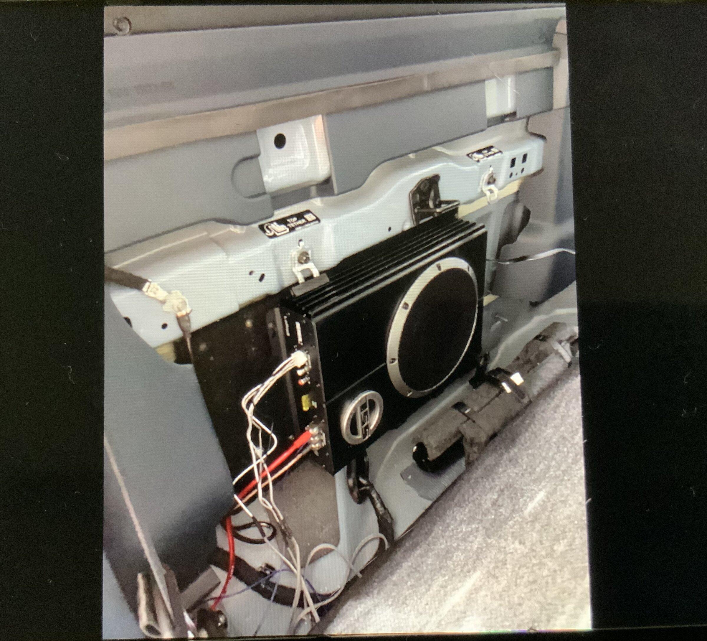

Following....Nice, now I have a basis on work off of when I get my Mav, quick question to anyone that can answer. I’m a big fan of bass so any recommendations or will this set up work well?

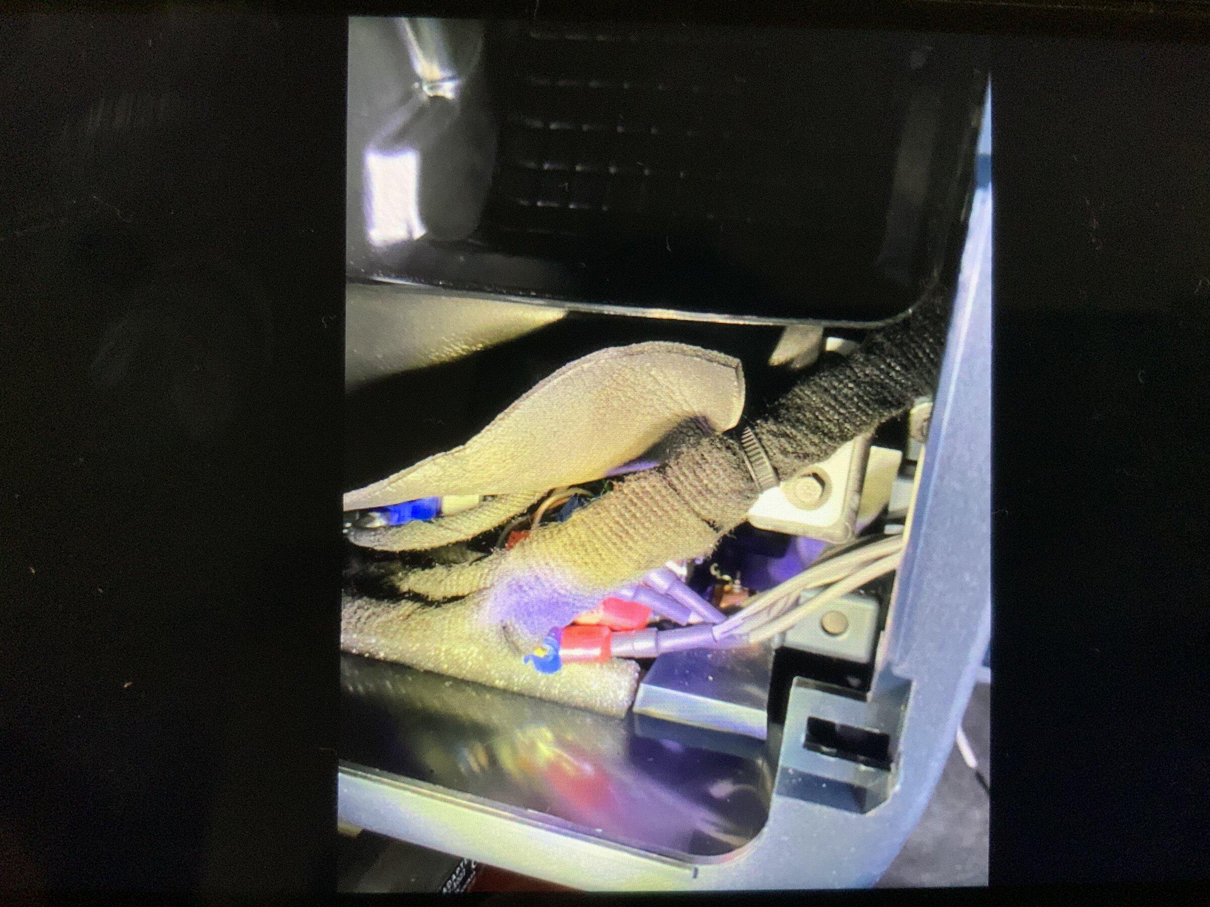

The bottom console with the climate controls is the only piece you need to remove to access the stock radio and tap the wires to feed the Kicker Key and sub, it's help only by clamps and you can just pull towards you, super easy to remove.
I marked up the harness that feeds the speakers, there's also I nice 12+ and ground, in case you want to tap that and do an easy in-dash install for the Key it is doable. In the middle of the connector there's a green and yellow wires, those are the right passenger side, right below it it's the driver's front speakers. I did not do anything with the rear speakers, but they are on the sides of the driver's front speaker. I used a multimeter to check polarity.

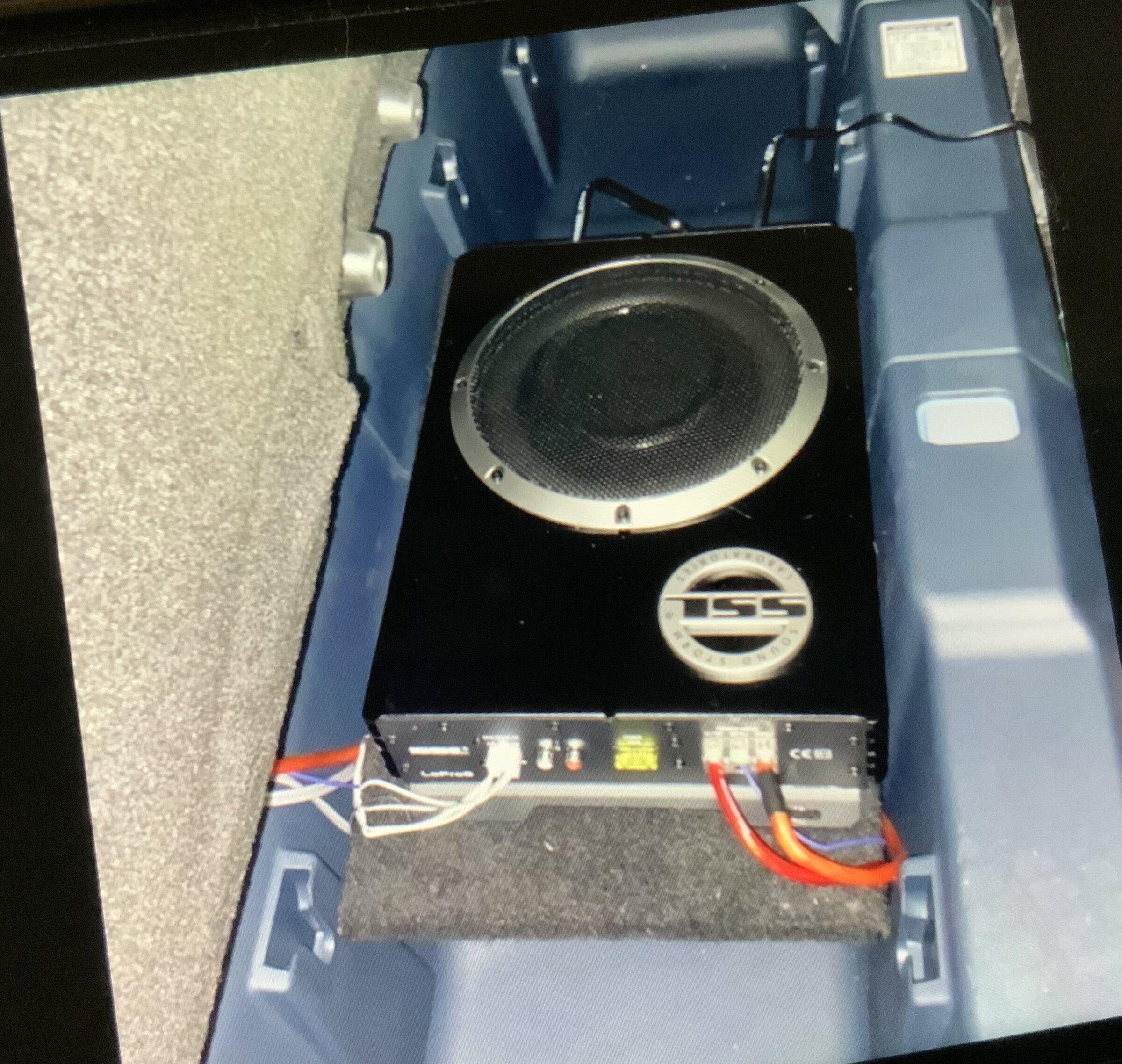

I’m curious how you went about mounting this under the seat…. I currently have my hideaway behind the seat (finalizing my mounting board, etc…) and have played with under the seat, but I don’t want to drill into the plasticHere is my setup I’m very happy and satisfied on how it sounds. first I attached it in the rear and it was ok but I decided to install underneath the storage and my goodness a big difference. My total cost was around 250 bucks jbl clubman 6520 and sl pro 8 600 watts. Still in the process of cleaning up the wires Just gotta take care of my cuts and bruises pulling wires. it’s sounds really nice believe me the location it’s nicely centered at the storage under the seats. As you can see I tried the rear but end up moving it underneath . Best location.
I put a wood and double side heavy duty Velcro and it’s been there doesn’t rattle or move.I’m curious how you went about mounting this under the seat…. I currently have my hideaway behind the seat (finalizing my mounting board, etc…) and have played with under the seat, but I don’t want to drill into the plastic
