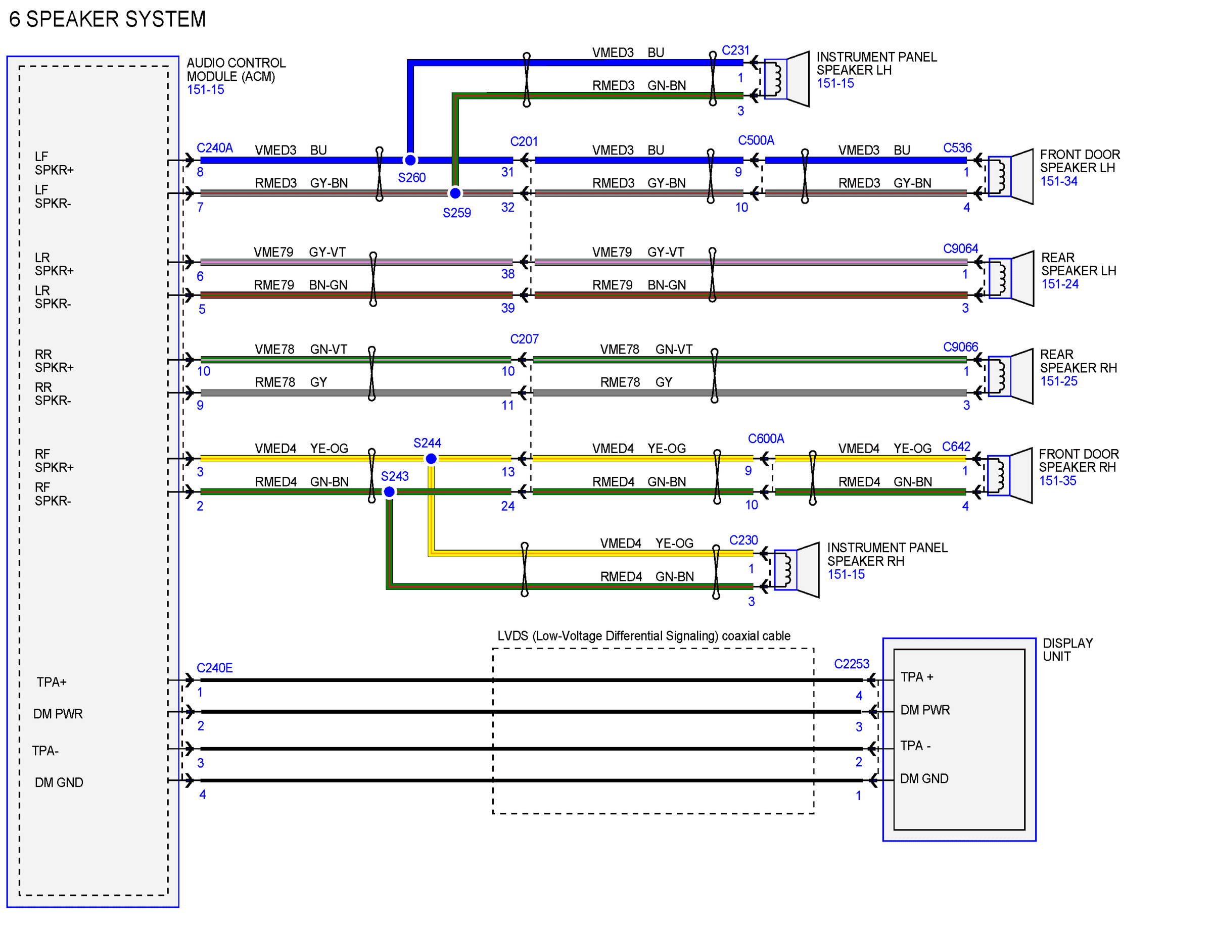

I know this is a very old thread, and there's a lot of useful information. Since it's a "sticky", I thought it should be known that OP appears to have the front speaker wires swapped +/- -- according to this diagram:
Ford Maverick Upgrading the XLT base audio system / door panel removal - finished with lots of pics. Wiri

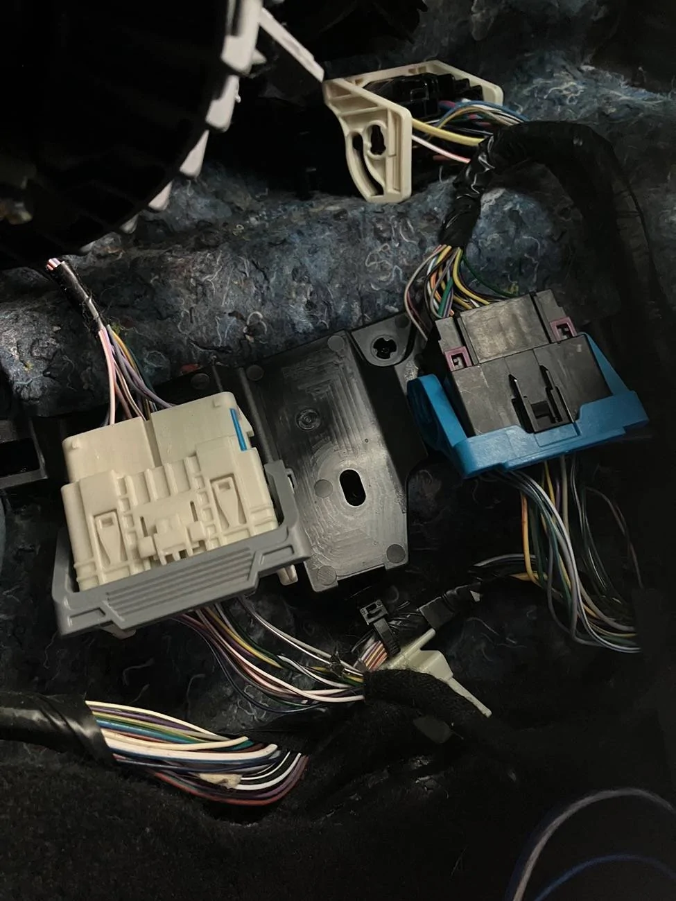

Can anyone tell me which (if any) of these wires behind the glove box, go to the passenger front door? I think I’m looking for Yellow-orange and Green-brown.

You can find the wires to tap behind the HVAC controls at the head unit connector. For the front passenger door you're looking for the blue wire for positive and gray /brown for negative.
I'm pretty sure the XL and XLT do not have the sub connector or wiring, that the lariat with the b&o would have.
