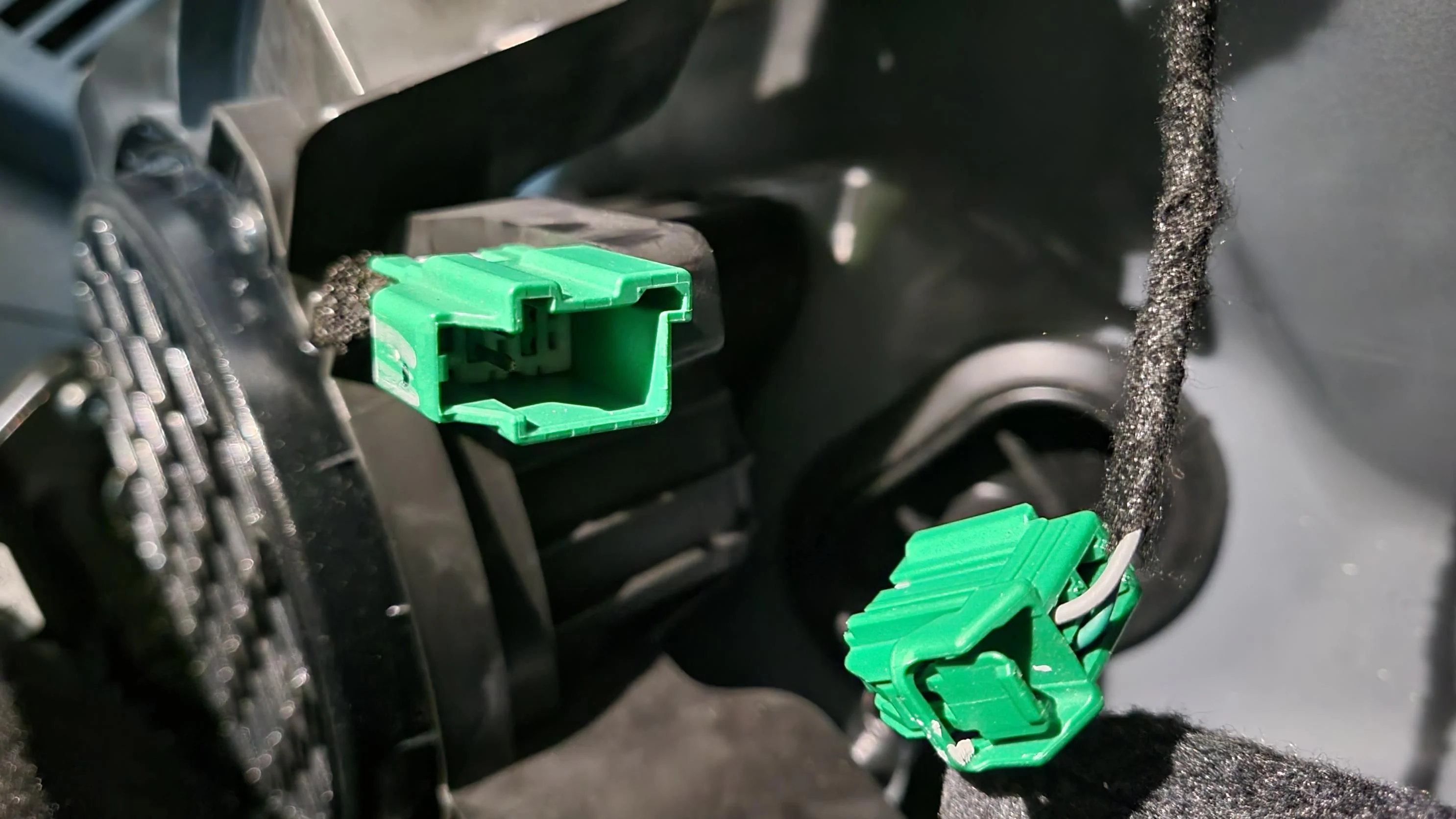

Anybody know which and where I can find the correct speaker harness for the woofer on the B&O system?
I believe they're Motorcraft WPT-1456 and WPT-1016 pigtails depending on which side you need.
I'll be needing the WPT-1456! Thanks a lot for the help. Now I need to decide whether I want to spend 30 bucks on it or just cut/splice the one from the OEM woofer.
