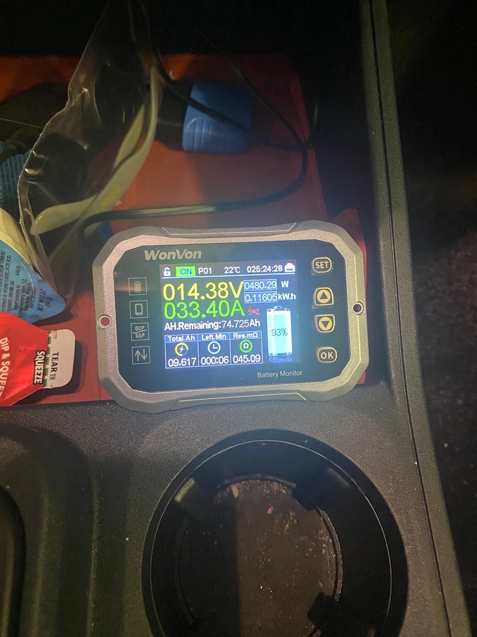

Mine does not have a problem charging.

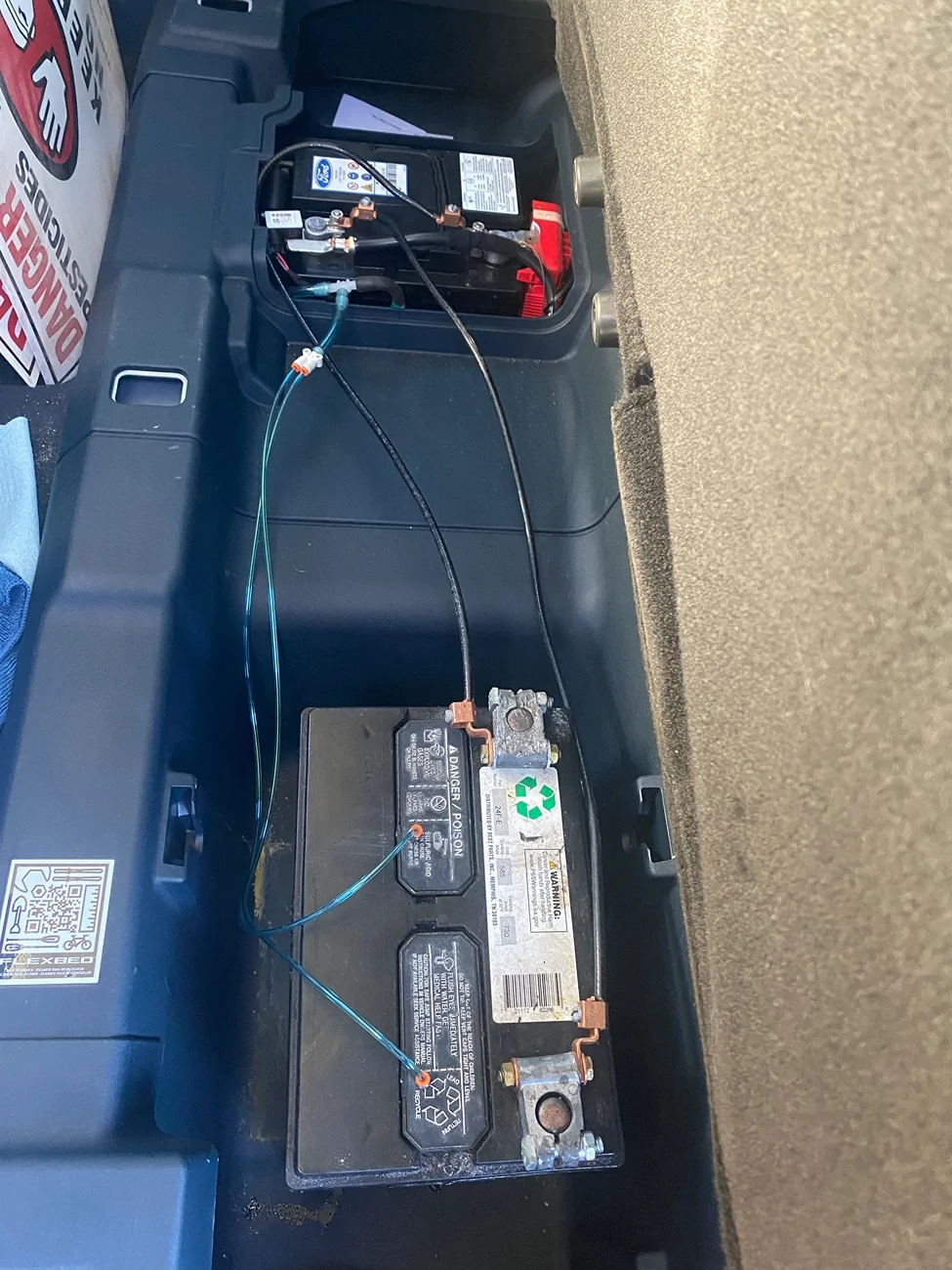

And this is what it looks like for having two batteries under the back seat.
Normally the voltage is as high 15 volts.
That picture was taken in the summer, and right after I turned on the truck.
.i would rather have a working truck than have the little extra space.
There's nothing holding the battery in place, and the gases from charging are likely never going to make it through that circuitous tubing managery.
Also. Just because the voltage is showing 15 volts doesn't mean a whole lot. It is the amps of current flowing to the battery that is the issue. As others have said it very quickly drops to around 1 amp. Certainly way less than needed to recharge the battery on shorter trips. Shorter trips is what a hybrid was designed for, because of the MPGs in city driving.
If you do not have the battery bolted down, then the installation was not done correctly. And the foot of straight tubing right off the top of the battery is not "circuitous". Get a real mechanic to fix the mess that you have.
You measure the voltage of the battery after the surface charge has bled off, typically 8hrs after you turned the vehicle off. Any reading with a surface charge will be extraordinarily high, like the 15.0V that you claim. A fully charged lead-acid battery is unable to be over 12.7V, be in FL, EFL, AGM or Gel-cell.
I agree with your comments about the ridiculously low charging current though. It like the BMS is going into trickle-charging an hour before it should, and the trickle-charge current is also half of what is reasonable. Its broken.
I am not sure why you are replying to me as I am not the one with the mickey mouse setup with an unsecured second car battery under the back seat.
