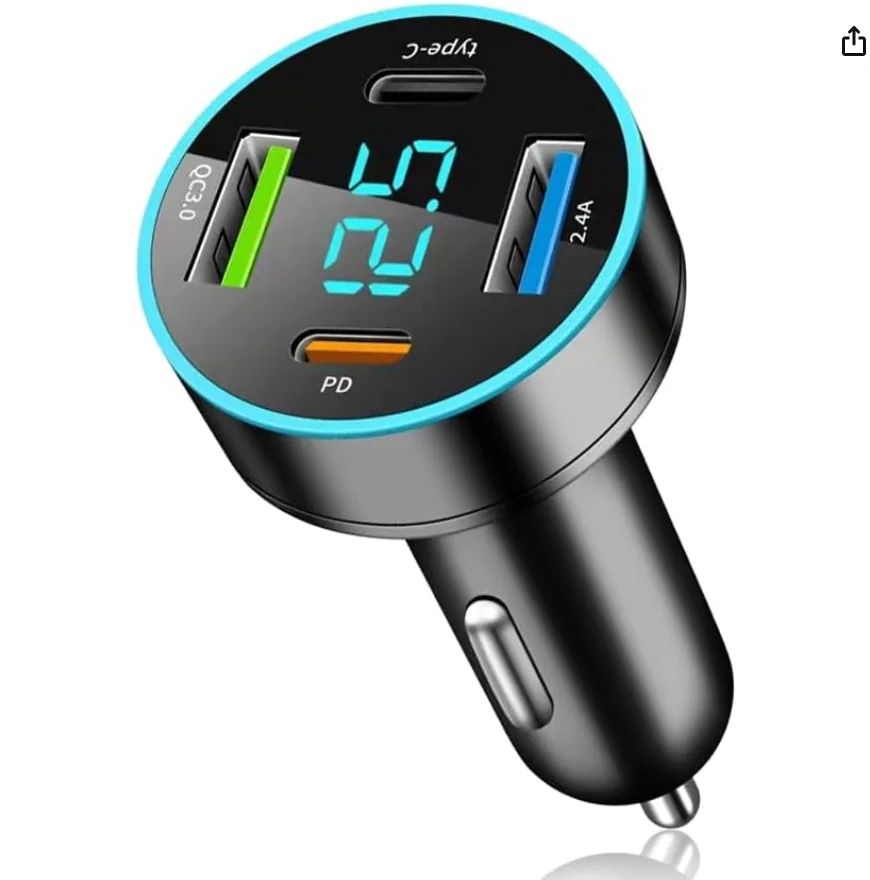

Mine does not have a problem charging.
And this is what it looks like for having two batteries under the back seat.
Normally the voltage is as high 15 volts.
That picture was taken in the summer, and right after I turned on the truck.
.i would rather have a working truck than have the little extra space.
