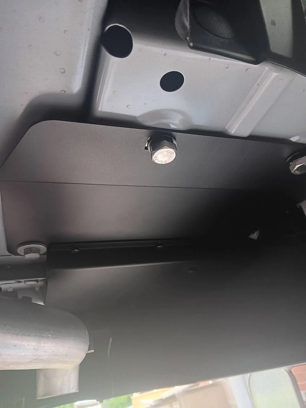

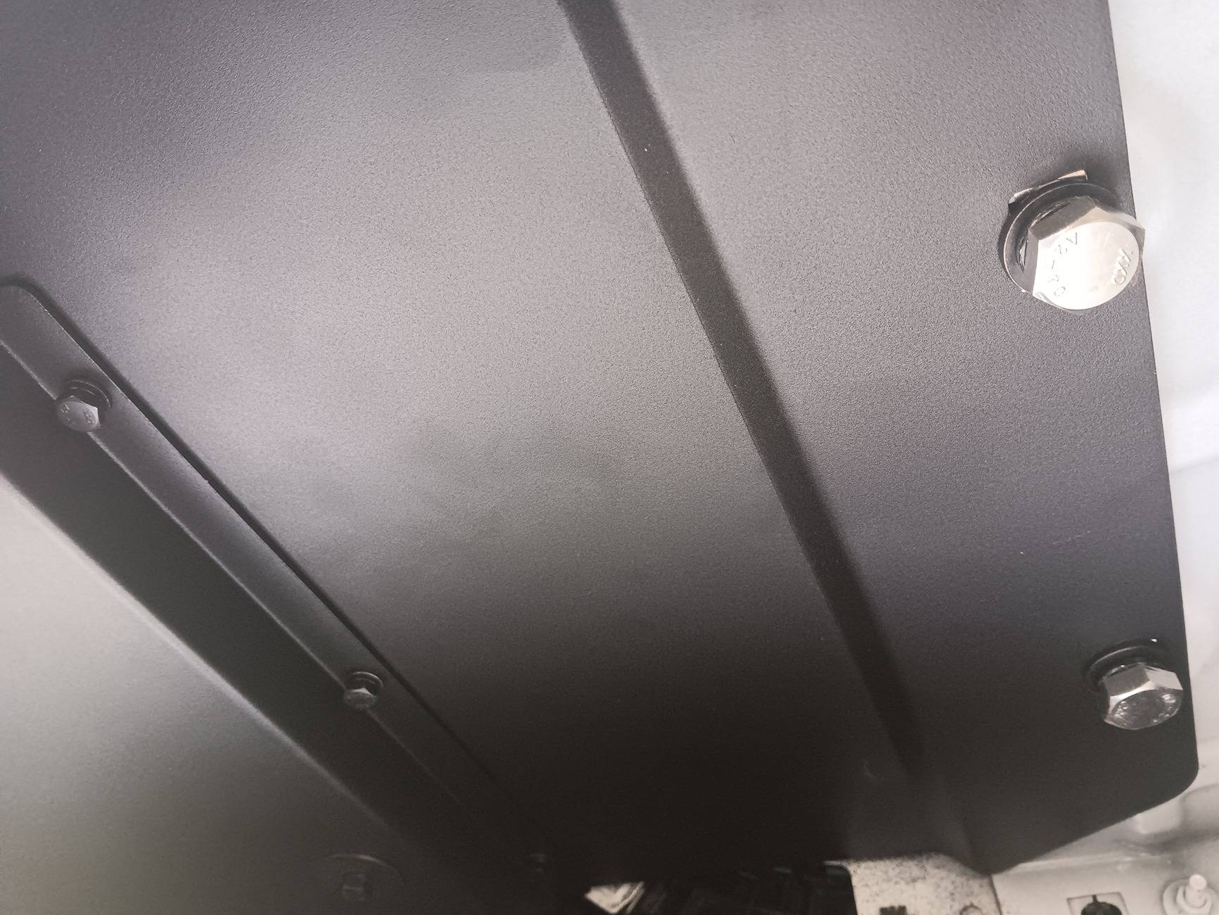

I also got mine installed today and I agree, figuring out the L brackets was a pain... it took me a few attempts for the little one. Fred's Garage has a good YouTube video that helped me significantly. The install was a pain but that's not a knock on the product, that's the joy of working on your back. It's shocking that Ford left this area open but @MABETT to the rescue. I was impressed with the packaging, the fit, finish and quality of the product. I also agree with @Backin15 having a ratchet is recommended, almost a necessity. The tools provided could possibly work, better then your hands. While it's nice that they're included, I personally wouldn't attempt this project without a ratchet. I didn't need a breaker bar, just a lot of strength on the two large frame bolts. I'd recommend this product to fill in the big hole ford missed! Sorry for the crappy pictures, the ground got in my way.
Ford Maverick Underbody Cavity Shield Cover: Essential Protection for Your Maverick 20250613_132039
Ford Maverick Underbody Cavity Shield Cover: Essential Protection for Your Maverick 20250613_132501
