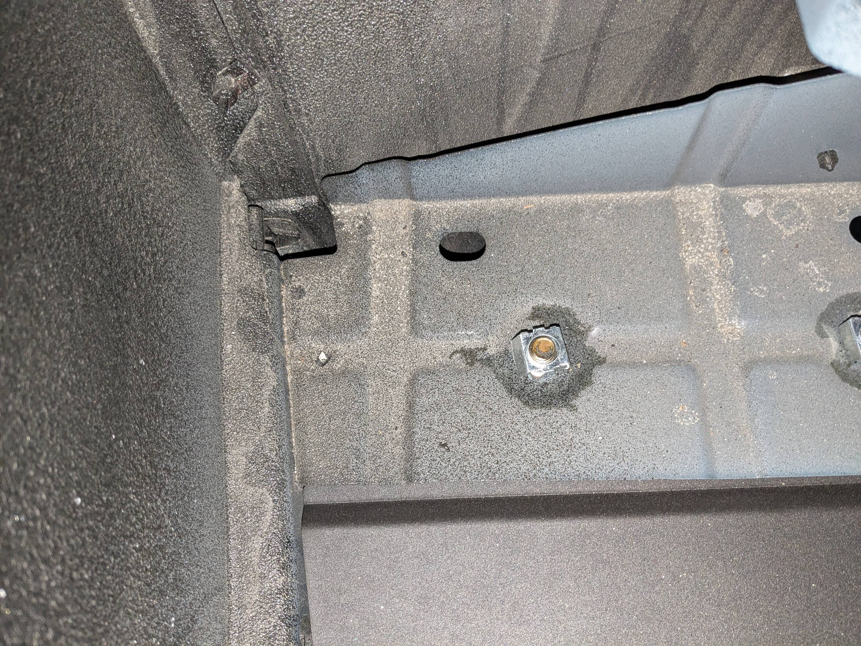

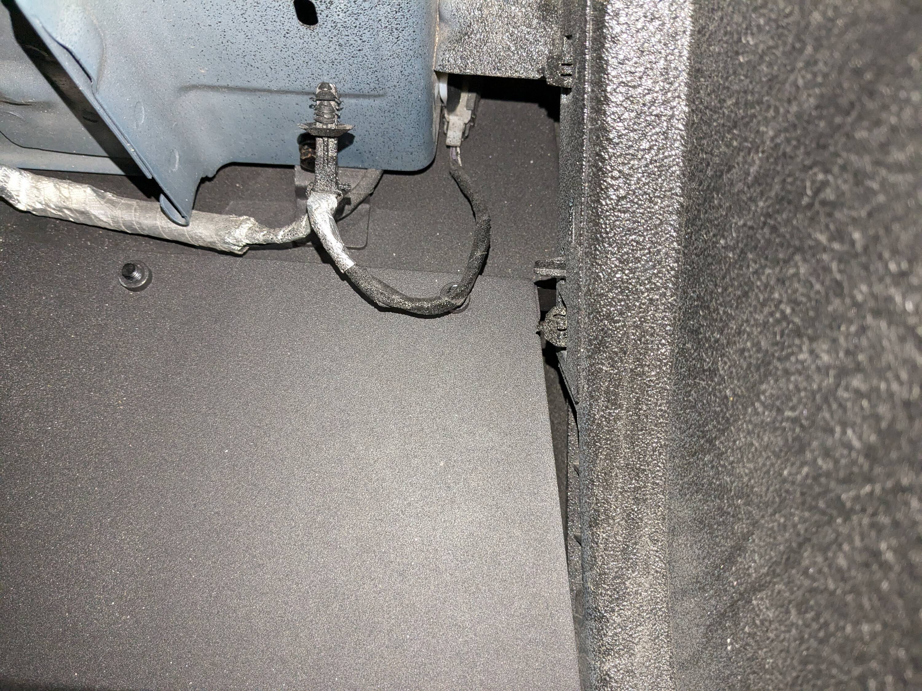

I finally pulled out the bed cubby to take a look on the top side of this install. everything looks fine. a couple of notes:
it doesn't look like the wires that I assume are for the rear brake lights are pinched between the shield and the body. in the image below it looks like maybe one is but I was able to freely move the part of the wire that looks like it's between the body and the plate.
another thing to note is that the top of the shield looks clean relative to the structure that was there before so it seems like its doing its job.
one more thing regarding the folks who want to put foam in there to "seal it up". I'm not so sure that's a good idea because while I was doing this I noticed that the area around the brake light will def allow moisture from the outside in (it's a pretty sizable gap) and possibly to the tops of these shields and it might be better to allow that moisture to drain out instead of getting trapped. unclear if this could happen though.

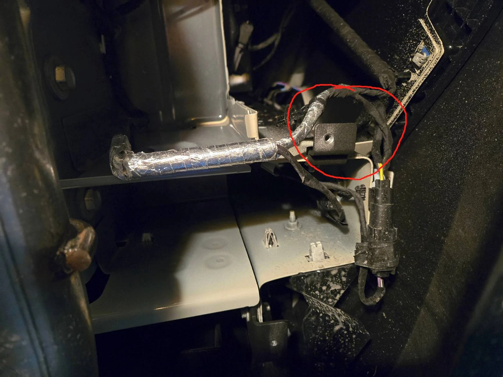

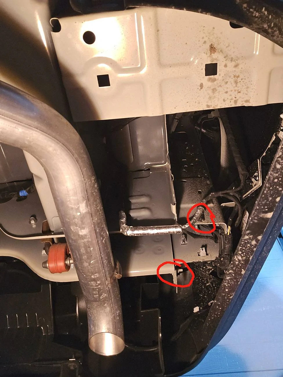

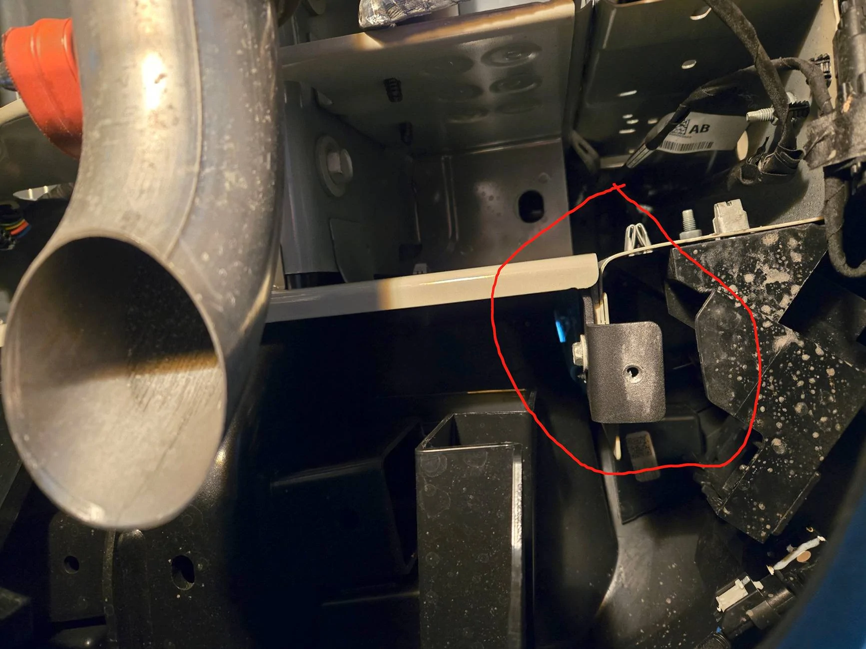

I installed the Mabett Underbody Cavity Shield Cover in my 2025 today. Very easy to do, and a very high quality kit!. Here is the area prior to installation. The wire support needs to be popped out and the 10mm bolt removed from the areas circled in red.

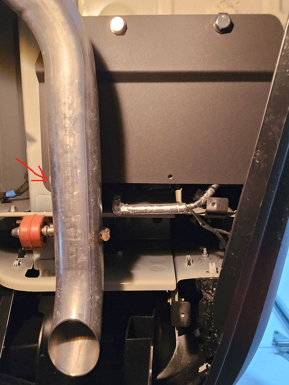

Two 18mm bolts need to be removed that are behind the tailpipe in this photo. They are tight and I used a break bar to loosen them. The first plate uses one of these 18mm bolts (red arrow) and two 19mm bolts that are supplied. The nuts for the 19mm bolts are also supplied. They are in holders that snap into the square holes visible in my first photo. Sorry I didn't take a photo of them, but others in this thread have. Again, I put anti-seize in all nuts / nut plates.

The second plate attaches with 5 supplied 10mm bolts, and the second 18mm bolt behind the tailpipe that was previously removed. This plate "steps down" to allow space for the wires. While it is firmly against the wires, I have no concern. It's not moving, they're not moving. Nothing will rub. They will be protected and kept dry.

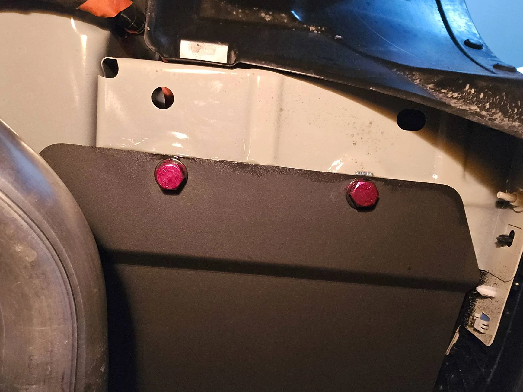

The last thing I did was to use clear silicone caulk on the front edge of the front plate. I don't like the idea of the rear tire spraying water into that gap and water running on top of the plate. I got out my can of black rustoleum to slop some paint on the two 19mm bolt heads to protect them, but alas my paint had dried out. I keep a couple bottles of cheap nail polish in the shop to mark bolts that have been torqued, the direction of something for reassembly, etc. I grabbed a bottle and slopped some on for some rust protection. Would have preferred black, but who will ever see it. LOL.

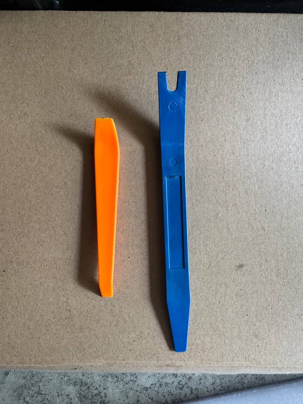

My only complaint was the orange trim piece they shipped me. Shouldn't it have a notch in it like my blue trim tool so I can slip it behind that plastic wire holder?

The notch would help, I actually didn't even use the tool, a little wiggling and it popped out.

I don't think I used their tool either. Probably a needle nose pliers.
