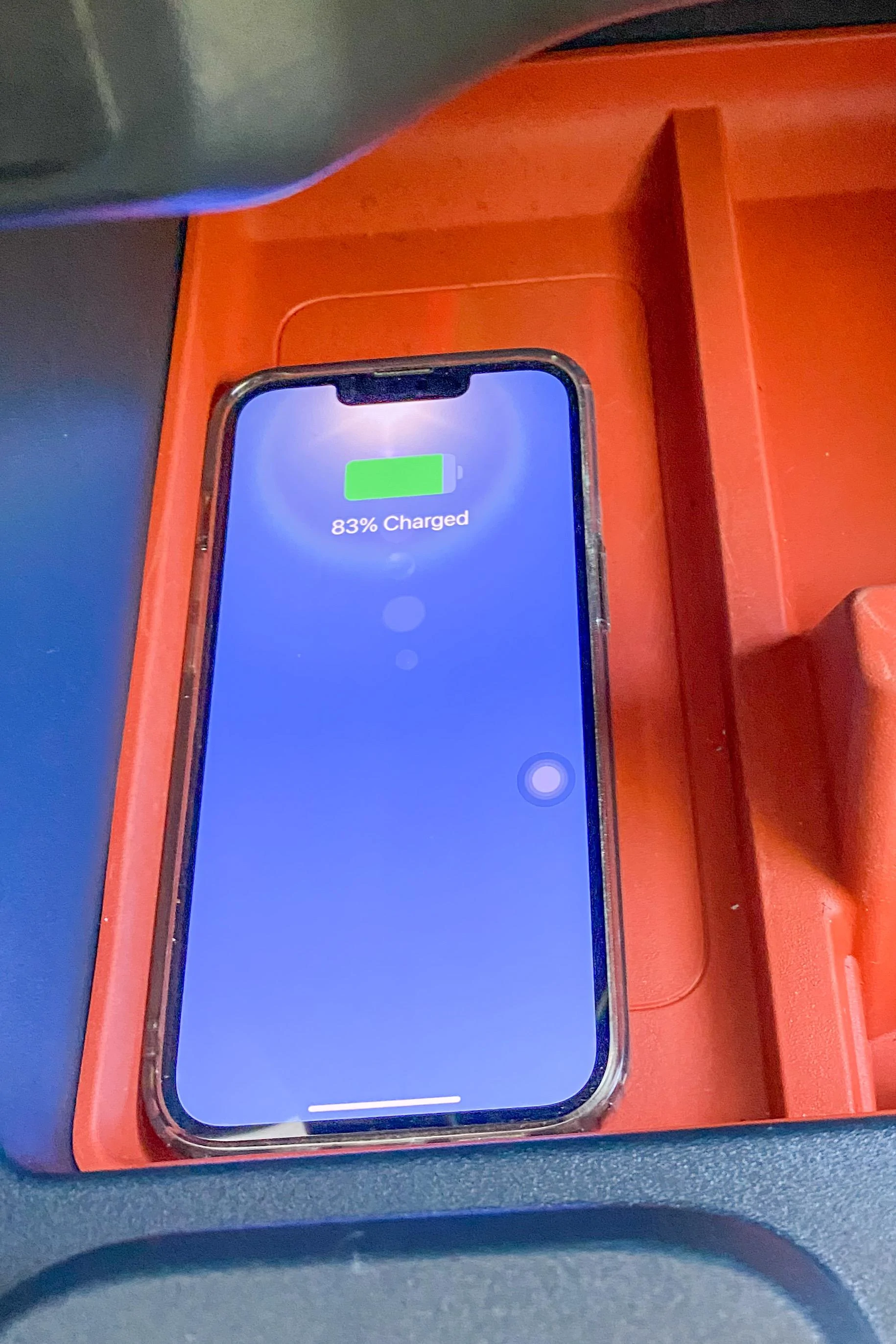

I got the parts. Can’t seem to get it to work yet. I think I need the usb-c to usb-c cord and not usb to usb-c. There seems to be a different power rating on the power port. Oh well.

I especially appreciate the info about Fuse #3 and the details on how to easily tap in. If/when my Maverick arrives, I want to add a USB port for my dash cam that will switch on and off with the ignition.

I see the pad is for an IPHONE.. Would it work for Android..

Did you do anything different? I have success in testing the charger, but when test fitting, it doesn't work.
I positioned the phone where I wanted it and while I had the sides off the console and before I stuck the adhesive down, I found the best location for the charger.
if you notice I positioned the phone all the way down and to the left to make it easier to get the phone in the right spot each time. It works great.
Thanks, I'll give that a shot.
