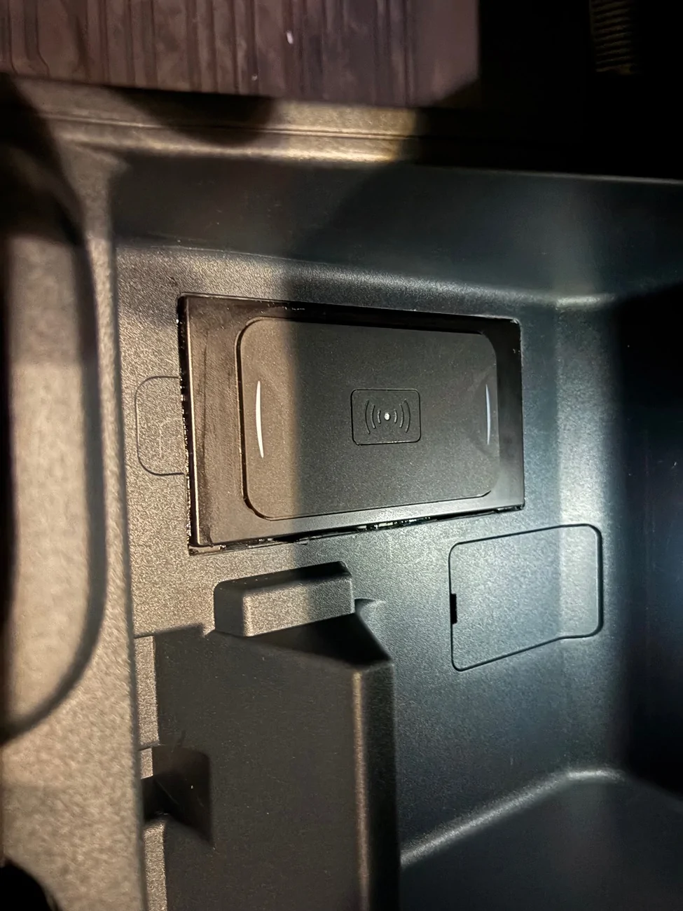

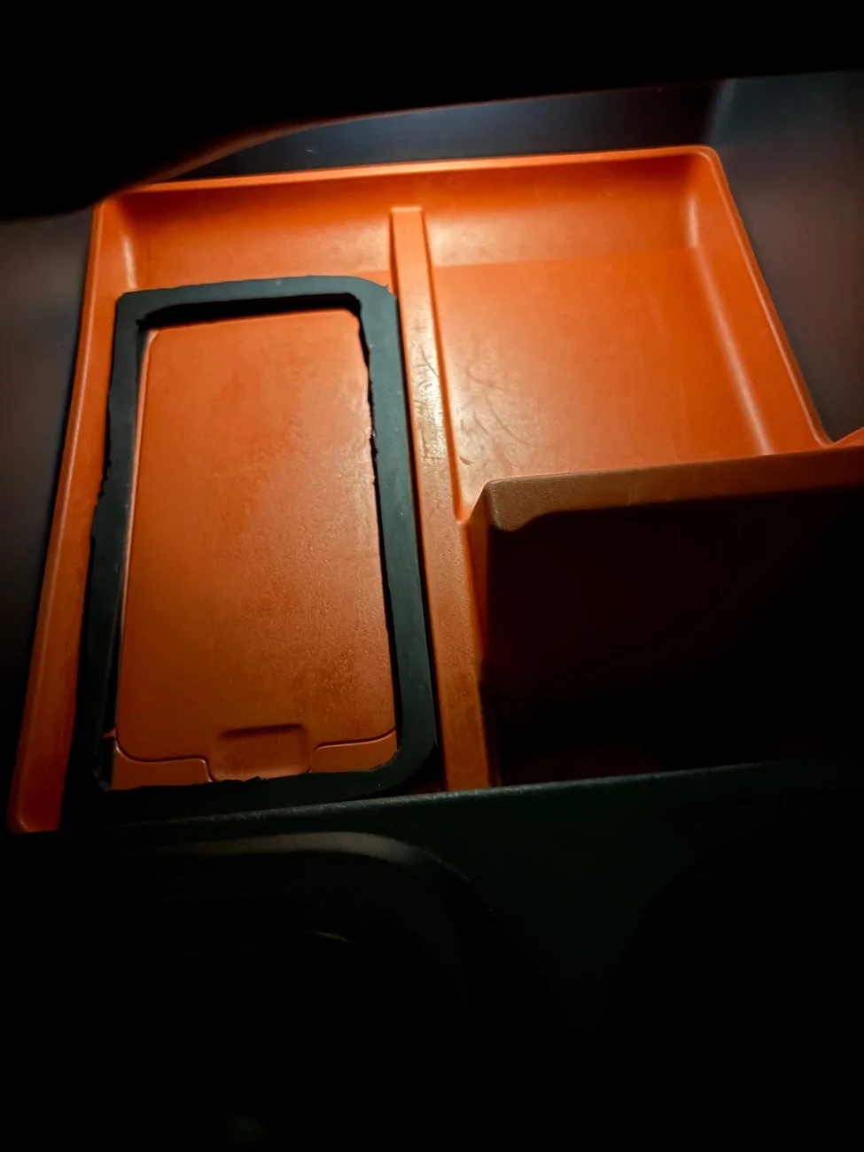

So I got the Bronco charger on Amazon and installed it. It was actually very easy. I used a straight edge razor and cut out the floor of the console using the outline already there from Ford. Then glued it in place like you did. The Bronco pigtail harness supplied with the charger fit perfectly on the USB connector. The power wire and ground going to the charger did need to be extended by
about 12 inches. I decided to leave the orange tray liner in place without cutting an opening in it, but found if I did then I could not use my phone cover. No problem. I don’t really like them anyway. I did use the neoprene like holder supplied with the kit. I just cut it to fit and attached with 3M tape. I may be changing it in the future if charging results
Are not as expected.

I'm thinking about sealing up the gaps on the cut lines with some black silicone sealant calk. Not really necessary if using the orange tray liner, but it'll nag me because it doesn't look as finished as I would like.
