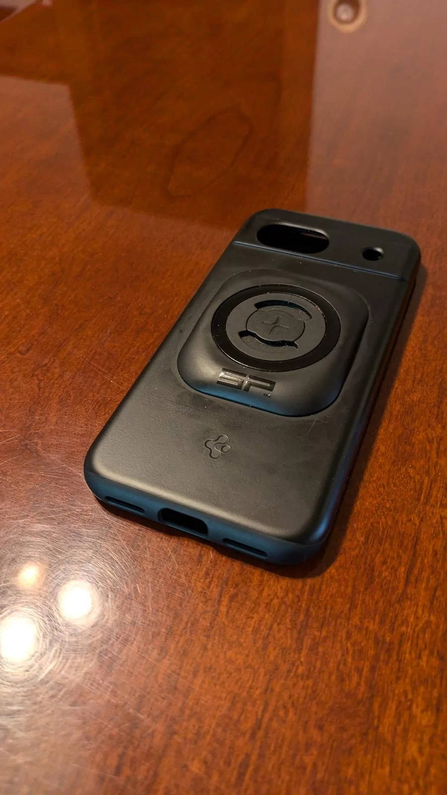

I use an "SP Connect" mount/phone case, which raises much of the phone slightly off the charger, but it still seems to charge ok? It does get warm(hot?) but it's hard to quantify if it's too hot?
It does have a metal ring that matches up with SP Connect's wireless charger for motorcycles, so maybe that helps transfer energy here, too?
Only using the phone for navigation and not music, it does go postive in charge rather than negative over time. Very very slowly, though.
