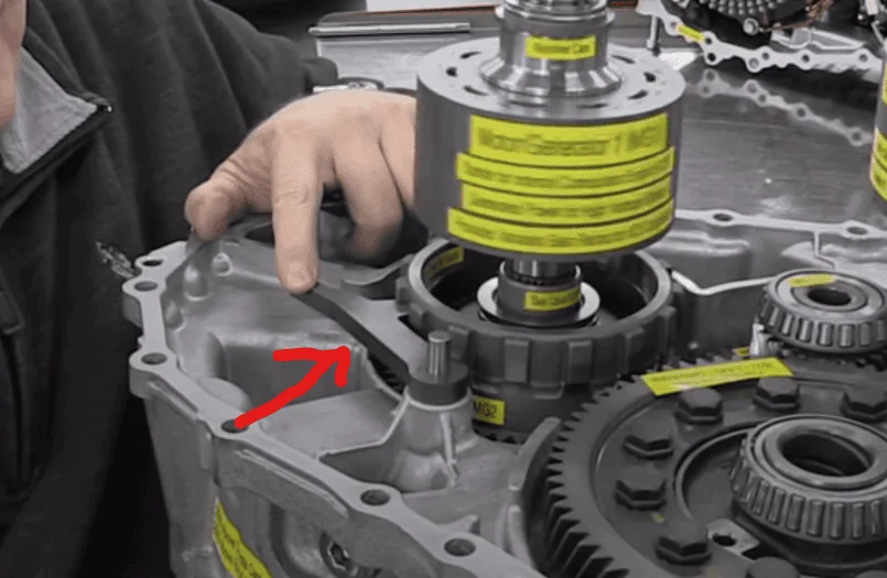

If I am not mistaken the Toyota eCVT's have a really robust pawl that locates on notches on the outer ring of the planetary gear set to be in "park", and stop the vehicle from moving. I was concerned about my Prius' movement on the drive when parking without the parking brake engaged, until I saw a picture of the pawl. The movement would be the pawl finding it's notch and settling in. Perhaps the Maverick's is the same design (most likely).
Hope the issue you experienced is a design feature as Nick suggested.
Yep Maverick has same design with the parking pawl on the outside of the planetary ring gear.
This is the Rav4 Hybrid but it may be helpful to provide a visual. Ford's HF35/45 does the same thing.
I'm guessing when you go into/out of park on an incline and hear a "GU-CHUNK", it's this metal pawl seating/unseating from a notch under the weight of the truck.
