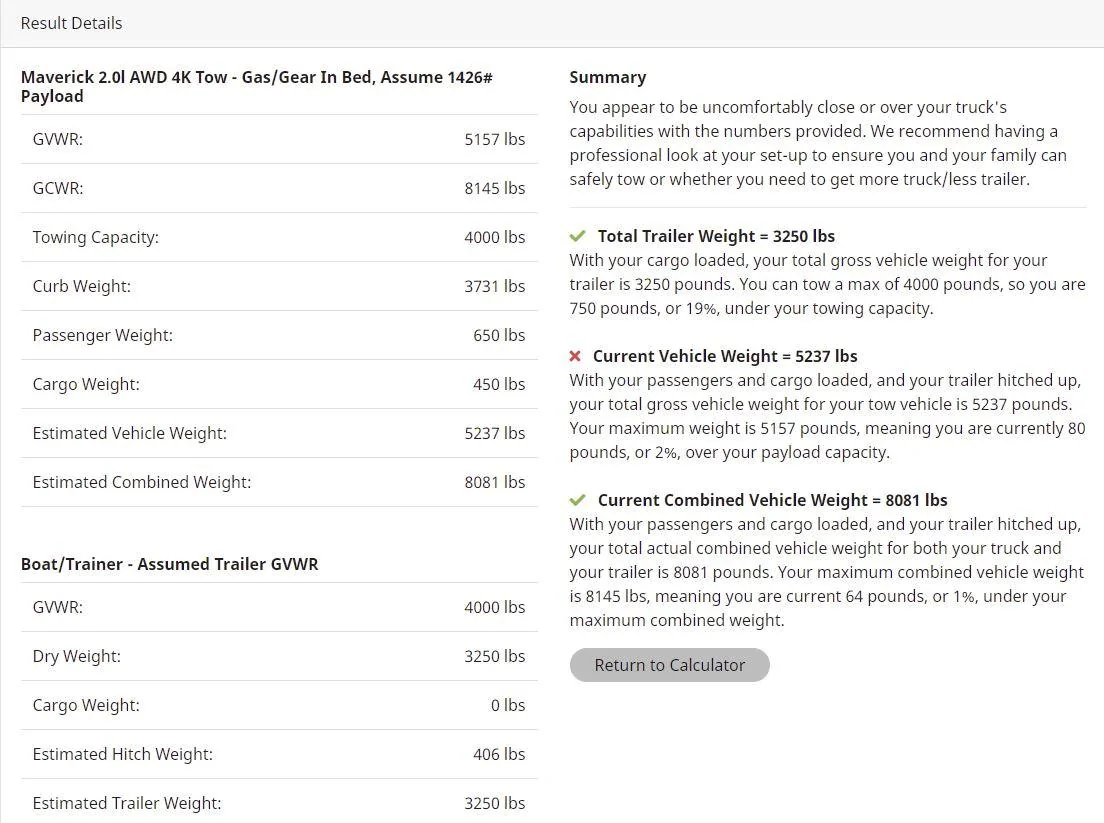

From a quick-and-dirty simple calc look, you "should" be OK using your numbers and a few assumptions (your gas & gear in truck bed, your actual doorjamb payload capacity same as a Hybrid example we've seen - 1426# - your AWD may be a little more or less, etc). A little over on payload but the calculator assumes 12.5% tongue weight, your boat/trailer may be like other stern-heavy boat arrangements so it may be 10% or less, and putting some of the gear/gas inside the boat could lessen the overall payload the truck sees also. I'm sure you'll run your calcs with actual values once you know them (maybe a trip to local CAT scales?), and do a test-drive pulling your boat to see how well it stops w/o pushing your truck past that stop sign. Main thing is, you have a "controlled" route, flat. I can't comment on boat ramp practicalities (not a boat owner), that's your judgement call.
