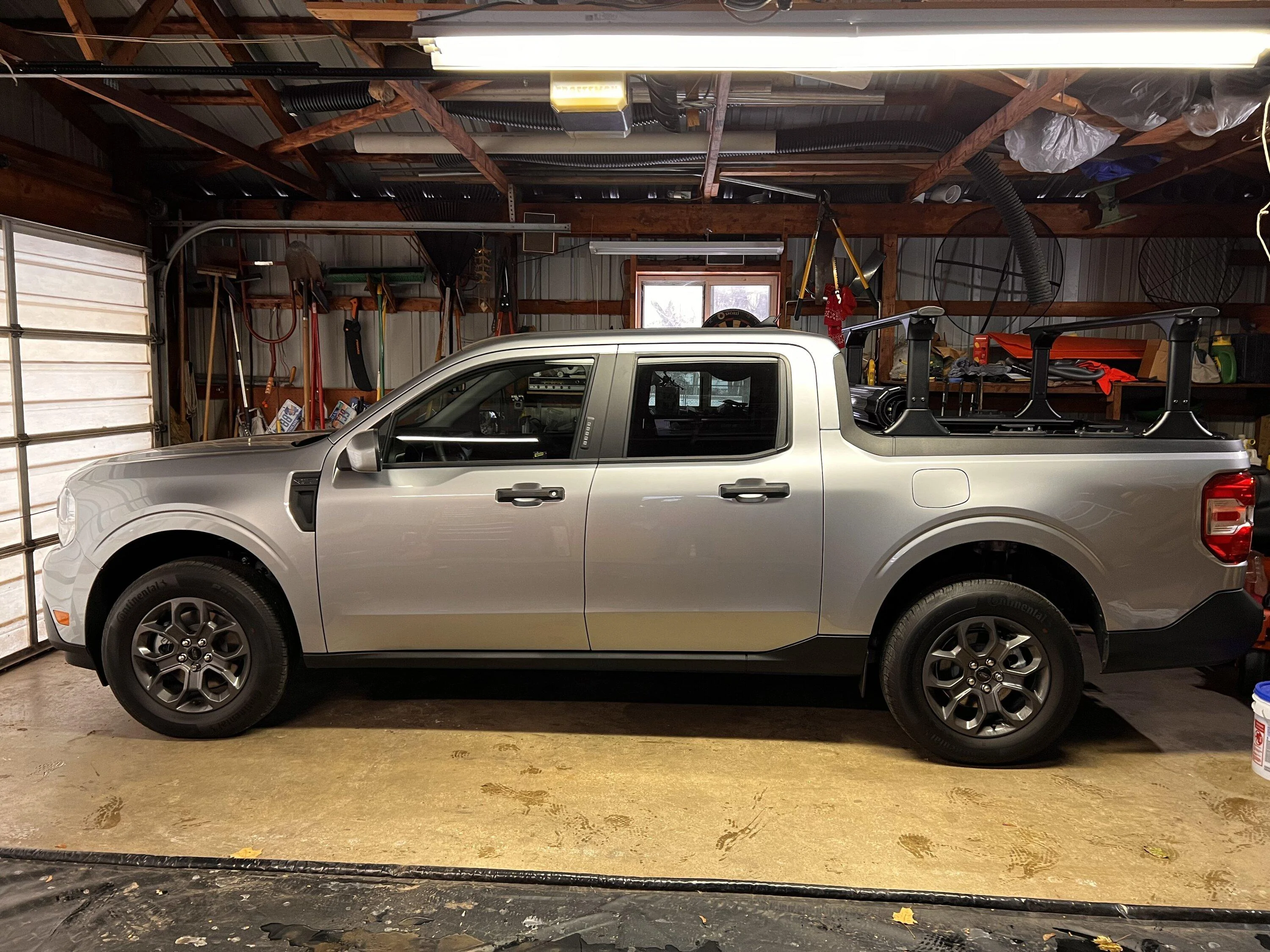

I have the Elevate racks in the bed and I have them set to the lowest setting. The Elevate racks is slightly above the roof line which should be perfect if/when I decide to install the roof rails. And Yes, I have a messy garage.
Ford Maverick Tonneaus with rack rails IMG_1847

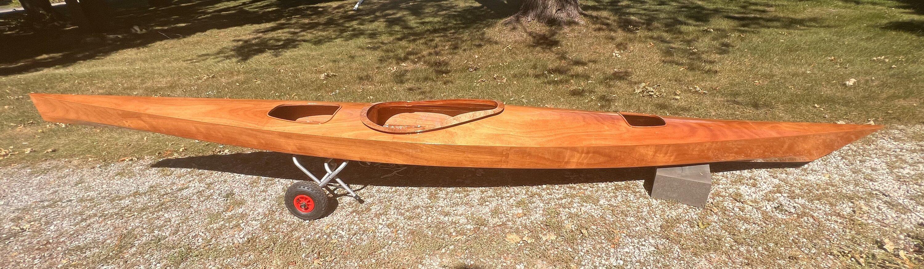

I just noticed your pic! I have the same bed racks and have some questions about your setup. How long is your kayak, do you have any issues driving on the highway (cross wind) with your kayak setup, what kind of kayak mounts do you have and how high does it sit up from the cross bars?
I'm trying to figure out the best & safest way to transport my 17 foot kayak. Part of that process is getting some roof rails installed to give my kayak more tie down since it's so long or do I really need it?
Nice kayak. Mine is 14 feet. The saddles are Malone. To minimize rear overhang it sits very far forward and I use a front tie. At 17 feet you could add a single cheap roof rack with saddles to support the front end. No problems with cross winds so far.
