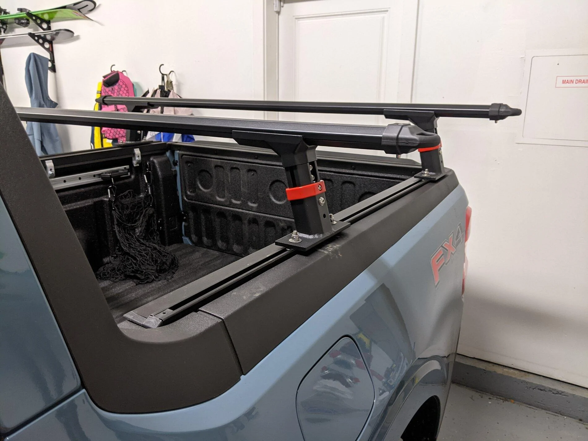

Previously I got the elevate TS rail (https://truxedo.com/product-detail/1118414) installed with my Maverick.
Has been looking for rack options, tried Yakima Tonneau Kit 1 (for OutPost/OverHaul), it doesn't fit (the base is too large).
Found this Amazon/HomeDepot rack option for 300$ (https://www.homedepot.com/p/CALHOME...-Tent-Camper-Bike-Rack-YH-PURACK-A/317488365?) or (Amazon: TMS Universal Aluminum Truck Bed Tonneau Cover Rack Crossbars Low Profile 2 Bars Set for Kayaks Bike Rack Rooftop Tent Camper Shells RVs). I think both link is actually the same thing.

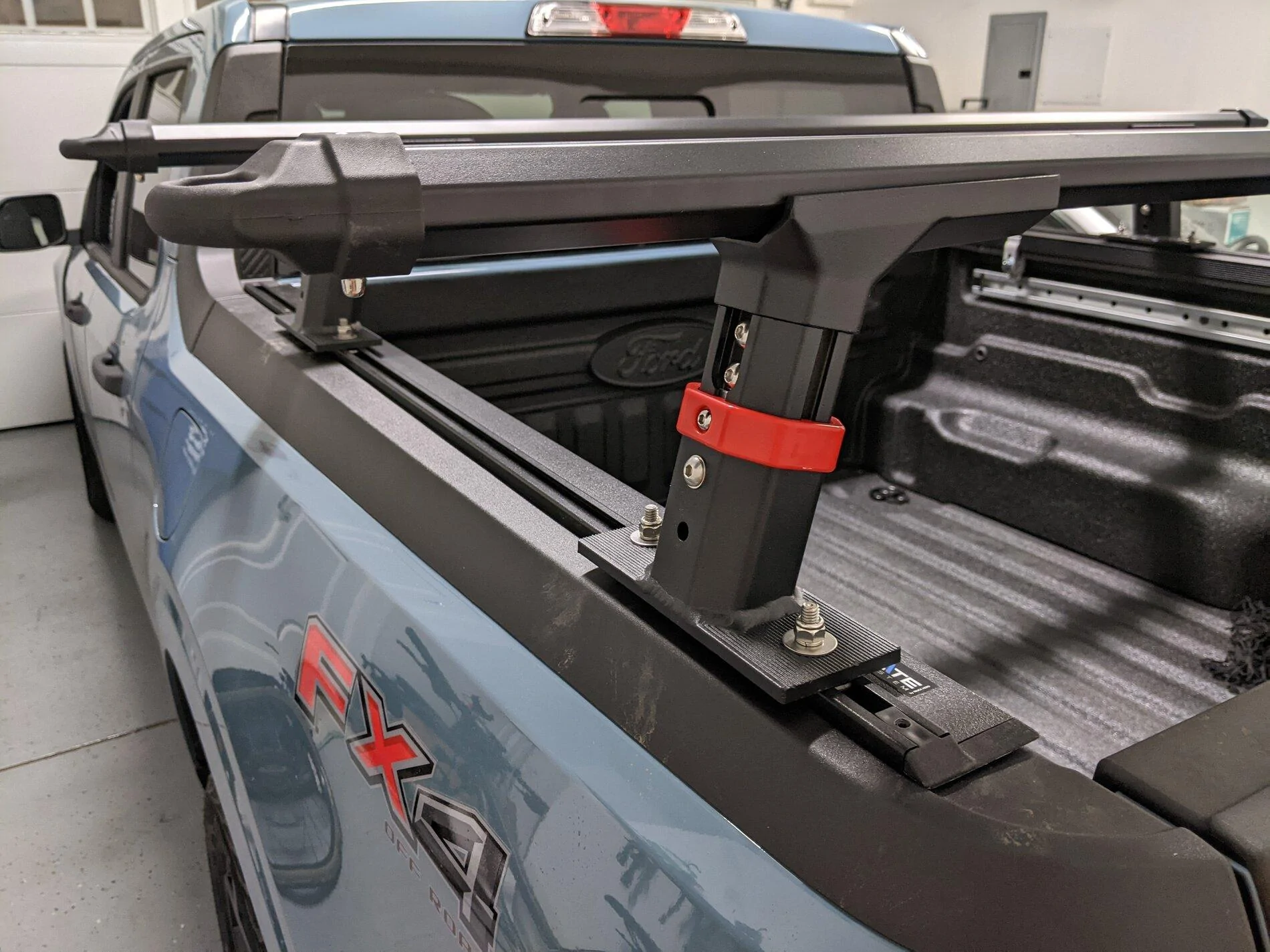

Installed and works fine. Clearance to top of bed is ~8 inch and is adjustable. Now waiting for my Bak X4s to arrive.
Note: I have to use the T-bolt of the original TS rail tie-down anchor to mount the rack. What comes with the rack is too small and spins around in the t-slot.
Note: there is also an option from Front Runner, 2x 9.7inch leg pair LASS033 (ETA in 3 weeks) or 2x 6inch leg pair LASS026 , and 1x cross bar pair LBSK018, you can find it here: https://ruggedoutlander.com/search?q=LASS028

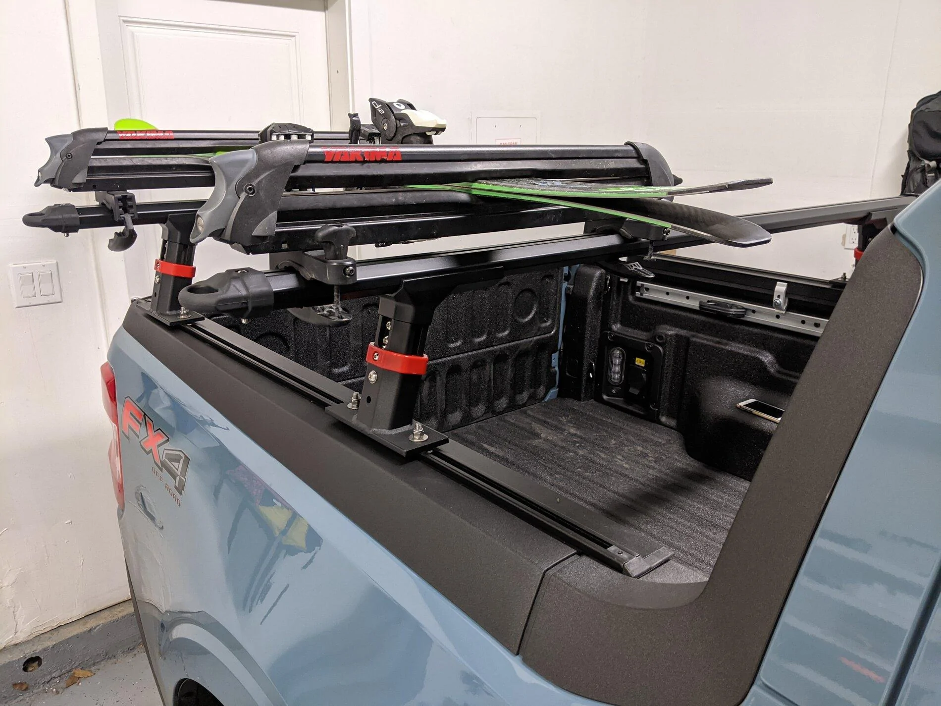

Clean. Not clear to me how that setup will work with an X4S cover, but you'll let us know.
I like that height for skis, but I also need to carry lumber so I need a higher rack to clear the roof.
