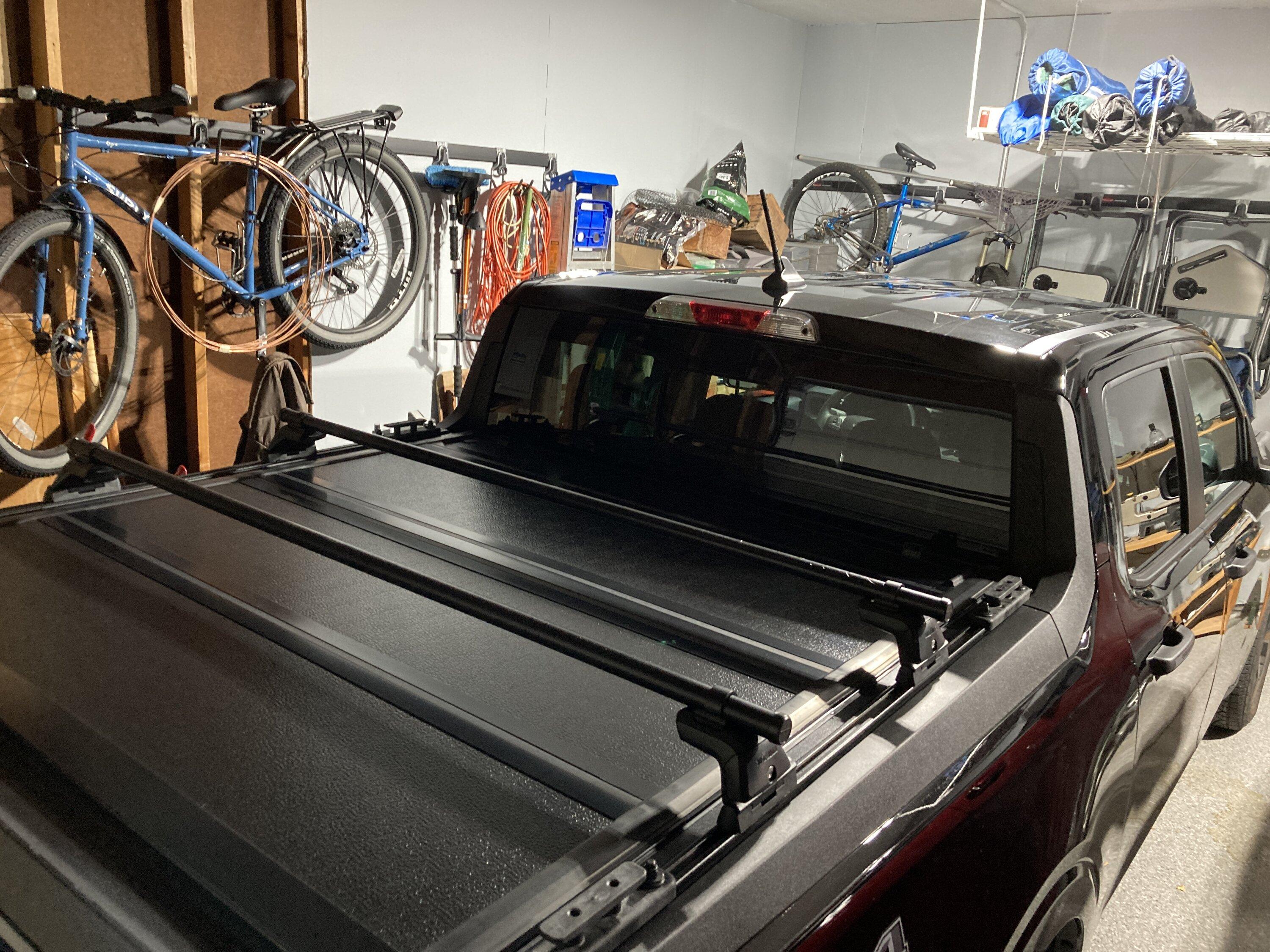

Just installed today.
Elevate rails with the trifold tonneau , yakima towers and bars.
Sorry for the stupuid question but can you open your tonneau cover past the first lip? Will those elevated rails work with any tonneau cover? I'm looking to get Bison trifold tonneau cover but wanted elevated rails to mount our bike racks; however I still want access to the bed.

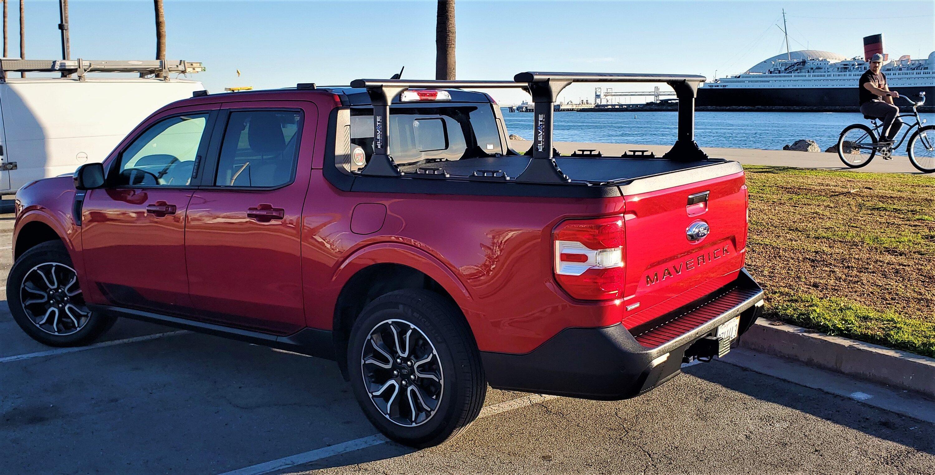

I've struggled with this for months... I originally wanted the Yakima Overhaul HD w/ HD crossbars combined with the BAK X4S. In the end I choose the "Elevate Rack System" b/c I felt it was the most workable solution with best price, availability and relatively easily modified. Bonus is the discount that RealTruck offers us.
I began the install this past weekend. To Start the BAK X4S & TS Rails installation is very straight forward and easy. The only modification needed was to trim the rubber seal against the back window. My modification may have been due to the Bedrug so do the full install to verify if trimming is needed.
The majority of my time spent was on the Elevate CS Racks. To be fair the rack install itself was very easy, my time was on modifications! As we all know the Mav is a small truck and IMHO this rack is made for the larger ones, but can be modified to work; at least for my needs. Bottom line, I wanted the Low / High settings to both be lowered. Additionally, I wanted multiple between settings to align with my Yakima Roof Racks for my kayak among other things.
Pic #1 Shows trimmed window seal
#2 Bedrug, BAK, TS rails
#3 CS Racks original low & high no crossbars
#4 Modified racks - 1-1/2" cut from both ends, re-drilled holes (don't use the original top holes).
#5 New High mount set points.
#6 New Low mount set points.
#7 Now it's aligned w/ the roof & doesn't block the brake lights.
#8 Aligned w/ Roof Racks.
I'm really pleased with the final results and the only thing that I would change is increase the end cuts from 1-1/2inches to 2 inches.
I hope this helps..

I believe I read you had the roof rack was installed at a specialized place. May I ask how much it costed material/labor. I am handy and all but drilling near the airbag seems too much for me.
It is the most impressive upgrade in your setup.
Did you consider trimming also the top beams a couple of inches too?
He mentioned before that he can not open it but it takes just a few minutes to remove the bara/beams from the rails
