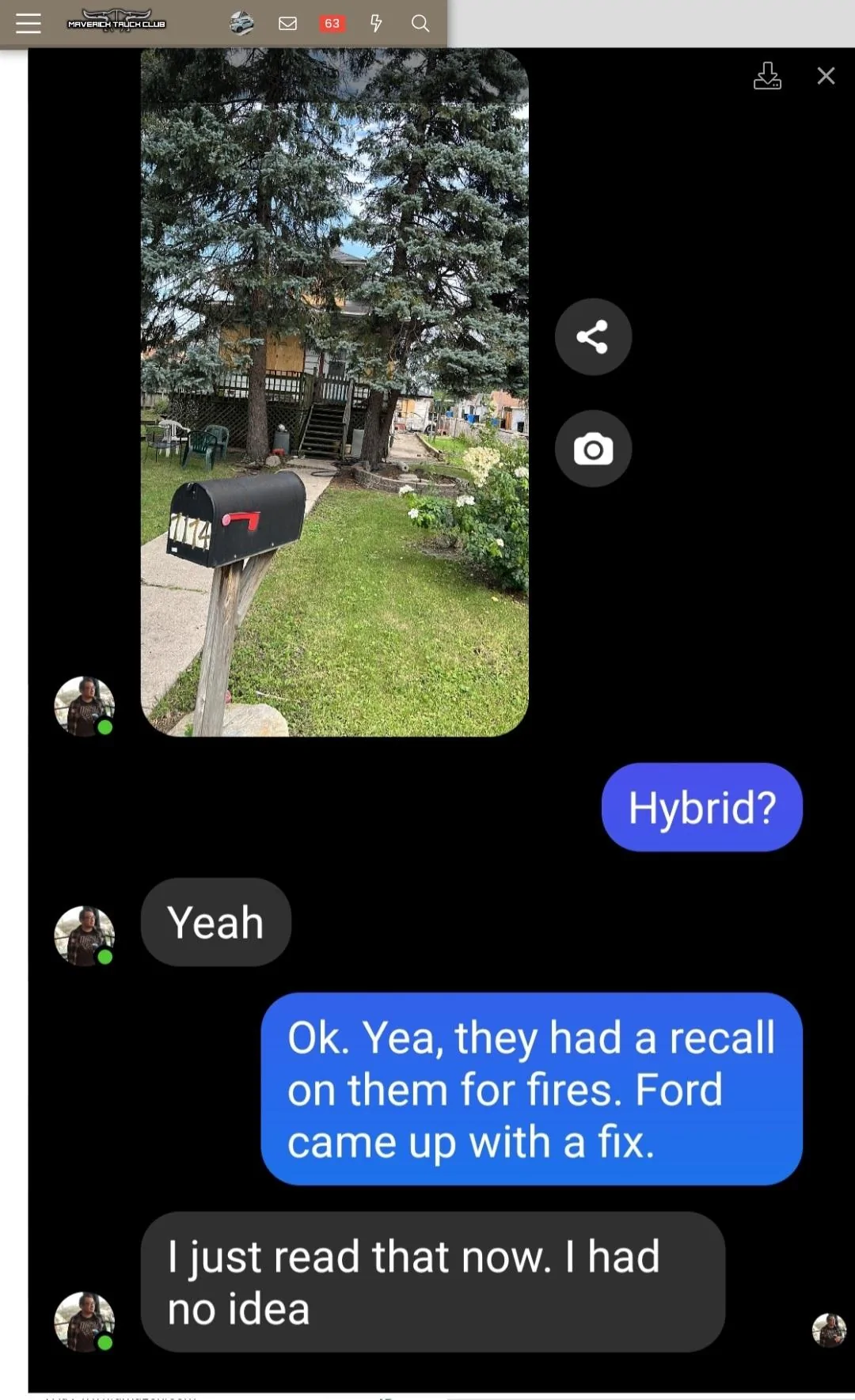

UPDATE: Fire Department investigators confirmed the fire started under the hood of the Maverick.
So it's related to the gas engine (since the high voltage battery is located under the vehicle away from the hood).
If I was going to arm chair investigate this, my guess would be a spark from something wrong with the 12 volt system (since that's active when the Mav's parked for the computer and wireless stuff) ignited something in the gas engine. That's what usually causes these issues. Like it *could* have been a spark from the high voltage system, but it seems less likely while parked.
And, again, this may have just been a build issue with this particular Mav, and not a widespread issue.

Maybe I missed it, but I don't recall anyone stating yet that is was a hybrid.
High voltage wires run under the hood too, as well as the electric drive motor and generator. A source under the hood has not been pinpointed. I would doubt it's the gas engine, as it was off and cold. Most likely electrical. Could be a 12 voltage accessory too.
There are many combustible things in an ICE engine, whether they're cold or not.

A relative sent me this video of his uncles truck. It caught fire at 4 am.
Any idea what year / build month it was from ?
Saw you confirmed the fire department said it originated from it but your original post also says the same thing. More curious than anything how did he know the origin ?
Glad everyone is ok..not gonna lie. This has me little nervous.
