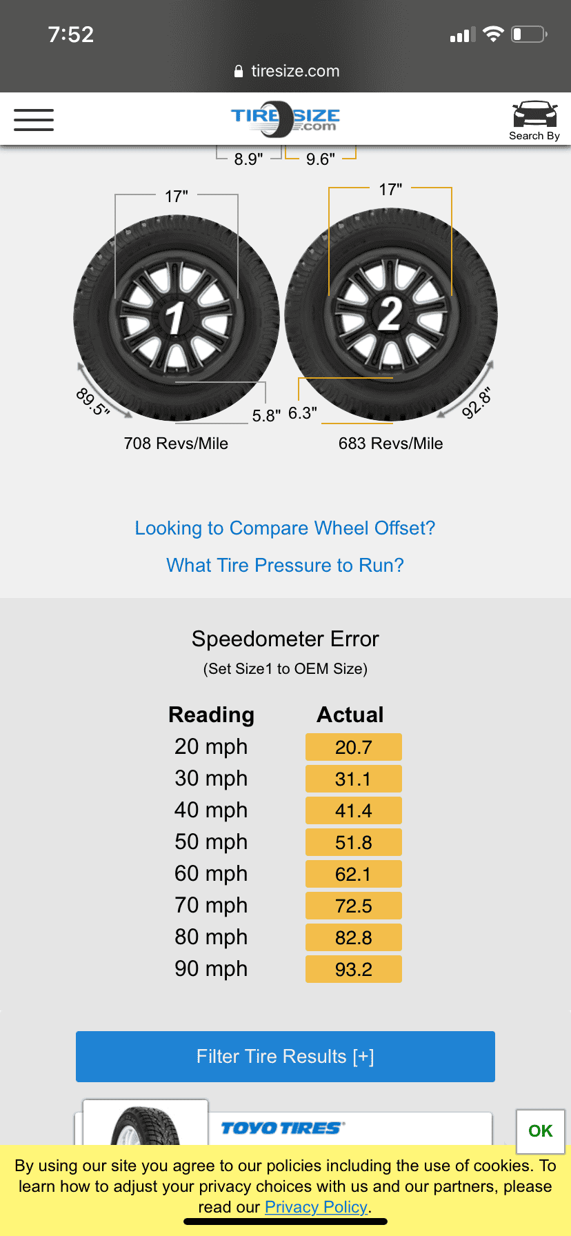

Ford Maverick Tire weight - how much does it matter? DE889602-0FD8-477C-85F8-5E5B3B239626
Above info is for 245/65/17

The longer speed time has to do with the tires bring taller not the weight. With the taller tires you are actually gearing the vehicle high which should actually help gas mileage if the contact patch was the same. In this case its not 245 vs 225.
The weight does have an effect like on mpg just like any extra load you put on the car but 80 pounds on the wheel will have the same effect as 80 pounds in the cab.
The main difference is the contact patch on the road is larger. With the tires in question not only are you wider but since the you are taller there will be more contact patch length wise also and. The contact patch length will have more effect them the width in this case. So short answer is weight has just as much effect on tires as putting that weight anywhere else on the truck.
