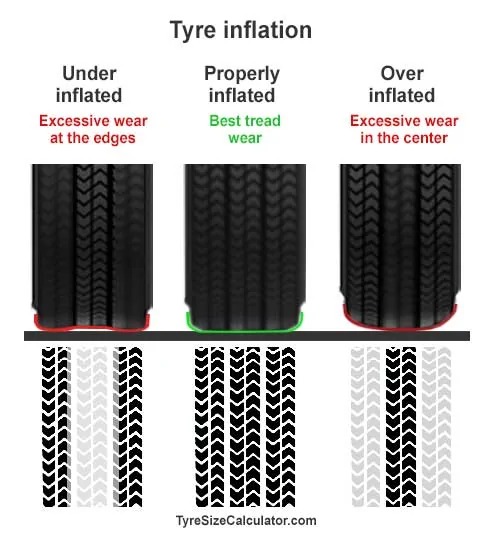

Yeah, it reduces the contact patch to run over pressure. Also get bad ride quality, less traction, and uneven wear on the middle of the tread though.
I agree with the first part but the rest is bunk. And the reduction in contact patch comes with a great improvement in contact patch stability at cornering limits.
If you've ever autocrossed, you would have adjusted tire pressure for optimum cornering performance, typically at a front-rear pressure difference that mirrored the front-rear weight distribution of the car. 45 psi front, 35 rear was kind of the starting point. White shoe polish at the edge of the tread told you if you needed to add or subtract between runs.
Since then (1980), I've set just below the pressure listed on the sidewall, and the ride's fine, there's better lateral traction and today's belted tires wear nice and uniformly at these pressures. Apparently, YMMV.
That's a very specific use case though in which you're running overpressure to stiffen the sidewalls in the rapid high-G maneuvers in order to avoid rolling over onto the sidewall, which I'd wager is not going to be a common occurrence for Mavericks.

True, but I have seen cars roll on the highway when they did a quick maneuver and the tire came off the bead. Thankfully, it was in my rearview mirror.
I remember diagrams like this from my youth, when bias-ply tires were the standard, and this kind of thing was critical to making 20K miles on a set. Then came belted bias-ply (Anyone remember Wide Oval tires? They were 70 series.) That's when this diagram stopped making sense. Of course, Michelin had been making radial ply tires for decades, and they have a far wider pressure range due to the more compliant construction.
I'll be removing my OE tires in the coming weeks, and would be happy to share my tread depth profile at end-of-life. I set them at 38 psi a year ago (15K miles), and have seen 36-41 psi on the road. Sidewall rating is 41 psi.
The C-Max spent several years in the high 40's (51 psi rating) and its Michelin Energy Savers were nice and flat when traded in. Others report similar experiences. No idea why you'd see something different.
