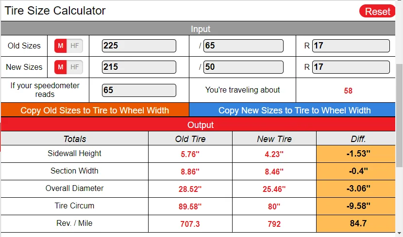

I Have the 2024 Maverick Hybrid with 225/65R17 on truck..
I have a new set of 215/50R17 -91T snows sitting in my garage
Any Idea what type of issues i could have using these??

What is the diameter of the snows you have? That is key NOT the width. Tire Rack can be used to look up factory tire diameter and if they carry the snows you have then they have that diameter listed too,. I wouldn't use them if its off by much. Maybe a tenth of an inch at most. Funny thing I have Bridgestone Blizzak WS 90 snows which according to Bridgestone are exactly same diameter 28.5 as factory tire yet they are 2 MPH slower.
Oh the factory tire gave ME exactly right speed according to two separate gps units I have for mph , maybe odometer not perfect no idea. . Not sure where your getting its 3 percent off from factory NoVaJimmy ???

Have you put the 215/50R17 next to your truck? It’s tiny! It’s going to look like a temporary donut or worse. Spec-wise it’s 3 inches shorter. You’d LOSE 1-1/2 inches of ground clearance immediately, which would be the last thing I’d want to do in a snowy climate (not sure where you live). The 215’s are also over 1-1/2 inches narrower theoretical sidewall bulge (tread itself is only 0.4 inches narrower). Simply standing the tires next to each other should be obvious to see the differences. The 215/50R17 is on the order of several sizes smaller than stock. Not to mention your speedo would be reading about 11% too fast. You can compare specs between sizes on numerous tire size calculators online, or by looking at factory specs on a tire manufacturer’s website.
Not even an option.
