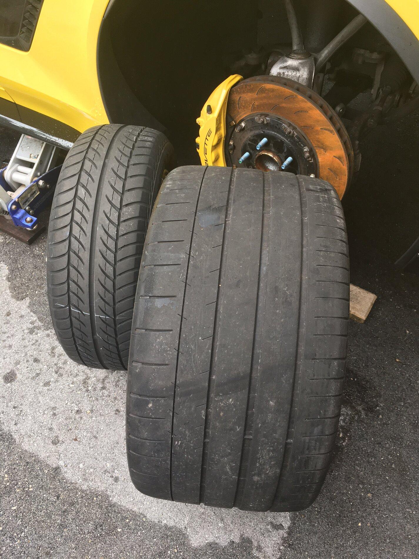

I thought the only important issue, was how good they look? I tried some sweet 15" very light wheels on one of my rides, but they just wouldn't fit over the calipers!

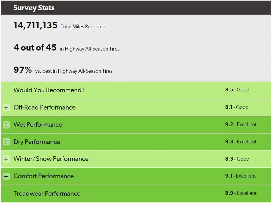

I have these Michelin Defender LTX for that reason on my Ram 1500 and have been very happy with them, especially in the rain: https://www.tirerack.com/tires/tires.jsp?tireMake=Michelin&tireModel=Defender+LTX+M/S
In 225/65/17 they are 29lbs and 720 wear rated in spite of having pretty darn good dry traction and are $70 off right now.
I'm fairly confident these would be objectively better in most measurable ways on the street thanks to the street oriented tread pattern design, but they aren't going to have that rugged offroad look to them or of course be offroad capable tires, but for the type of dirt roads I've taken my RWD Ram down they'd had no problems.

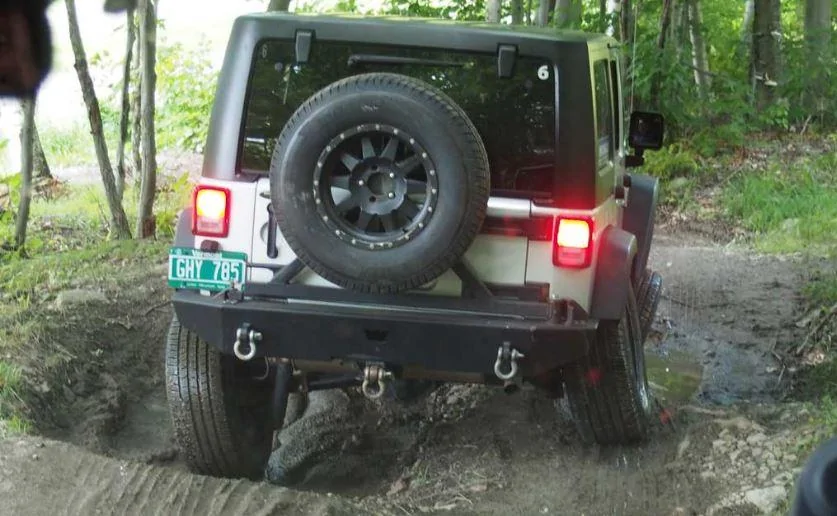

Cool factor definitely matters, but IMO you don't have to go with true all-terrain tires to look like they belong on a truck, and you can still do light off-roading without the sacrifice in highway drone and reduced street traction of an all terrain pattern.
