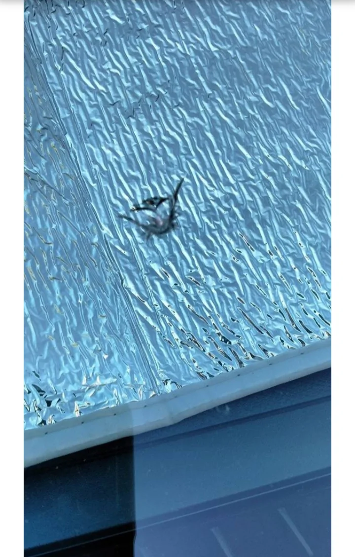

How Small is it?
Here's the crack in my windshield I got on 4th of July weekend 2024 Safelite did the best they could but it's still pretty visible.

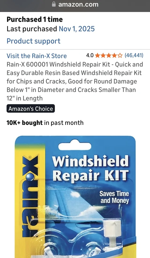

If you don't feel like going to DIY route which is what I normally do for small ones like you're talking you can buy kits on Amazon that'll fix it just as good as safe light.
Or you can go through your insurance if you have zero comprehensive like I do and it won't cost any extra.
I've had safe light due to repairs on small rock cracks about a quarter of an inch spider, and I can still visibly see them. Whereas the ones I've DIY'd with the Amazon kit I purchased for $30 you can't even see them anymore and they've been holding tight for nearly 6 months now.

What Chops posted above. I ordered the same Rain-X kit from Amazon. $13 bucks. I'm on chip number 4 on the original 2024 Mav windshield. All four did it myself with the kit. None have spread AT ALL. Just make sure you follow the directions....very simple. I'd do it on a sunny day so the last step cures it good with the clear sheet over it. Watch a YouTube video on how to use it. I'll get a new windshield some day....but GLAD I didn't run right out on the first hit. For what it's worth...2 of my 4 hits came from the same truck WAY ahead of me. There was loose gravel on the road from construction. My daughter and her husband both took hits the same week from the same stretch of highway. It's been cleaned off since then. Another thing to note. I fixed my daughter's hit and her husband's car and truck with the same kit. That's 7 total and I still have resin left for more. If you have any specific questions about the Rain-X kit, post back and let me know. :cool:
