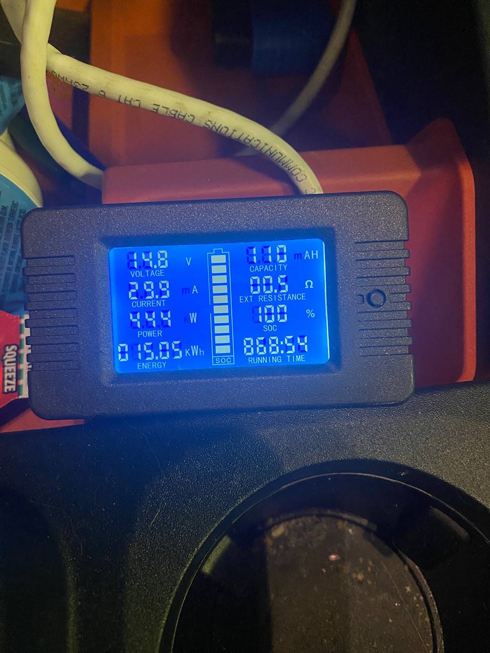

From what I am seeing on my 23 mav. hybrid XLT. I think the main issue so far is the battery is just too small, (low battery reserve).
I have a volt and amp meter connected to the battery, and have the voltage and amperage on the screen, (car scanner).
So I can see whats going on when in "ready" mode and when the key is off.
Right now, (spring), the battery is charging at 14.6v, in the winter time it was charging at 15v.
The battery has all the current it could take, (i have seen 40 amps going to the battery).
When I get to work, (a 15 minute drive) the current going to the battery is about 3-4 amps at 14.6 volts, so it may not be fully charged.
There is a battery draw right when you turn off the key,
This may be just the lights or other things, but when the lights are OFF the current draw is still present for a while.
It evenly drops, but there is still a current draw.

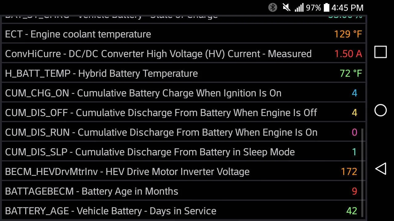

You might also find these PIDS (can't recall if I showed you) and see if yours is keeping it more or less charged than the usage. Mine is always negative by 1 Ah, sometimes 2, and that's when the longer charging at higher Amps occurs.
Currently mine are at 22, 20, and 3.
They would be higher, but I did a BS reset after I charged it up once 206 Day ago. (included the BS in the charging loop, but because it only logs Ignition On charged, it didn't matter.)
So the charging strategy appears happy to allow combined discharges to be at least 1Ah below the charges.

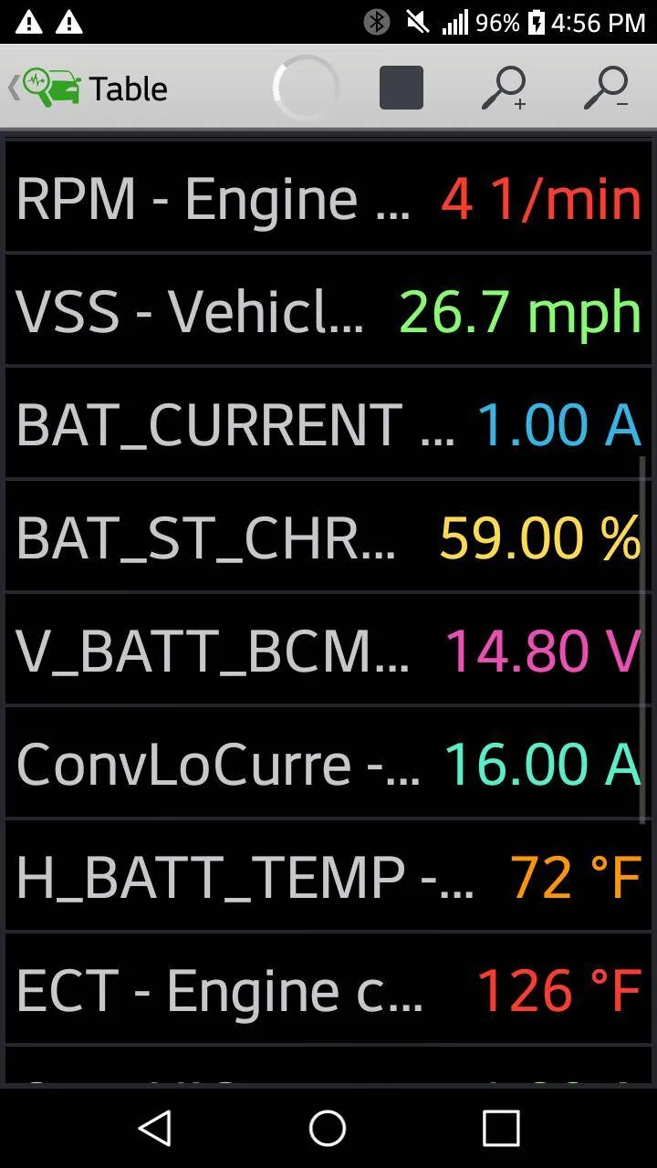

Thank you for the info. you have.
Your correct, wait about a hour or less and it drops down to .5amps or less. (on amp meter on battery).
I was wondering about the SOC on my car scanner screen, if it was correct or not.
I was kind of surprised when I noticed 65% SOC and showing 14.6 v and 2A. ( I thought it would be higher).
Through out most of my driving, my "volt meter" or "car scanner app" shows 14.6V, 15V in the winter time.
Only one time I did something and it showed 13V but 0 amps in or out of the battery, and the dc to dc converter was supplying all the electric to the electric needs.
Crazy thing was I could only get it to charge to 14.5V when I turned on the lights. any other load, (fan, heated seat, radio, wipers), would not cause the charging at higher voltage., only lights. The BMS must have reset it system and now its charging like it used to.

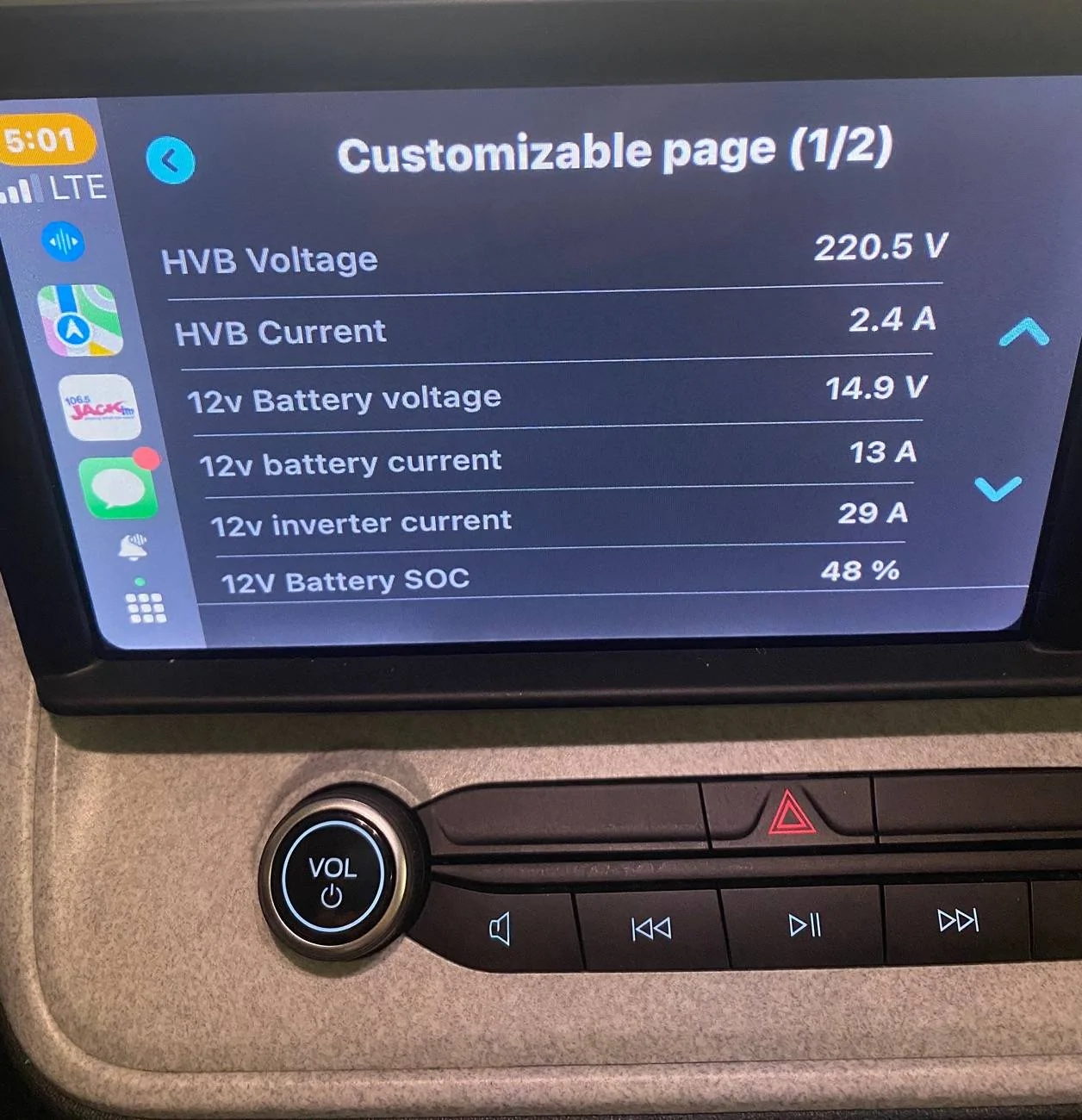

Already got those PIDS.
Also has some for Amps/Current - which is even more important for the charging.

I put mine on the big screen
Don’t look at SOC on the little screen, it’s not programmed.
