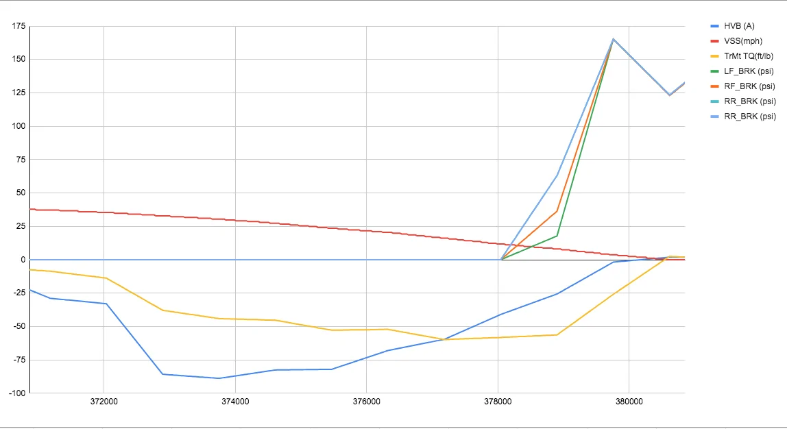

Ohhhh - now there's some observation I need to make on PID's I already display.
Brake pressure to each wheel.
Does the regen from braking engage the rear brakes on it's own, maybe different at different speeds?
Considering some of the comments on rear brake wear that seems premature - must be getting used extra at some point, or it truly just is the effect seen with gentle brakers.
Data snippet for the following final seconds before a stop.
Was going 40 mph with ICE on, starting coasting as foot went to brake and ICE went off.
Pressed brake enough to stay at higher end of regen but didn't need max braking, plenty of battery to fill. About 1.1 mm on brake.
At 11.8 mph brake pressure started being applied - still totally in regen area for my press.
Rear brake PSI higher than front, until about 3.7 mph and 1.6 seconds later, when they all merged. (curious why front right about 2x PSI as left until merge, straight road)
I've noticed this effect before, rear's given pressure just barely stronger than fronts.
Data attached. Graph pic. Blue line showing amps going to battery, with neg traction motor torque confirming regen.
