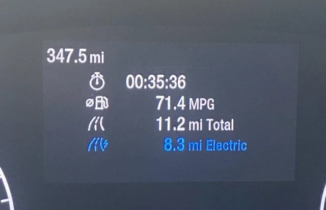

Slippery mode is all I use now. Unless I forget. I'm on flat streets and flat freeways. I may use a different mode or L if I had lots of hills.
My skills are getting better. I do watch my rearview mirror. If people are behind me after a stop, I'll accelerate normally, like 20-25% on the power meter, 2800 engine RPM then back off; let it go to EV mode, and coast or use gentle electric power to maintain the speed limit or 3-4 above it. Seems to do just as well, if not better than trying to launch and accelerate in all electric. Then I started to think about it.
Accelerating from a dead stop, takes a lot of juice and you spend a lot of time at low speeds and cover very little ground in electric. Getting to 45 or 55 MPH in 20 seconds, then kicking off the engine, and coasting or using electric to maintain, you can glide for 2-3 minutes, at the high speed, and you cover much more ground in EV mode.
Week one in the truck I was pleased to get 55 MPG. Week two I was excited to see 65 MPG routinely. My new best is 71 MPG for a 11 mile commute. Flat, no hill assist, and ever so slightly net uphill.
I am new to this truck but have been driving hybrids since 2005.
Ford Maverick Tested: Slippery Mode is best for highest MPG (in Hybrid Maverick) 36674407-CD3A-4C40-AAD1-A5BDBB27F376
I'm on the fuel tank from delivery, 347.5 miles total, with 379 showing left to go on the miles to empty.
