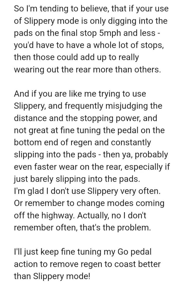

Here just read this from another poster in a thread about early wear on rotors.
Ford Maverick Question about Slippery Mode Screenshot_20251122-152052_Chrom

Slippery mode causes the braking regen to be squeezed into the last 15-20% of the available space, before the brake pads are applied.
Again - you could get good at that, but the brake pedal doesn't have nearly as much range as the Go pedal - if having trouble with Go pedal, you'll likely have issues here too.
Which means you'll be going past regen into the pads easily.
Again - driving scerarios matter - if long coasting available with few lights, might fit well. If Stop & go traffic with many lights without much lead time, might be wasting regen going into pads constantly.
This mode also causes the rear pads to be brought in 1st every so slightly more when you do go past regen into the pads.
