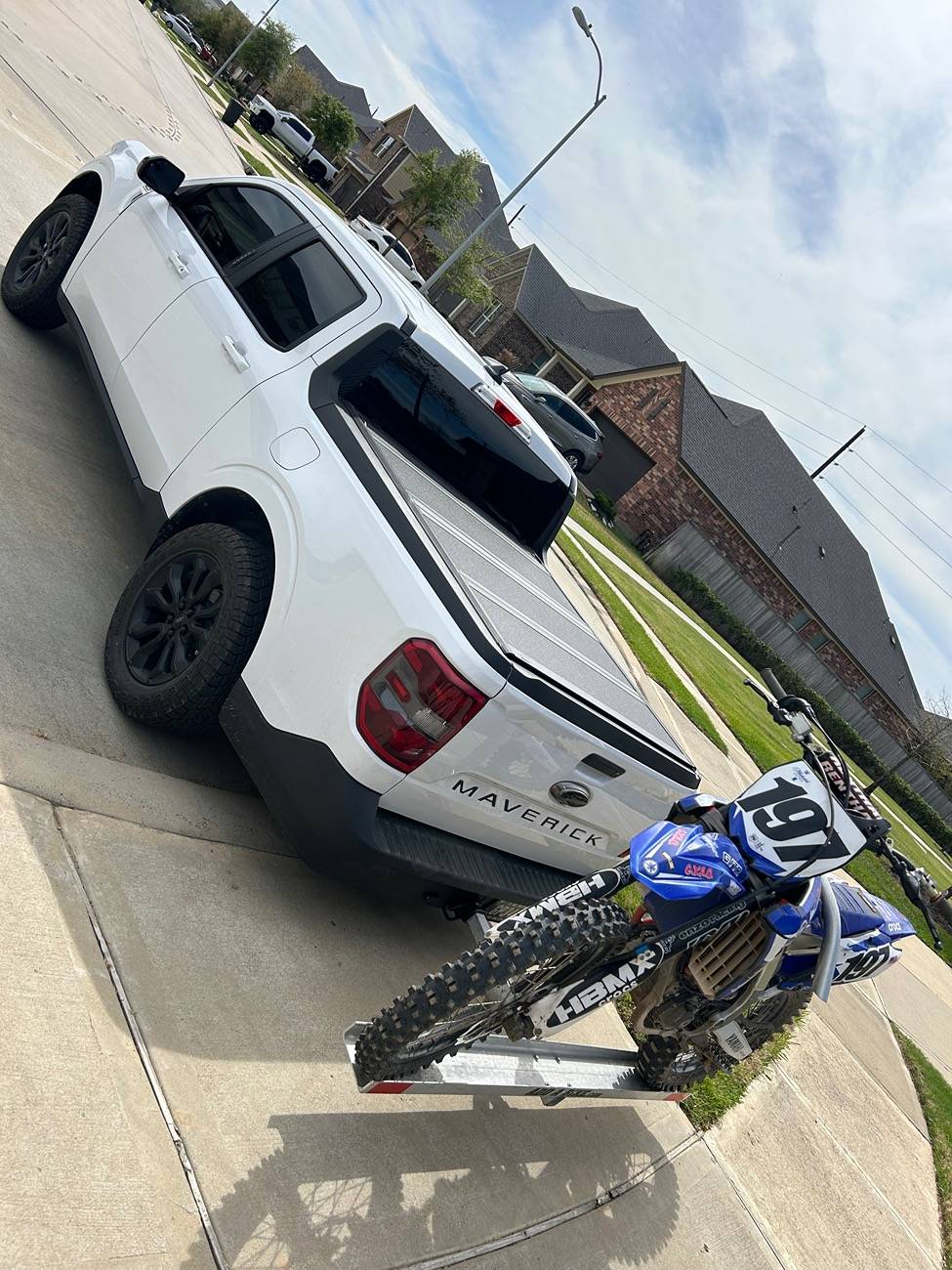

Nice setup, but you're probably pushing the limits of the 400lb tongue weight limit for the hitch.
YZ250 is listed as 227lbs and joehauler is 50lbs. Add in ramp, etc and you're probably at about 300lbs. The 400lbs limit is based on a typical 8" receiver drawbar not the extended weight of hitch carrier. Generally the hitches are over-engineered to take into account variability of a dynamic load, but bottom line is take it easy over rough terrain so the hitch doesn't get damaged.

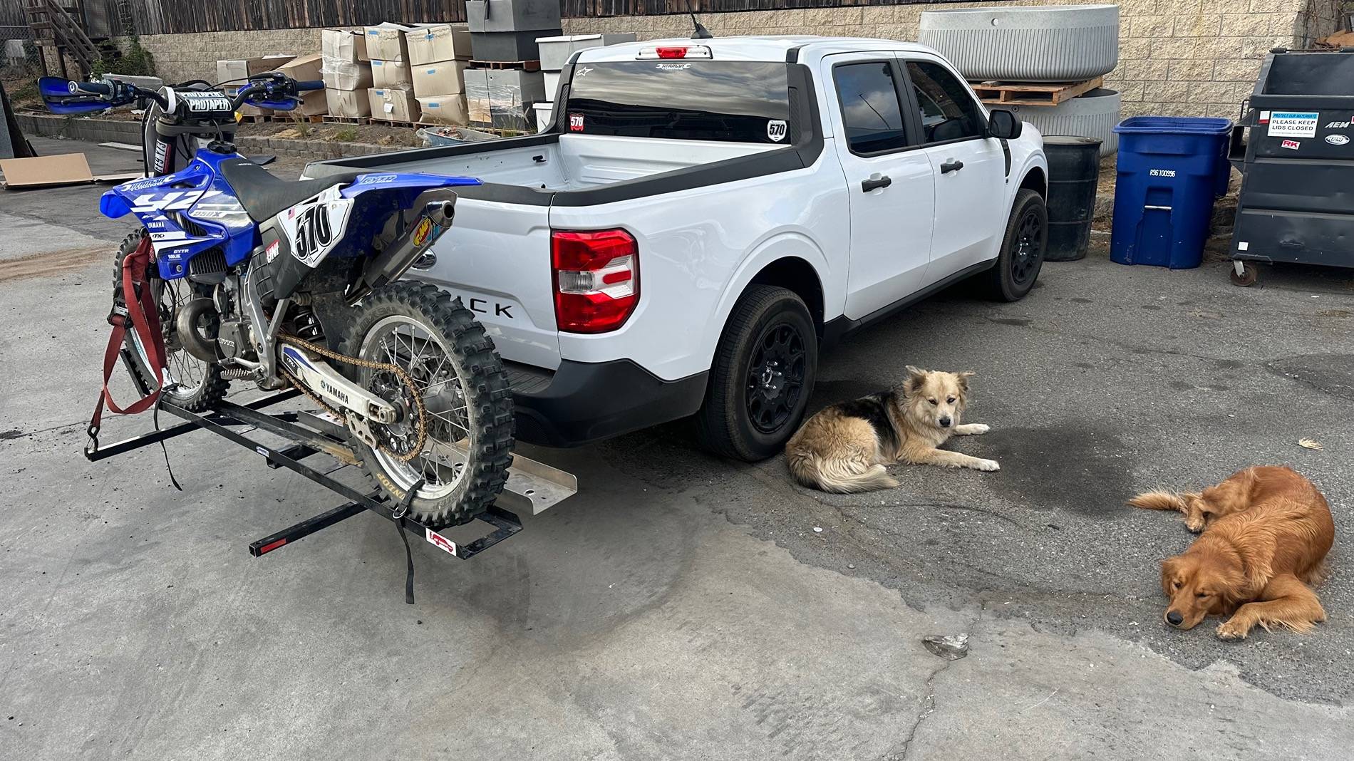

This isn’t a set up I’ll use, I needed to get the joe hauler home for use on my Gladiator. But I thought I would test it out and see if it’s doe able. It doesn’t change the handling of the truck and it started raining on me.

Hauling my YZ250 on my @joehauler hitch hauler. I was worried it was going to upset the handling of the truck, but it didn’t even know it was back there. I still got 40 mpg also
I have a similar setup and run straps from the upper rear cargo hold downs to outside corners of the carrier to keep it from rocking. I haul a 2024 KLX 300 on it and have had no problems. Probably around 350 pounds but the addition of the straps transfers some of the weight and keeps it from rocking in the receiver.

the dogs don't look too worried about it

I used the hitch tightener plate to keep it from rocking.
