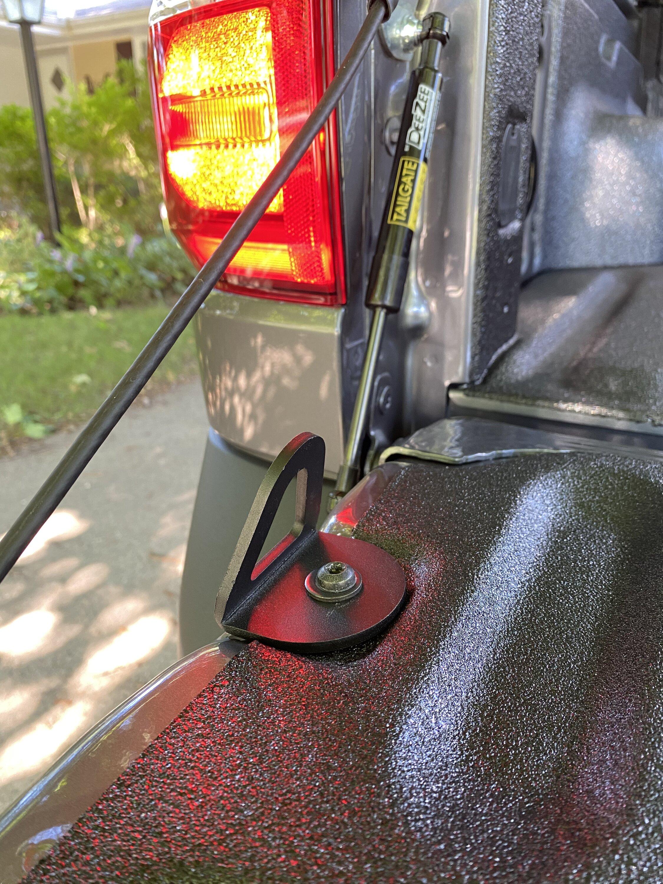

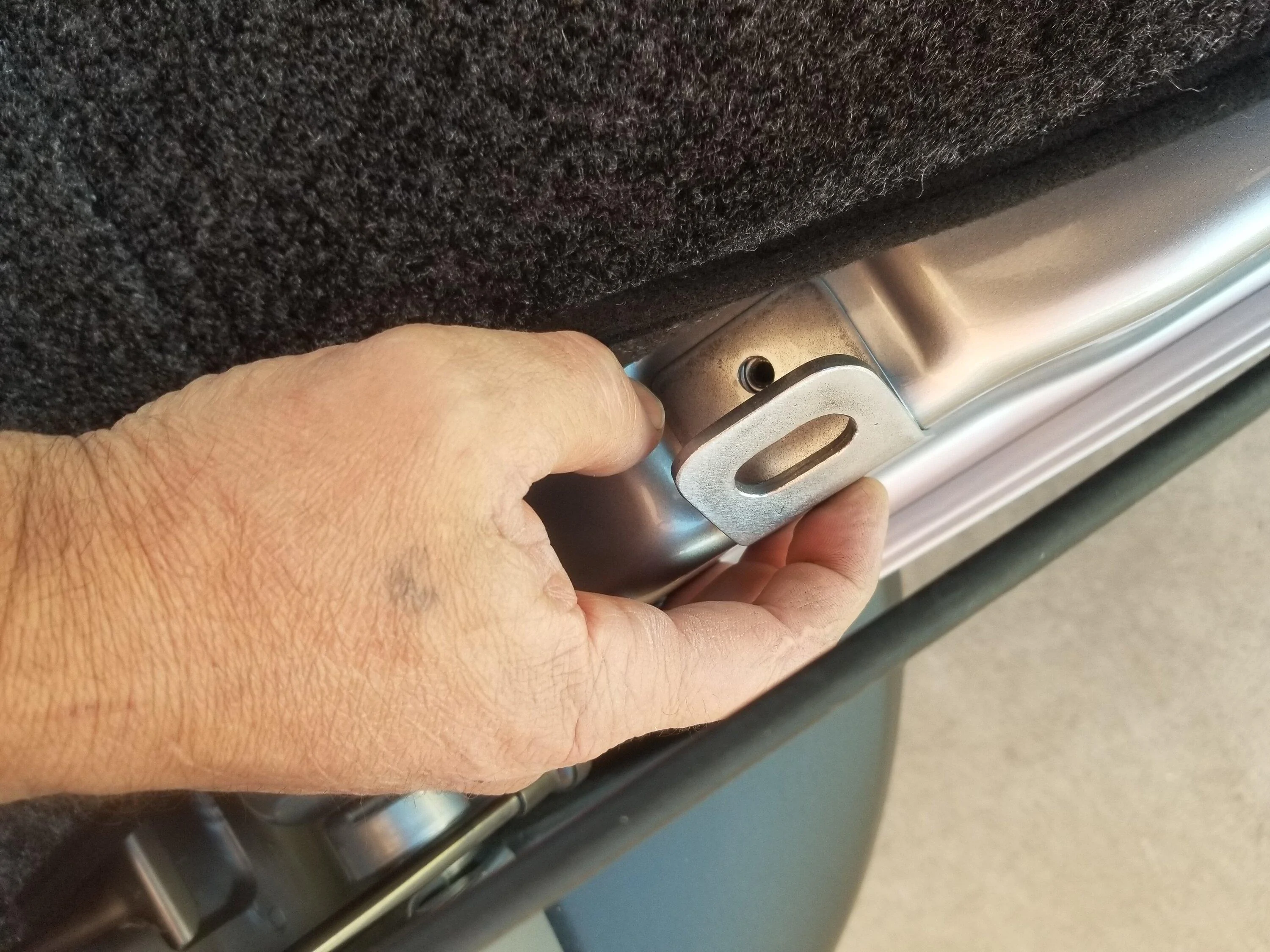

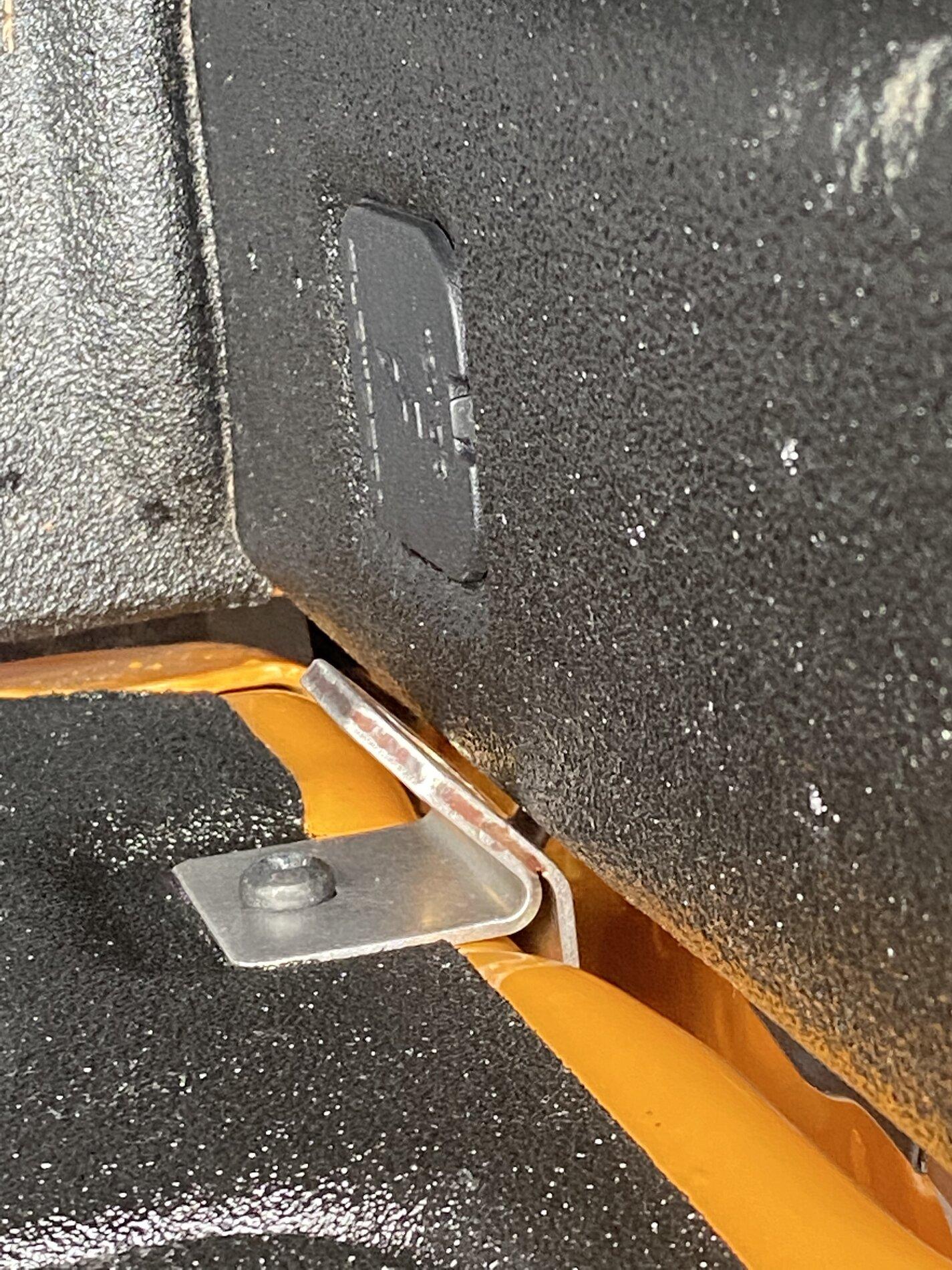

I finally got my truck and installed the tailgate assist and these brackets work perfectly as a fixed tie down point in place of the lost bottle opener! I'll try to get some pictures later but they worked exactly as I had hoped previously. Highly recommend if you're looking for a solid bracket.
Except the original tiedown point uses 2 bolts, correct? I'd be hesitant to put too much load on these with only one bolt

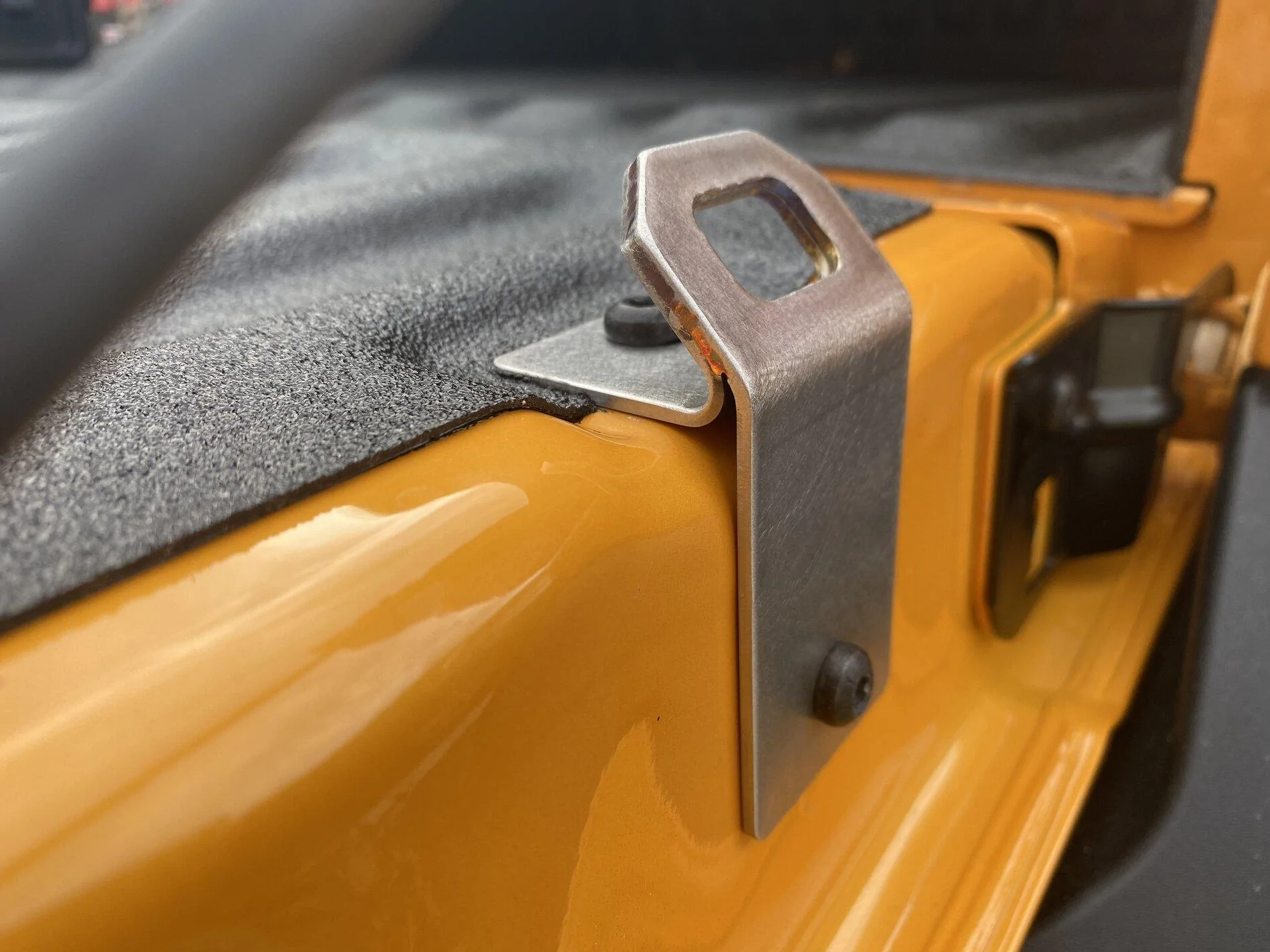

Here’s a couple pictures I got! You have to use a washer as the hole in the bracket is larger than the screw head but it feels super solid and strong. Clearance is perfect when tailgate is closed and it stays tucked out of the way

I see how you have this in here, but it seems to me that if you actually use it as a tie down, all the force of the weight is going to be levered against your tailgate (with the tailgate acting like a fulcrum), and applying serious pressure to your bolt.
Any reason you didn't put it up on the "top" of the tailgate, on your bedliner?
