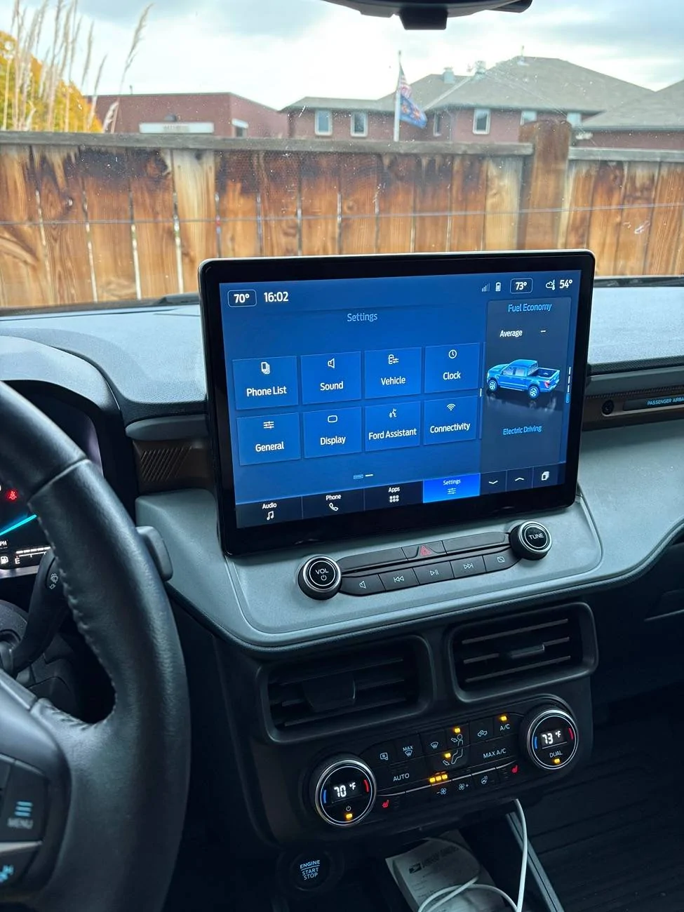

thanks for sharing this! Just swapped in a 12” on my Lariat hybrid using this as a starting point. Using a couple plastic spacers, longer bolts, and a 100mm straight bracket for the passenger side bolt I was able to just bend the middle mount point on the screen down, cut out the plastic back cover of the screen, and bolt right in securely. Little large of a gap on the right side of my screen but otherwise looks great.
My boot screen aspect ratio is weird though, and not sure what controls that if anyone has an idea where that’s set in forscan?
Also careful for anyone doing this, don’t reset the sync 4 APIM settings or you’ll lose the app. Think I’d have to reinstall the sync 3 one to get it back sadly.
Did you take any pictures of how you mounted it?

Looks good, but wouldn't the aspect ratio of the 13.2 screen have the screen height lower?
Toddman45
Todd
May 21, 2024
2,026
2,866
St. Louis, MO
I had picked up a 13.2 off LKQ originally, but I couldn’t see how you’d mount that without it sticking out or fitting weird. Props to the others who made it look good, I’m content with a slightly smaller screen.
It might be smaller width wise, but heightwise it's bigger. Especially compared to the 13.2 in screen that comes in my dad's 23 Corsair or the new 25 Mavericks.
