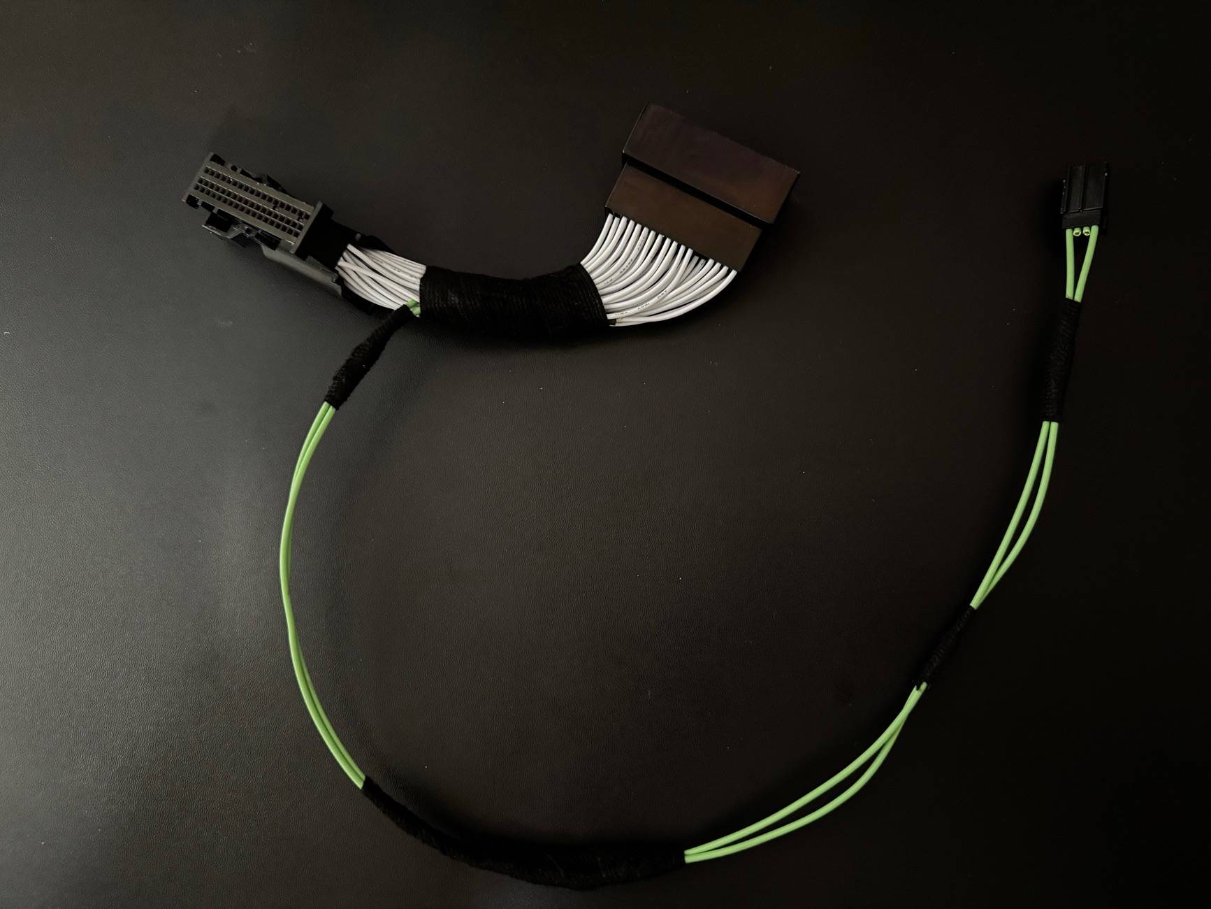

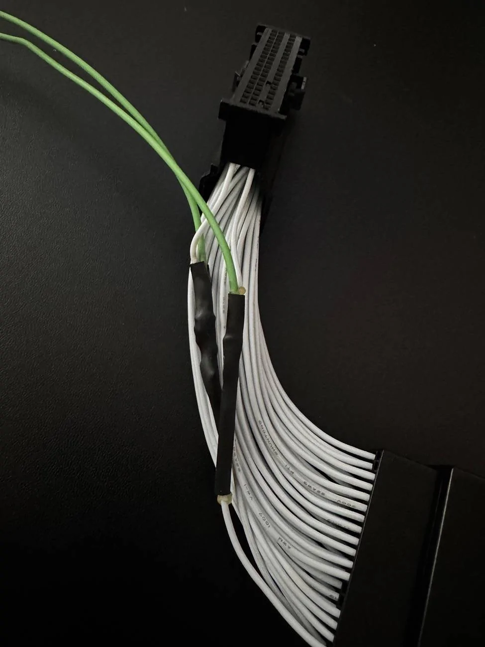

I finished modifying my passthrough harness today. I took my time but it turned out great. Now to find some time to pull the truck apart to install everything and see if it works.
