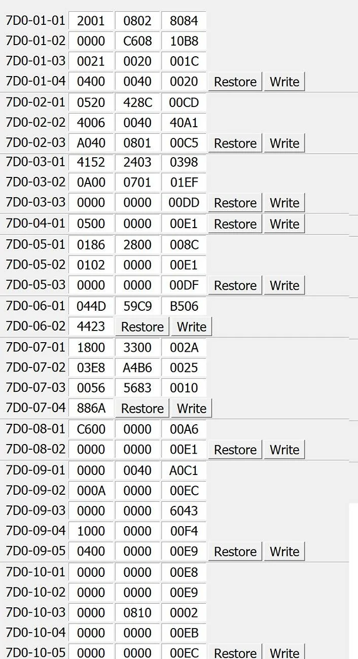

I do also, like Bill said just ignore
DE07/7D0-08-01: xxxx-xx00-xx--
DE07/7D0-08-01: 0xxx-xxxx-xx--
DE08/7D0-09-03: xxxx-xxxx-x0--
DE07/7D0-08-01: x0xx-xxxx-xx--
DE00/7D0-01-03: x0xx-xxxx-xx--
Solved!
That cancels everything related and there is no more error.

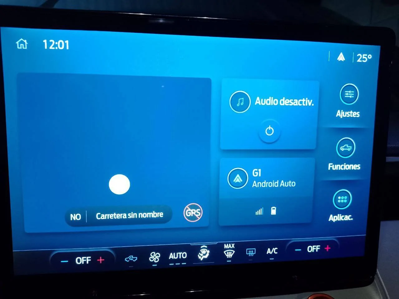

Would it be possible for APIM to show thrips like this?

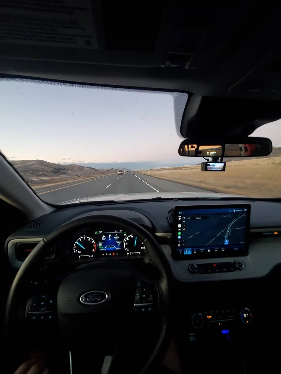

Unfortunately, on my end I tried two separate APIMs from 2024, two different harness’s, two separate USB cables, and a million different ForScan adjustments, but no matter what I still have audio crackling through Bluetooth or USB audio. Tried an APIM from 2021 running on very old firmware and it worked perfect, but lose some of the newer look and full screen CarPlay. I’ve kind of given up on it as a whole as it seems this mod just doesn’t want to play nice with my ‘24 Hybrid.
Was a fun try though! Cool to get it so close.

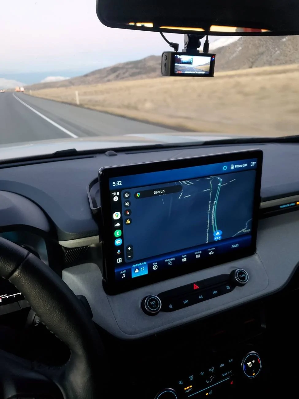

Looks 5x better than the OEM 8" & cubby. I wish a member would sell a pnp harness along with detailed install. As im too lazy to make up my own.😎
Could it be that the problem is the ACM and not the APIM? :inspect:
I just would think it odd that the ACM has no issue with the 2021 APIM or the Mavericks original. Just these two 2024 APIMs.

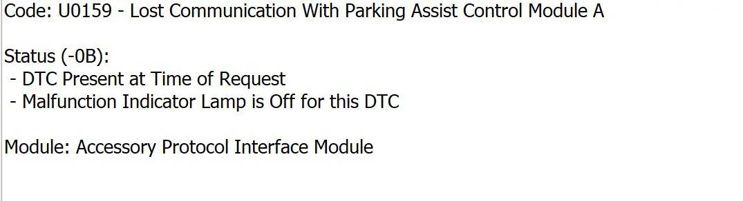

What software version are you guys running? Both of the 2024 APIMs I had that are acting up are running this one. Trying to figure out if it’s a hardware revision that caused some communication issues with the ACM or a possible software bug. Would be helpful to let others know what to avoid in the future!
I did not have it showing anything until I swapped my gauge cluster to one from a 23 escape. Now they talk to each other and I get all that info

Yeah, I feel like this has to be a software bug. Two of my APIMs running the same software having the same issue while one running much much older software doesn’t have that issue at all?
Feel like I’d be better off buying a Mongoose and power supply and updating overnight using FDRS rather than trying to find another APIM.
