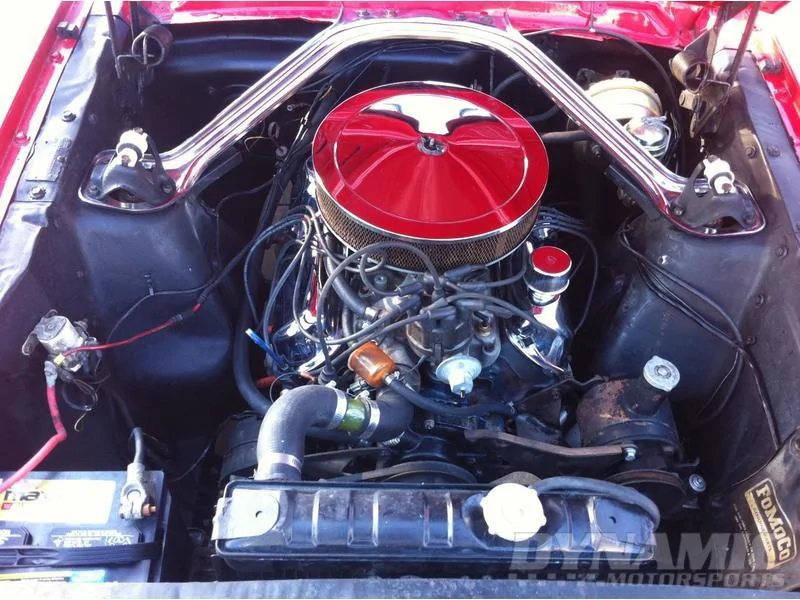

Long long ago, I suspect that the strut tower brace gained popularity when cars had larger engine compartments and the shock towers were a significant distance away from the firewall. A '66 Mustang as an example:
Ford Maverick Steeda strut tower brace absolutely works brandons_car_001_
And when it was body-on-frame construction with most cars back then, the inner sheetmetal may not have been built as stiff & rigid because it didn't need to be (where a unibody car does).

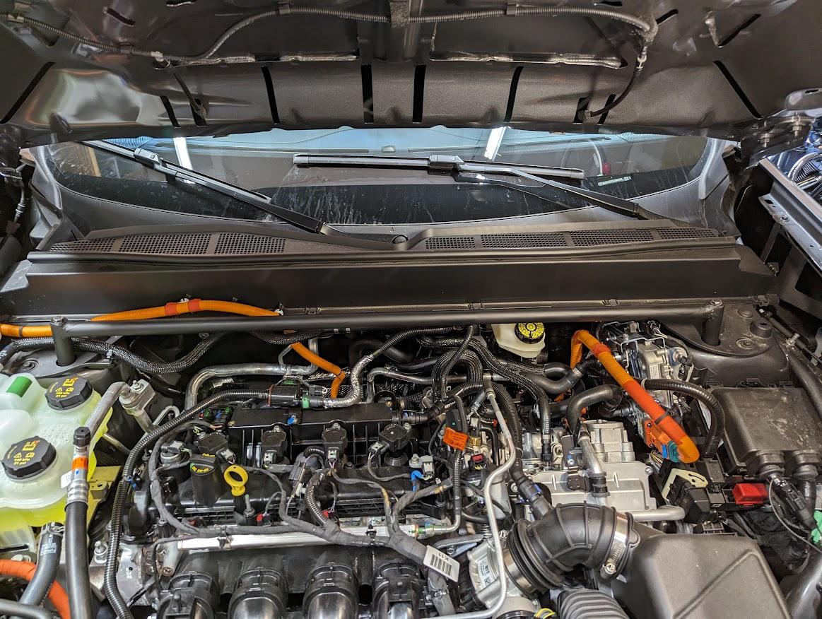

Compare that to the Mav:
Ford Maverick Steeda strut tower brace absolutely works 017-2022-ford-maverick-hybrid-review
I haven't looked closely under the plastic trim, but I wouldn't be surprised if the backsides of the strut towers are incorporated right into the firewall. I expect that the firewall would be a pretty good strut tower bar.
Plus, wouldn't the rubber in the top strut mounts flex more than any steel would? Adding a bar doesn't address all the compliance from that and from the suspension's other rubber bushing squishy parts. I've had a car in the past where I replaced every rubber bushing with Delrin, added camber plates, and a strut bar and that made a heck of a difference that could be felt. But not all in a good way. That car on an imperfect road could knock your fillings loose.
