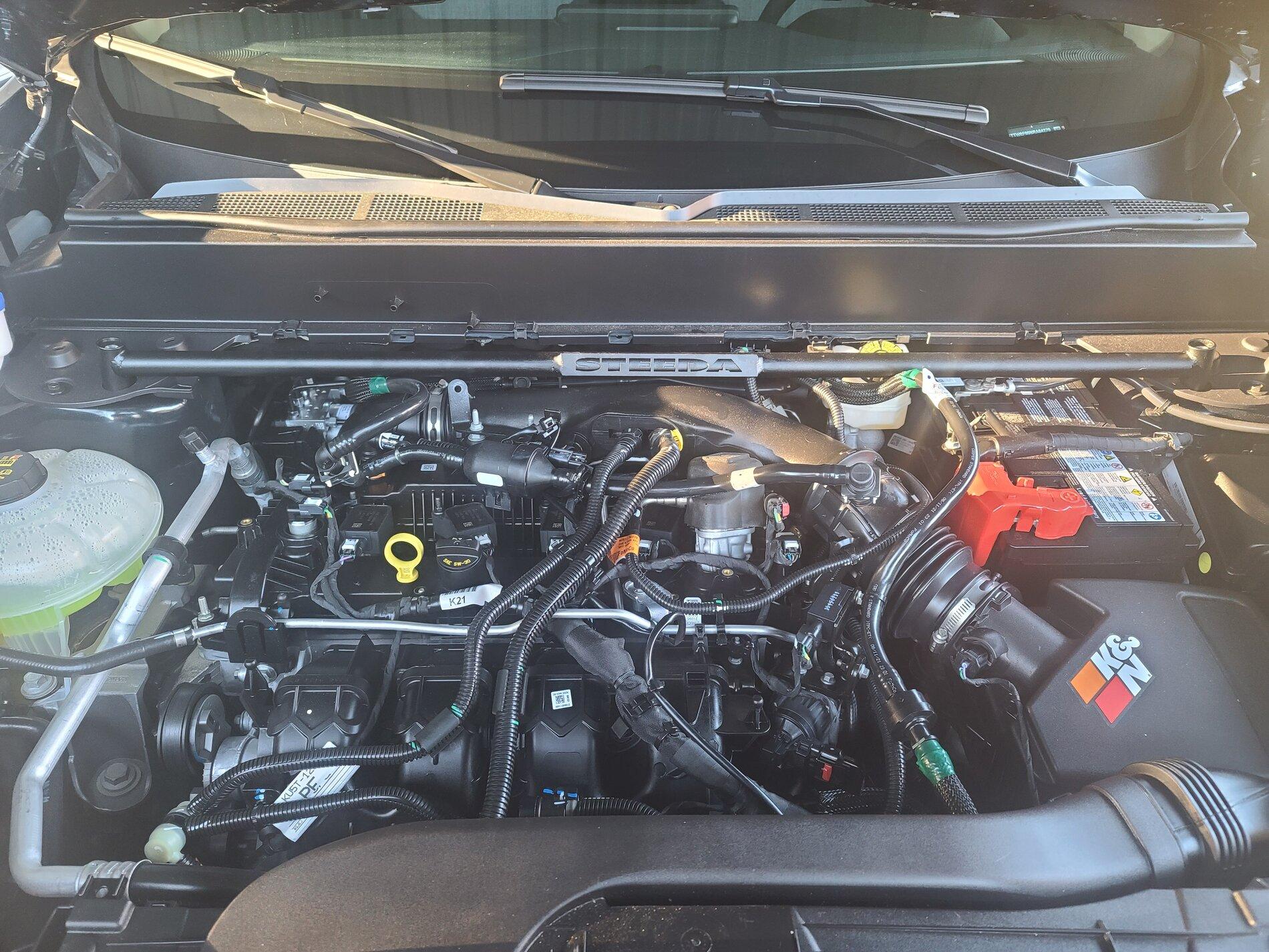

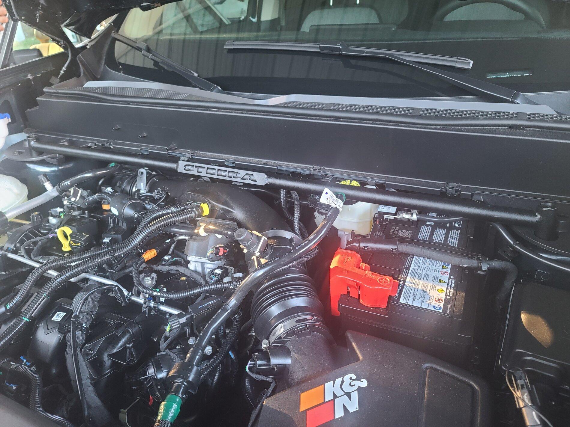

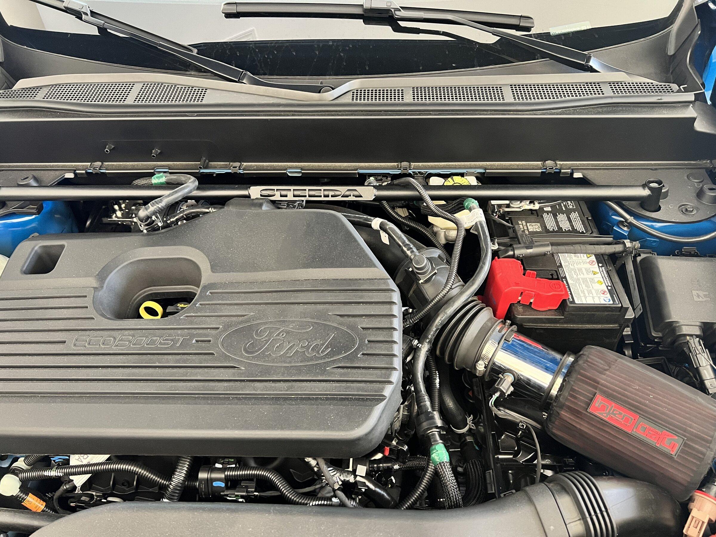

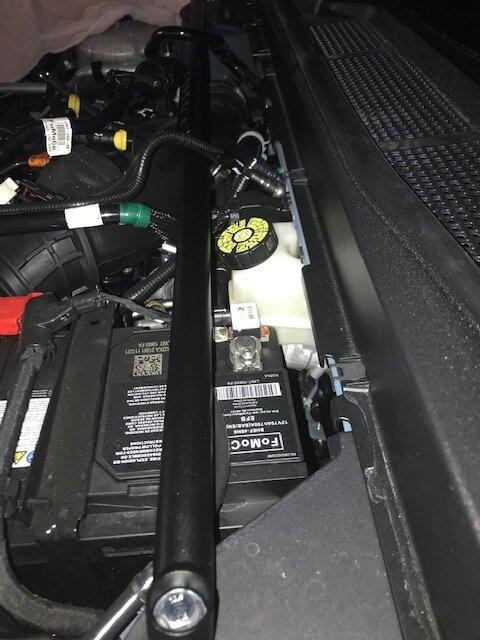

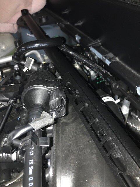

Just a FYI.. The Steeda STB for the 2020+ Escape and 2021 Bronco Sport will work for the Mav. I test fit ours last night. Only issues are some routing of the bar around the hoses and sensors on top of the intake tube.
NEW INFO

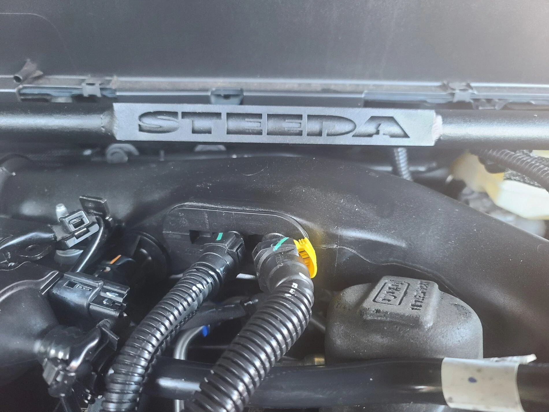

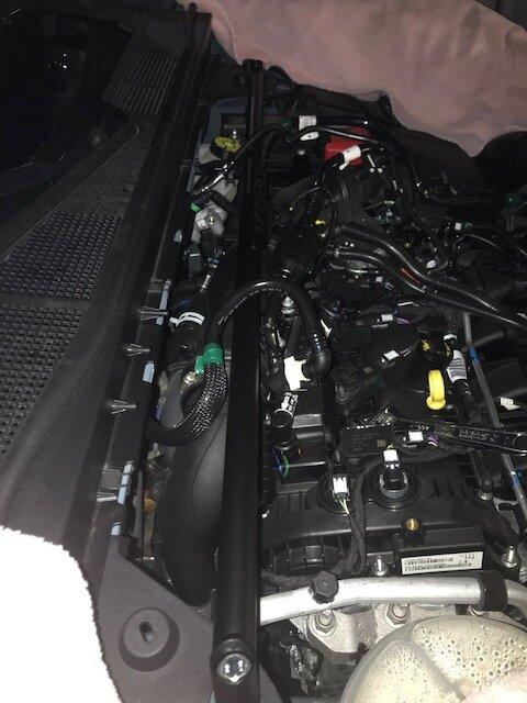

The brace 100% fits and works. As you can see in the pics, I rerouted the hoses and lowered that ugly apparatus near the intake tube and it looks much cleaner. You can feel the difference in the steering wheel. It just feels tied together tighter.
I installed my brace last evening. I didnt go with the rerouting of the hoses as Evil2ltr did, which certainly does make a cleaner look, but I just slid the strut bar between the different hoses as well as bending the bracket forward some-- the bracket that the "pod" is attached to. It allowed the brace to be installed easier but the "pod" does lay against the Steeda part of the bracket. I didnt notice any vibration noise from that area when I started up the engine, so until I do I will leave the "pod" where it is. I also used a small amount of Anti-Seize on the new bolt supplied by Steeda. Hopefully that will prevent any removal issues down the road. I took some pics of the brace from the side so you can see how the removal of any fluid cap and battery cable is not compromised. I also believe that battery removal would not be an issue as you can remove the air intake housing and lift and bring the battery forward. Hope these views answer any more questions and Thanks to Evil2ltr for the thread start.
Ford Maverick Steeda Strut Tower Brace installed (pics added) IMG_3546
Ford Maverick Steeda Strut Tower Brace installed (pics added) IMG_3545
Ford Maverick Steeda Strut Tower Brace installed (pics added) IMG_3544
Ford Maverick Steeda Strut Tower Brace installed (pics added) IMG_3543
