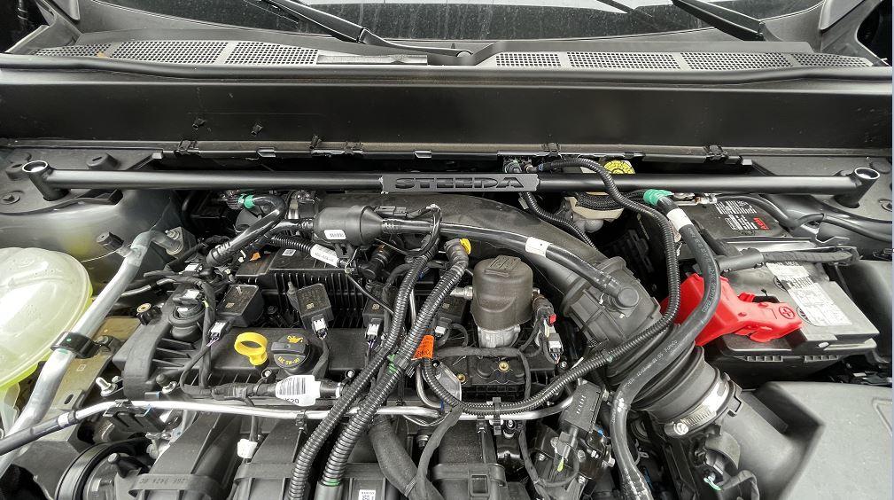

I installed my brace last evening. I didnt go with the rerouting of the hoses as Evil2ltr did, which certainly does make a cleaner look, but I just slid the strut bar between the different hoses as well as bending the bracket forward some-- the bracket that the "pod" is attached to. It allowed the brace to be installed easier but the "pod" does lay against the Steeda part of the bracket. I didnt notice any vibration noise from that area when I started up the engine, so until I do I will leave the "pod" where it is. I also used a small amount of Anti-Seize on the new bolt supplied by Steeda. Hopefully that will prevent any removal issues down the road. I took some pics of the brace from the side so you can see how the removal of any fluid cap and battery cable is not compromised. I also believe that battery removal would not be an issue as you can remove the air intake housing and lift and bring the battery forward. Hope these views answer any more questions and Thanks to Evil2ltr for the thread start.

I installed my Steeda Strut Tower Brace on my XL AWD yesterday - installation went relatively smoothly. The most difficult part for me was moving the hoses out of the way. I tried to put the brace on without re-locating as others mentioned here but it wasn't even close to happening.
For those who want to install the strut tower brace; re-locate the hoses; AND have the foam engine cover...you have to modify the engine cover for it to sit close enough to the bolt/studs due to the placement of the re-located hoses. I did this by using a fine tooth saw and cutting away the foam until it sat into place.
If you take it one step further and have an oil catch-can on the clean side, I don't really see anyway to install the engine cover without it being completely butchered.

I've installed mine yesterday with minimal effort and re-routing hoses, it took around 30 minutes:
Ford Maverick Steeda Strut Tower Brace installed (pics added) sstb
Did installing the brace improve handling of the truck? Yes, the front end feels stiffer and somewhat improved steering as well. The change isn't huge, but in my view, it is worth of the 130 bucks. Since my Chachky will be on the road 99% of the time, like the majority of the Mavericks, there's no reason to worry about the impact of the brace for off-road driving.

Just a FYI.. The Steeda STB for the 2020+ Escape and 2021 Bronco Sport will work for the Mav. I test fit ours last night. Only issues are some routing of the bar around the hoses and sensors on top of the intake tube.
NEW INFO
The brace 100% fits and works. As you can see in the pics, I rerouted the hoses and lowered that ugly apparatus near the intake tube and it looks much cleaner. You can feel the difference in the steering wheel. It just feels tied together tighter.
