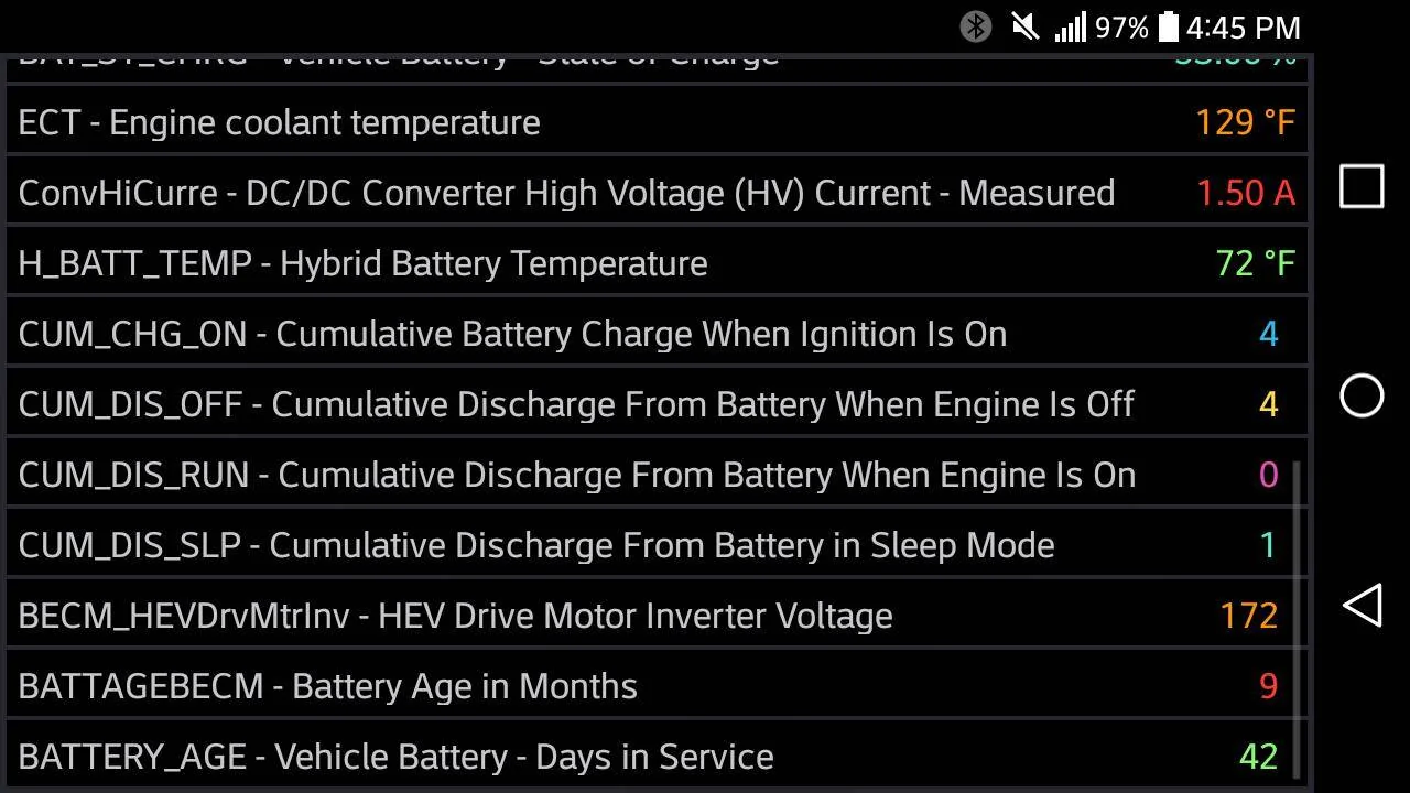

You should add the PIDS for Cum (search for that) - should be 4 of them. I think that's used more. Seems to be AmpHrs into and out of battery. I'm always on negative side.

That's interesting. What would the units be of the cumulative charge/discharge measurements?

Whatever the Units are (presumably AH?) it appears that the ignition on replacements did not include the draws that happened during the sleeping?
