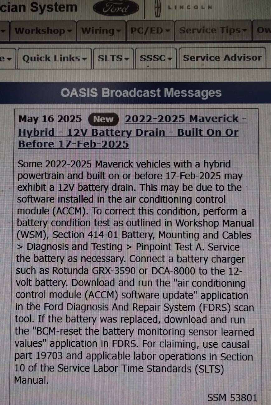

2023 Hybrid XLT
SSM 53801 2022-2025 Maverick - Hybrid - 12V Battery Drain - Built On Or Before 17-Feb-2025
Some 2022-2025 Maverick vehicles with a hybrid powertrain and built on or before 17-Feb-2025 may exhibit a 12V battery drain. This may be due to the software installed in the air conditioning control module (ACCM). To correct this condition, perform a battery condition test as outlined in Workshop Manual (WSM), Section 414-01 Battery, Mounting and Cables > Diagnosis and Testing > Pinpoint Test A. Service the battery as necessary. Connect a battery charger such as Rotunda GRX-3590 or DCA-8000 to the 12-volt battery. Download and run the "air conditioning control module (ACCM) software update" application in the Ford Diagnosis And Repair System (FDRS) scan tool. If the battery was replaced, download and run the "BCM-reset the battery monitoring sensor learned values" application in FDRS. For claiming, use causal part 19703 and applicable labor operations in Section 10 of the Service Labor Time Standards (SLTS) Manual.
They have coded the causal part number to the a/c compressor, so it will be covered 3/36, and I already checked and it is covered under Ford Premium ESP also...(not sure about the other level contracts)

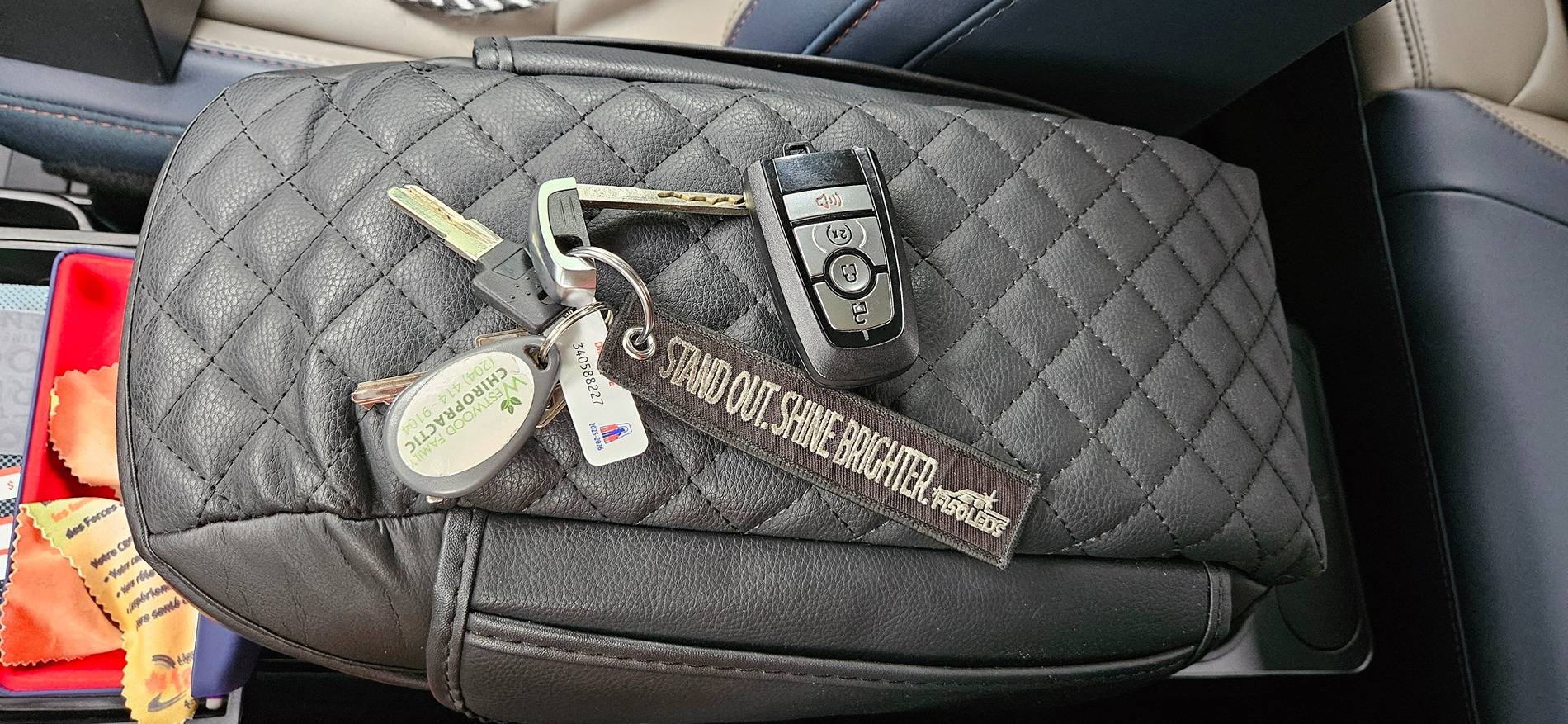

You shouldn't have to worry about getting the door open in a dead battery scenario.
There is a manual key slot in the driver door and the fob has a key in it for situations like this.
Once in, you should be good in the chance you experience a dead battery...you have a li booster pack under the seat that has been maintained/charged regularly, right!

I forgot to add the pic, here you go!
Andy
Andy
Cheers,
Andy
Thanks, this is something I never noticed and didn't ask the sales rep. Now I know. My EV had this ability too so it was never a concern.

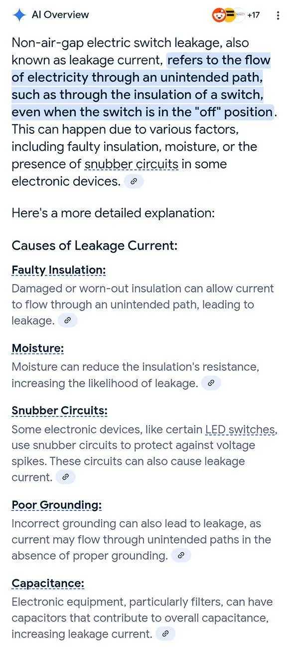

Out of all the things we suspected...I don't think anyone has AC on their mind.
Unbelievable - and this should be more than a SSM but next time I take mine in i will see if they can get it done.
I questioned if there could possibly be a Non Air Gap Switch Leaking in the off position.
