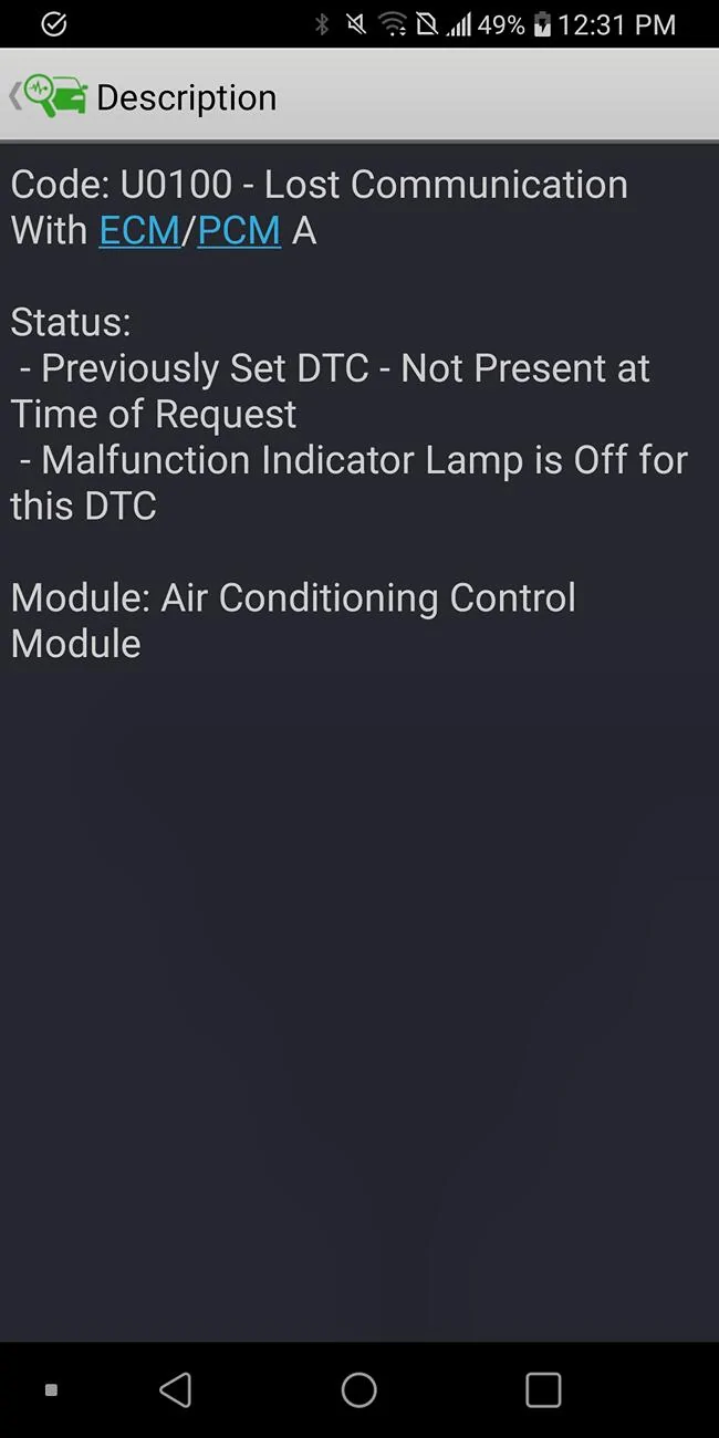

The issue being with ACCM rang a bell - checked my Forscan Lite error logs.
Audio Control Module (ACM) sometimes has an issue communicating.
ACCM very constantly does. U0100. Almost daily.
Get a module in a state where it just wants to finish that communication - it'll keep trying again and again. At least mine ends with error it seems.
Now, if the ECM/PCM is indeed off at a certain point, does the ACCM stay up trying to finish last task?
Don't know - but that's a known way modules cause a parasitic draw, they shouldn't be on but they are. All kinds of fun youtube videos on them.
Explains why SSM used to say disconnect negative battery terminal to reset the system.
I just reset that module, just for grins, to see if communication issue shows up again, and reset the DTC's.
Ford Maverick SSM 53801: 2022-2025 Maverick Hybrid 12V Battery Drain Issue Update Fix Released! Screenshot_20250516-123130

Combined with my ACCM not communicating with ECM/PCM (which I could see being the controller of said fan) - some interesting combos.
