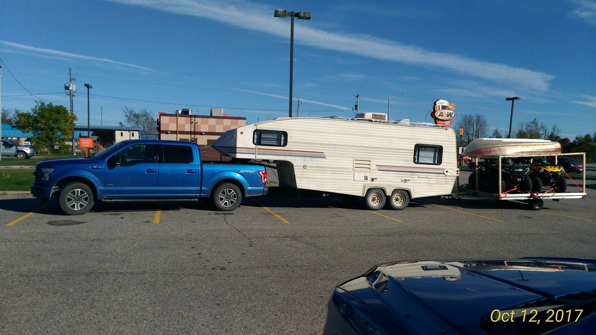

This is an example of a towing situation I would not personally be involved in. When I took it, I thought I might some day be in a position to use the photo to make a point. It was taken in the Metro grocery store parking lot in Sturgeon Falls, Ontario. Date is on the photo.
WE all have seen even worse examples I would guess, but this is one I personally took and had in my files.
So, here we are, lets just look at it for possible problems.
I don't think the truck has any towing mirrors and pretty sure there is no backing this up, for very far. The 2nd trailer tongue length assures us of that.
I would guess he might be at or over his GCWR (Gross Combined Weight Restriction). I am guessing 5800 lbs for the trailer and 3000 lbs for the ummmm, utility trailer and cargo. just an estimate on my part.
Looking at it, how much stuff is packed inside the trailer, and where in the trailer. This is all about weight and balance. I am pretty sure they are headed out for a camping week or two.
The 2nd trailer might lower the Pin weight in the box of the truck, due to the weight of its tongue on the rear bumper of the 5th wheel....not in a good way I am thinking.
Is it a home made utility trailer, considering its load and aluminum rack?
Do you think the operator measured the pin weight after everything was loaded up? Or maybe ran it over a legitimate road scale for, you know, individual axle weights to make sure everything is not overloaded and potentially unsafe?
Do you think they would care if I would have mentioned that with the front of his trailer angled upwards like that, the rear set of tires/leaf springs are overloaded and the front set are underloaded? Hwy 17 is quite rough in most places, but they are fixing it slowly.
I have seen much worse examples of this, so have a look when driving down the highway, is that trailer ahead of you cranked way up or down at the front? Don't buy these 2nd hand...think of the stresses on the frame, etc as they tear down the road.
Do you think this is an example of "good enough"?
What is the rating of that utility trailer with the quads and extra gear piled on it, and what is the speed rating, load rating of the pizza cutter tires? Or are those quad tires or garden tractor tires...someone tell me as I don't know.
Do you think he checked and greased all his wheel bearings, torqued his wheel nuts before heading out as part of the maintenance an operator should do regularly?
How about the 5th wheel trailer brakes, are they good to go as they worked last year...?
I have so many concerns, but am I being too harsh?

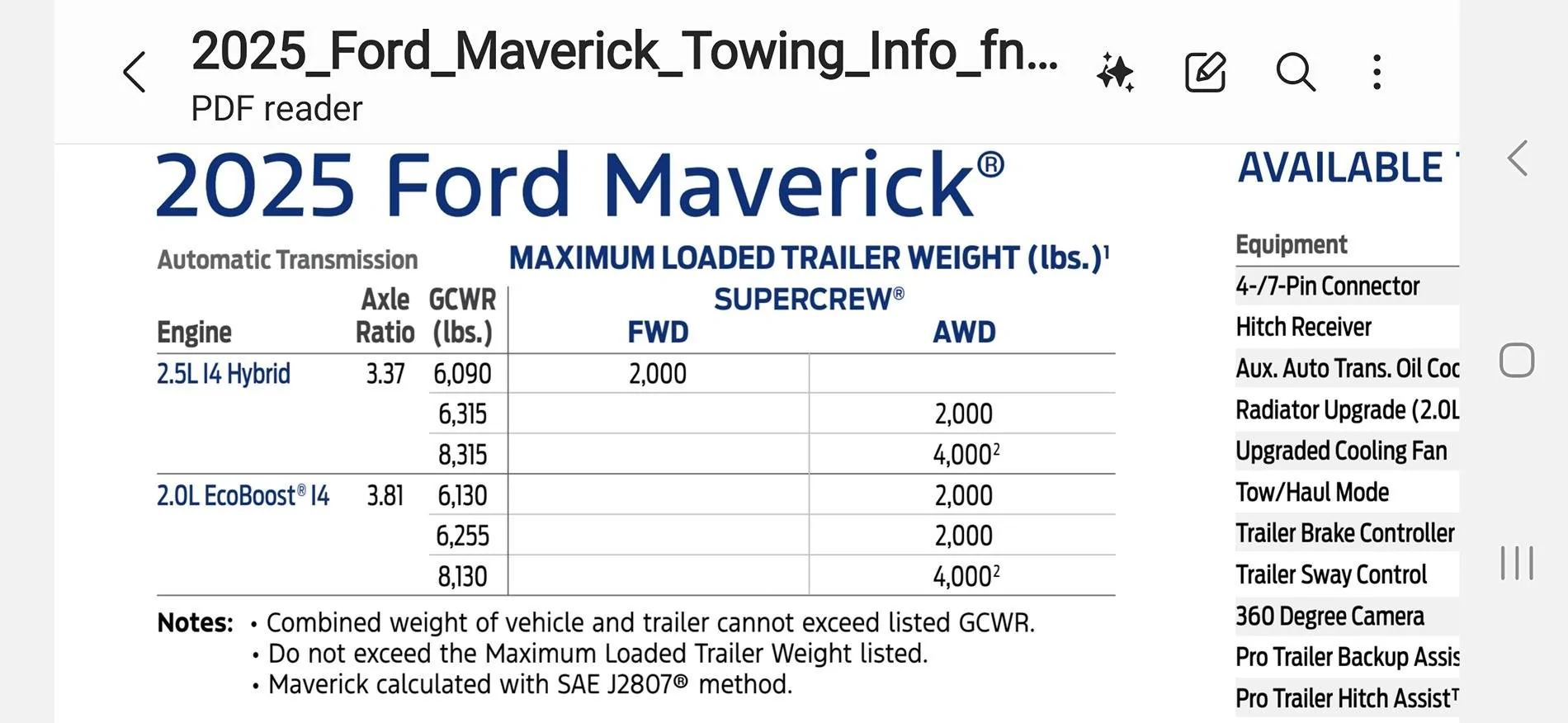

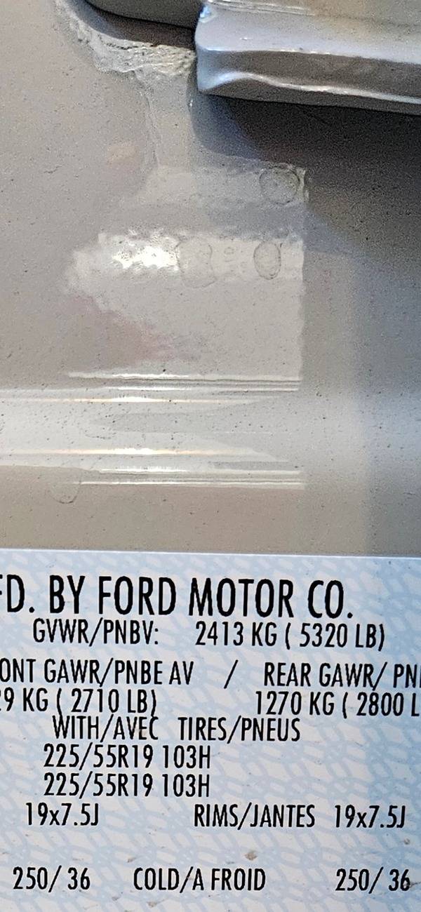

I will try to keep this short, and use my truck as the example of how to do your own calculations.
All weight references are attached below...
Shipped 1707kg/3763 lbs
2025 Maverick Lariat AWD Hybrid
4000 LB tow pkg
GVWR 5320 LBS
GCWR 8315 LB
Truck 3763 lbs
Driver 200 lbs
Safety gear 50 lbs
Hitch weight 20 lbs
Tongue lbs 400 lbs
Truck Total 4433 lbs
GCWR 8315 lbs
Truck weight 4433 lbs
Actual legal tow capacity within the GCWR is..............3882 lbs!
But wait, 400 lbs of trailer weight is on the tongue right?
So 3882+400=4000 lbs.
.remember, tow max capacity is 4000lbs.
You can top up your truck box load if you want to max load it for GCWR ONLY 118lbs more in the trailer.
A truck more realistically loaded to go camping.......
Truck 3763 lbs
Driver 200
Passenger 125
Safety gear 50
Packs in cab 100
All gear in box 500
Hitch weight 20
Tongue weight 400
Total 5158 lbs
GVWR 5320 lbs
Extra truck load capacity AVAILABLE IS....... 162 lbs or, 1 child and their stuff.
Allowable trailer weight to stay within legal limits
GCWR 8315 LBS
TRUCK LOADED 5158 LBS
Trlr weight MAX 3157 LBS on its axle(s),,,or is it...?
(Actually, trailer weight allowed is 400 LBS MORE, if you have done your trailer set up to THE MAX 400 lbs tongue weight). That weight on the tongue is carried by the truck hitch/truck.
NEW actual trailer weight if all parameters are met as above is....3157+400=3557 lbs.
At this max load, you might want to:
1 slow down,
2 drive conservatively
3 leave lots of room between you and what is in front of you.
4 Adjust your trailer brake gain a bit more aggressively to help get you stopped in an emergency.
Just a thought.
I hope this makes sense, and did I get anything wrong?
Have I towed badly/unknowingly? Yes, but I survived due to pure dumb luck. And here we are...don't be me!
Have a look at your numbers, maybe weigh your stuff.
Will anyone take the time to do their actual trailer calculations and post them here? That would be great!
Knowledge rather than..."that'll should be good, I hope".

It's helpful to understand that most of the numbers on the door sticker on your vehicle have nothing to do with legality for towing or hauling, many of those numbers are functionally irrelevant in a court room. The gvwr on your motor vehicle registration is your legal weight limit for the vehicle, in some states you simply specify it when you register. Your tires weight ratings are also a legal weight limits for the DOT when stopped and/or weighed. Your legal GCWR is the sum of your tow vehicle and trailers registered GVWRs within the limitations of your driver's license class.
SafetyGuy
SafetyGuy
Andy
May 1, 2025
1,002
1,829
Manitoba
2025 Maverick Lariat Hybrid 4K AWD
Thanks for the clarification.
I figured if we use the numbers they give us, it is a good way to go for normal towing to keep us on the straight and narrow.
I don't want to be in a situation where the official scales are needed as part of the investigation!
Cheers and thanks again for all your information!
I enjoy it a lot more when more voices are heard.
Andy

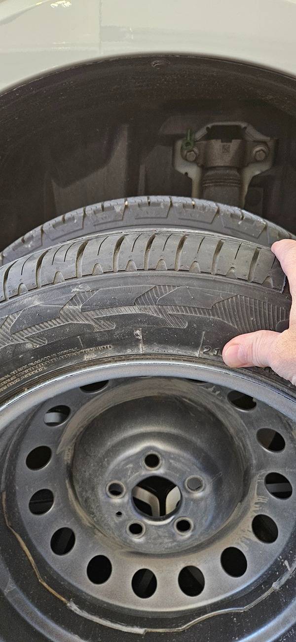

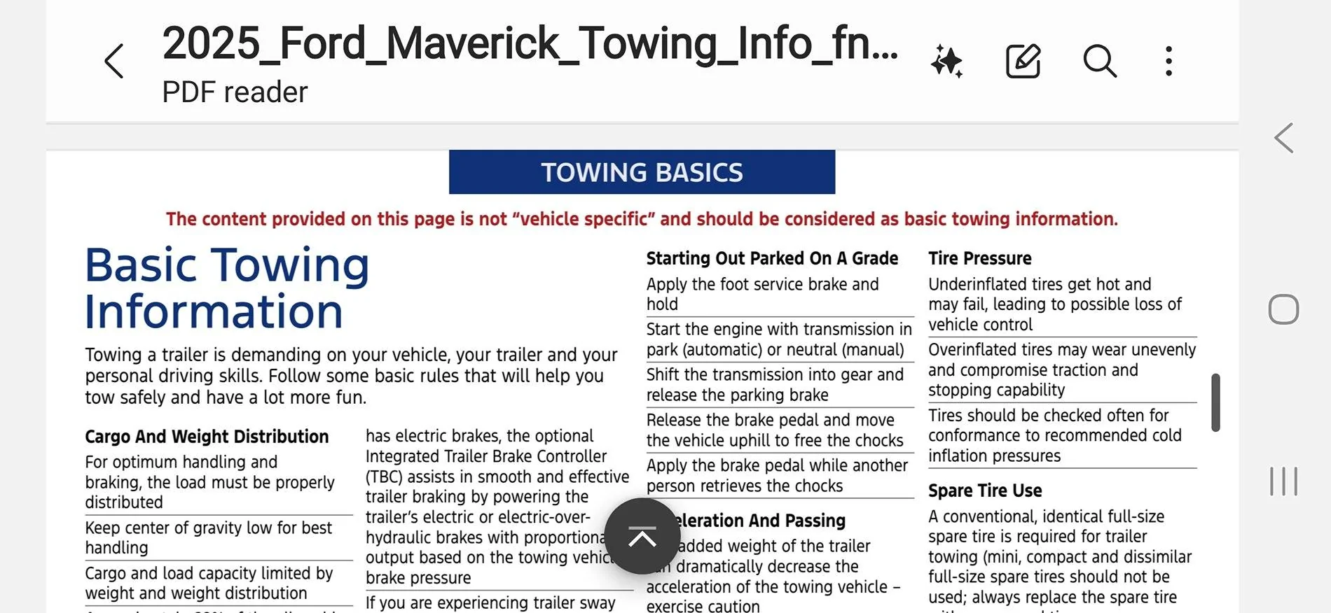

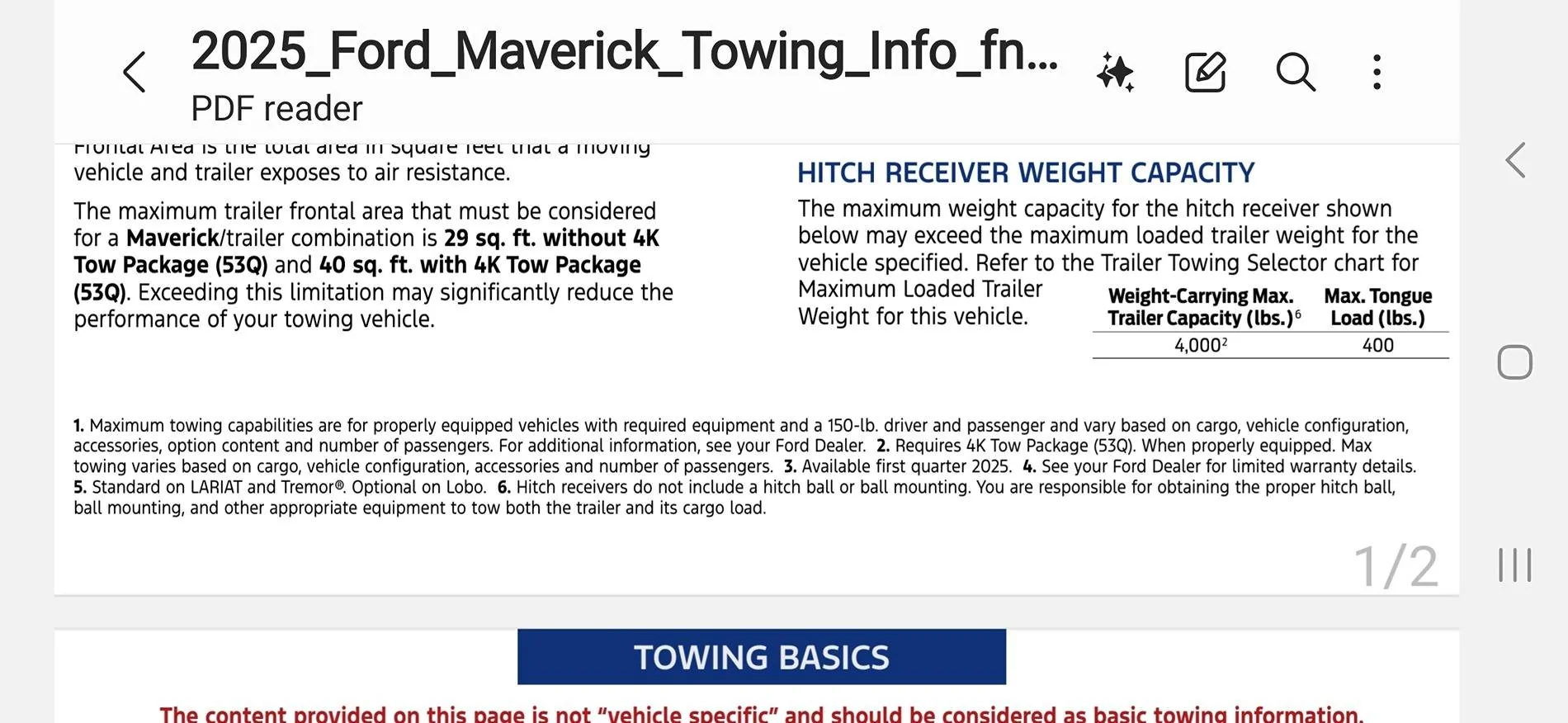

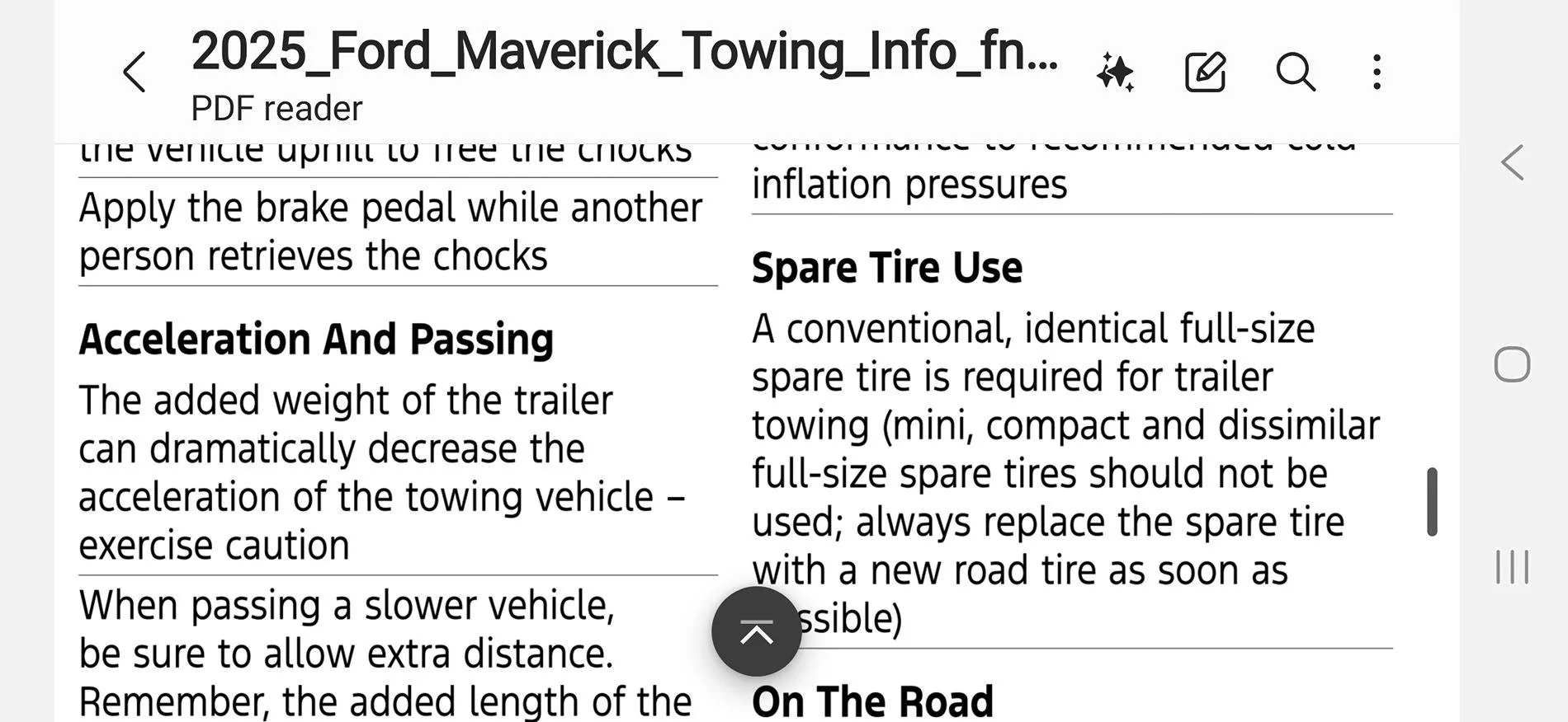

This mornings topic is your Mavericks SPARE TIRE SIZE!
Towing requires you to have a matching diameter spare tire, so, same as what you are running.
Ford Maverick SO, YOU WANT TO TOW A TRAILER, EH? 20250525_132105
Ford Maverick SO, YOU WANT TO TOW A TRAILER, EH? Screenshot_20250601_080540_Samsung Notes
Ford Maverick SO, YOU WANT TO TOW A TRAILER, EH? Screenshot_20250601_080524_Samsung Notes
Ford Maverick SO, YOU WANT TO TOW A TRAILER, EH? Screenshot_20250601_080512_Samsung Notes
So there you see my spare and normal tire, as well as Fords info regarding towing. The math is easy on this one.
I was going to make this another thread but decided to put it here for another reference/knowledge item.
You need a properly sized spare for your truck and trailer both!
Just think of the difference in rotations between the 2 tires sizes in 1 mile...a huge difference and your drive train will need to absorb the difference. I feel is not a good idea at any time, but especially when under load when towing.
My thoughts on it, will report on, when I find resolution with Ford, or my local tire shop...just depends how it goes. I will have a properly sized tire for my truck shortly.

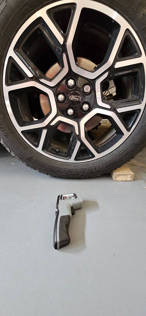

Today's towing tip is a pretty simple one...a good quality thermometer gun! (Bonus info below that, which can make this job even easier!)
Please keep in mind I am not selling or representing anything, just relating personal purchases and experience to try and help others.
Ford Maverick SO, YOU WANT TO TOW A TRAILER, EH? 20250607_154331
If you tow regularly or occasionally, one of the primary concerns once you hit the road (should be) your trailer (and tow vehicle) brakes and wheel bearings.
(I will touch on what type of bearing grease to consider in a separate post at another time).
If there is one thing I often see parked on the side of the road in the summer, it often will be a trailer with a wheel off, propped up or tilted over badly as the owner is off finding parts/tire repairs.
Many operators don't check/service their trailer brakes and wheel bearings sufficiently.
Bearings lose grease/seize and brakes get stuck or seize on...these all lead to excessive heat and even fire if not noticed in time.
So, on top of regular service, a thermo gun that you can walk around your vehicle/trailer and take the individual hub temperatures and is a cheap safety tool.
If one assembly is hotter then the other or rest, you will know ahead of time if you have trouble brewing!
The key to this is attention. When you start towing, don't go too far before your first check...it doesn't take long for heat to build up, notice it early and you can have a chance to fix it before things get really dangerous/expensive.

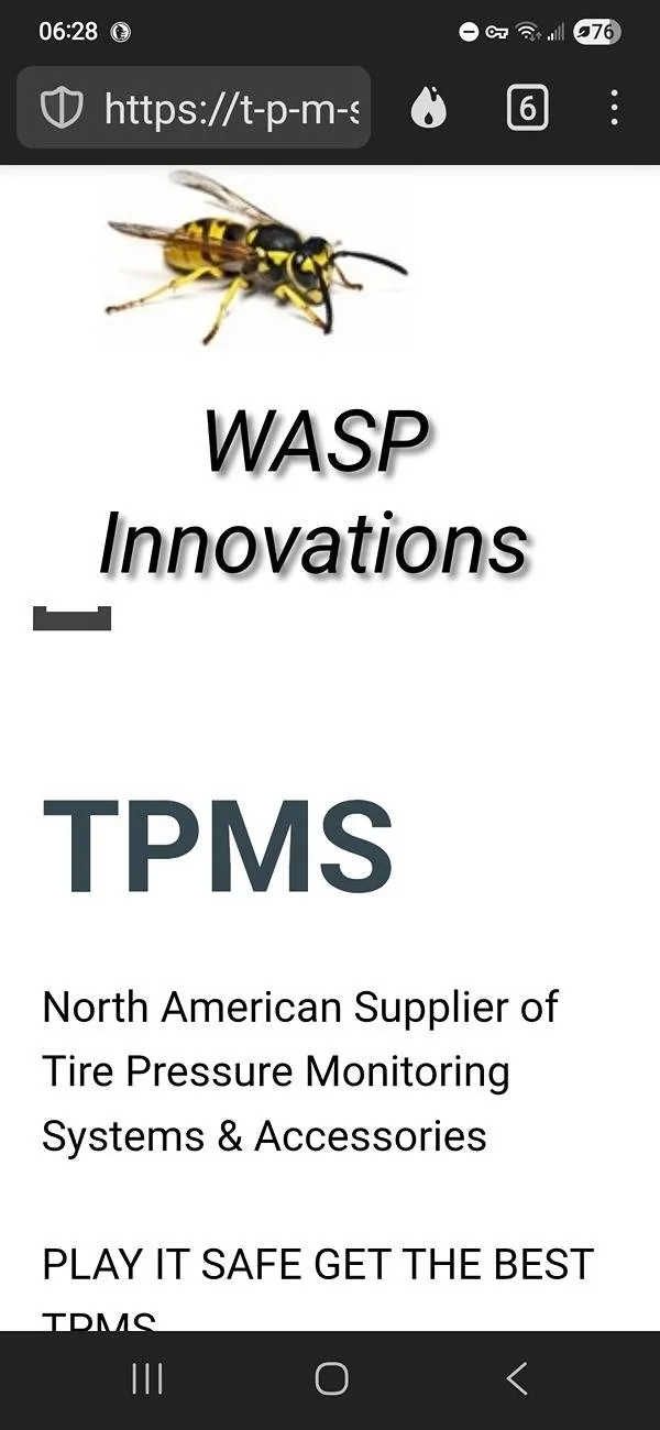

TPMS SYSTEM-PORTABLE
Now, if you want to take it a step further, and monitor your tire pressures and temperatures in real time, a TPMS system you can screw onto your tire stems is a great idea, and I can vouch for one example personally, Wasp Innovations. I had bought this when I was towing an RPOD 192 TT.
Ford Maverick SO, YOU WANT TO TOW A TRAILER, EH? Screenshot_20250608_062840_DuckDuckGo
There are many TPMS systems, and good ones are great and once you have them set up for your rig, it gives you your tire pressures and individual temperatures, with alarms you adjust as you learn your individual needs.
If I remember correctly you could monitor up to 18 tires with the one we had. All depends on what you need.
I bought enough for my truck and trailer both, as my vehicles didn't have any built in as many are nowadays. I also had 2 extra sensors, just in case one failed...none were needed, but I had them!
To do morning tire pressure checks, I would walk around and gently flick each tpms sensor on each tire a few times (WASP tpms need motion to report readings, this saves you batteries and they last a long time!).
I would then climb in my F150 and the monitor would cycle through and give me all my tire pressures...nice! And before the sun shines on them etc, to get true cold temps.
