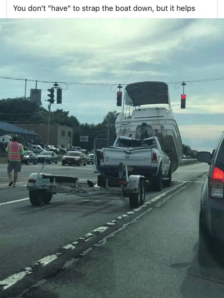

"Guess I shoulda tightened my straps a bit more...but my brakes worked fine..."

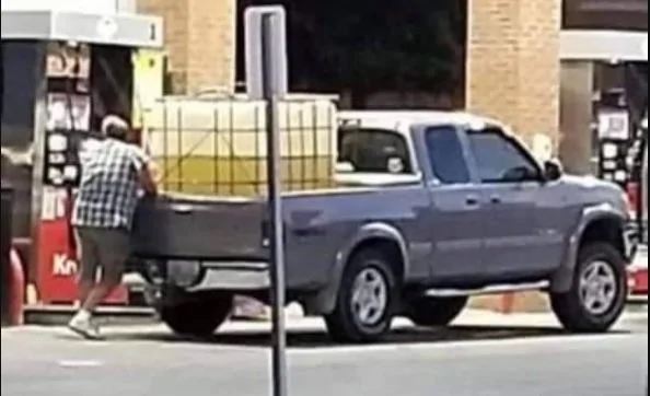

"Let's see...are IBC totes rated for gasoline? Is it DOT legal to carry this much gas? What's it weigh? Ah screw it there's a gas shortage now I gotta get home..."

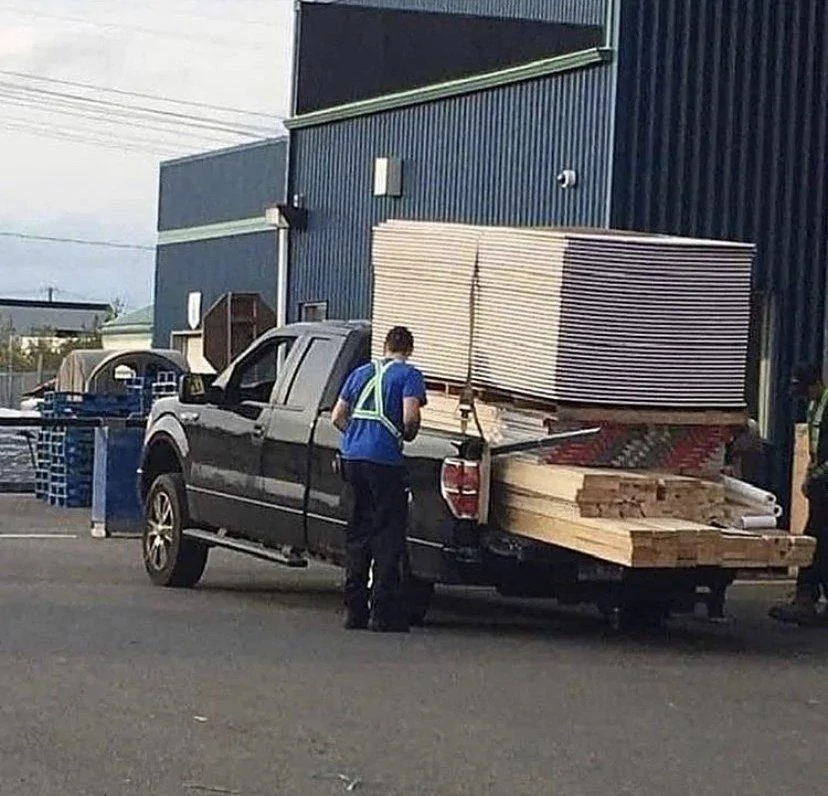

"Payload? Doorjam sticker? What that?..."

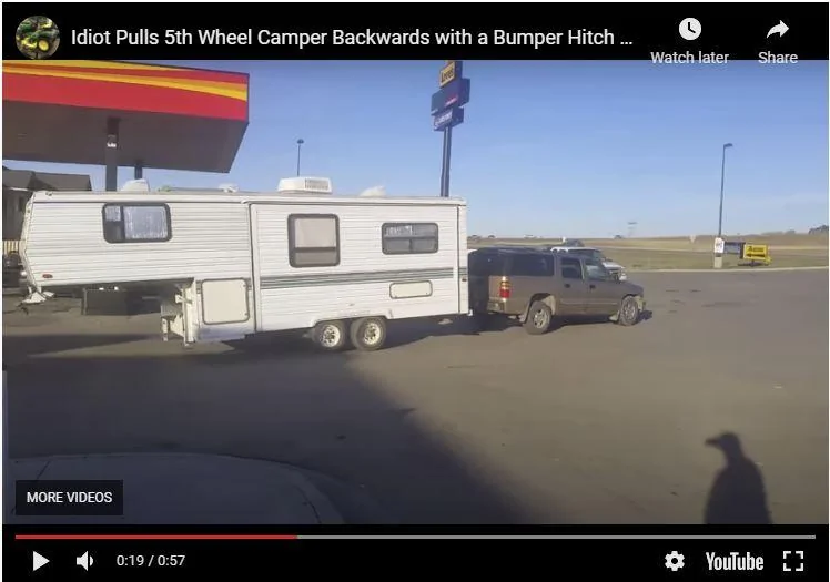

"Well I can't rig a 5th wheel hitch to my tow vehicle, maybe this will work..."

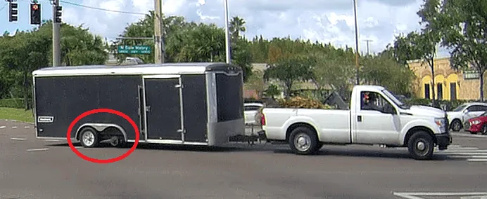

I just noticed the one without the tire. Whoever took this has not had a trailer tire go down. You can slowly make your way if a 4 tire trailer loses 1 tire. It'd just enough to get you to saftey or a tire store.
