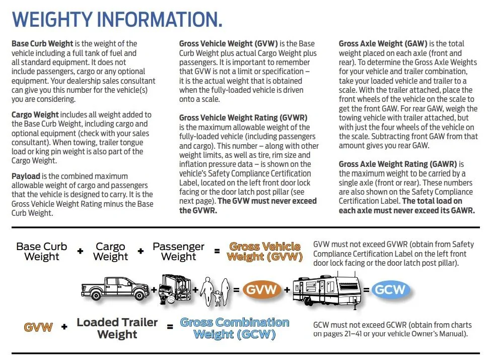

As far as I know, the hybrid Maverick has a 1564 pound payload capacity (eSource PDF) and a 2,000 pound towing capacity. I am considering picking up a base XL until the next gen of the Lightning (come on 800V battery system and more payload)
But anyhow, does this setup work, or would it be unsafe?
- Three people, weighing about 600 pounds combined.
- A 1,707 pound travel trailer, manufacturer specifies 160 pound hitch weight.
- Ultralight bed cap with cab over section (antenna removed) for extra storage space. Weight unknown, assuming 110 pounds.
- Up to 32 gallons of water in a tank tied down in the front of the bed, with associated fill/drain/pump hardware.
- Sufficient water for 14 days of off-grid time assuming 1 gallon per person per day.
Payload calculation seems to be 1564 (eSource PDF) - 600 - 160 - 110 - 277 = 417 pounds of payload capacity remaining.
Towing calculation is 1,707 pounds dry weight plus 10 gallons of water (83.4 pounds) = 1790.4 pounds, so 209.6 pounds towing capacity remaining.
I did see the Ford towing guide PDF did include a towing calculator at the end, but it didn't make much sense to me.
