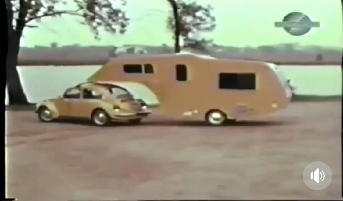

If a VW Beetle can do it, so can you!
1974 and way under 100 HP btw.
Even weight distribution to all 4 tires.
Nice feature with the Beetle is you can push the trailer into parking spaces.
No backing!

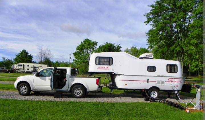

My Mind tells me it's possible, by using the rear 2" receiver and Inner bed tie downs. You all will think I'm crazy, but hear me out.
Remove the tailgate. Fabricate a receiver Heavy steel (At least 3/8" wall) hitch bar that u Turns from the hitch up to the bed floor, and goes on the bed floor to the front of the bed. Add A welded nut on top of the hitch so the hitch can be fully tightened solid in the receiver. A bar across to the floor mounted D Ring locations. Mount 5th wheel hitch on a plate, with 2 removable diagonal side riggers to mount into the tie down rail locations (at the 5th wheel plate) so the unit can be removed. Add 2 more Diagonal removable bars from the frond Floor D ring spots to the Upper Tie down locations on each side after removing the bed tie downs.
You now have a 4,000# rated hitch to tow a 2,000-3,000 Empty (3500# GWR trailer), with 16 additional bed bolts at factory tie down locations sharing and supporting the front half of the 400# 5th wheel weight. Lower the trailer to cut wind resistance. Sounds completely doable.
