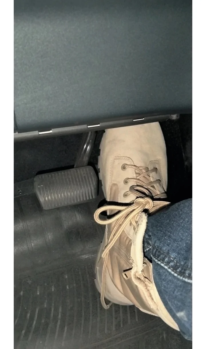

OMG I have 14 XW's and last week somehow my foot slipped off the go pedal!!!
14 XE'S Somehow slipped ???😲😲
I don't exactly know how that would have happened.🤷‍♂️
Here is my 14's on the gas pedal. My foot isn't slipping anywhere. I would have to try to do that.

MakinDoForNow
Sep 24, 2021
8,634
6,271
14 XE'S Somehow slipped 😲😲
I have my foot located so that I just pivot on my heel to work both pedals. So I have to work pedals more with my toes than you show. Apparently my heel would have been further to left than normal and the toe of my shoe was not high enough on gas pedal an when it depressed my toe slipped off. Was first time in 49.2k miles. 🤗
