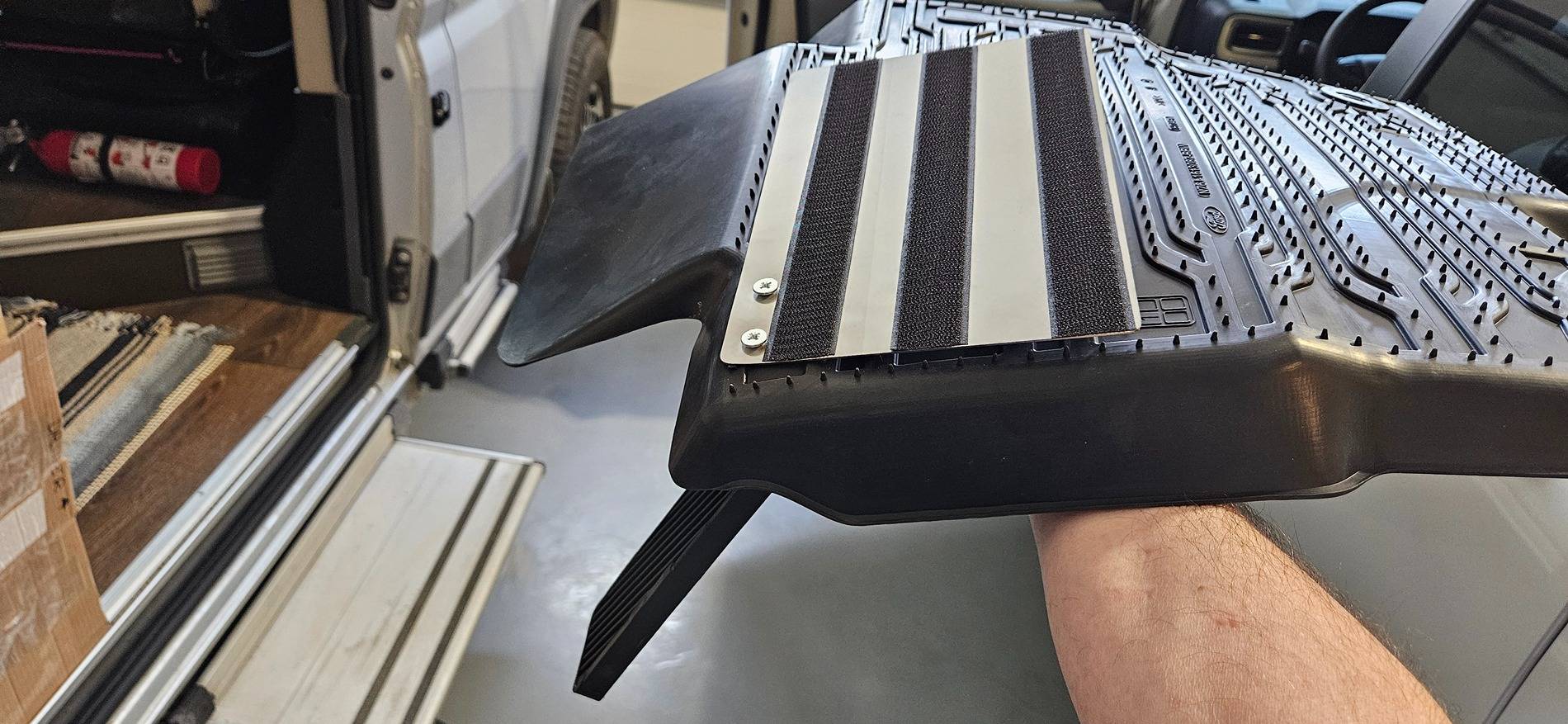

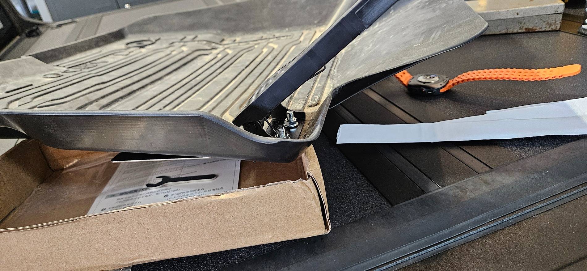

So this pedal is mounted on a thin metal plate that's attached to the rubber floor mat with only two tiny screws? 😬
Let's start at the bottom with carpet, velcro on bottom of a sizeable and STURDY metal plate (see pic's) which attaches to carpet for stability and aid in movement restriction, then two appropriately sized steel screws attach the steel bracket on the bottom of the pedal.
Also remember that the weather tech mats are attached securely at the back of the drivers foot well.
I should note that I will continue to monitor the safety and effectiveness of this mod as we go along...that is what I do.
So, there you go. As I have installed and tested it for safety and security for the task at hand which is to actuate the gas pedal, I feel for me that it is fit for purpose.
I hope this has alleviated your concerns and thanks for your feedback!
Cheers,
Andy

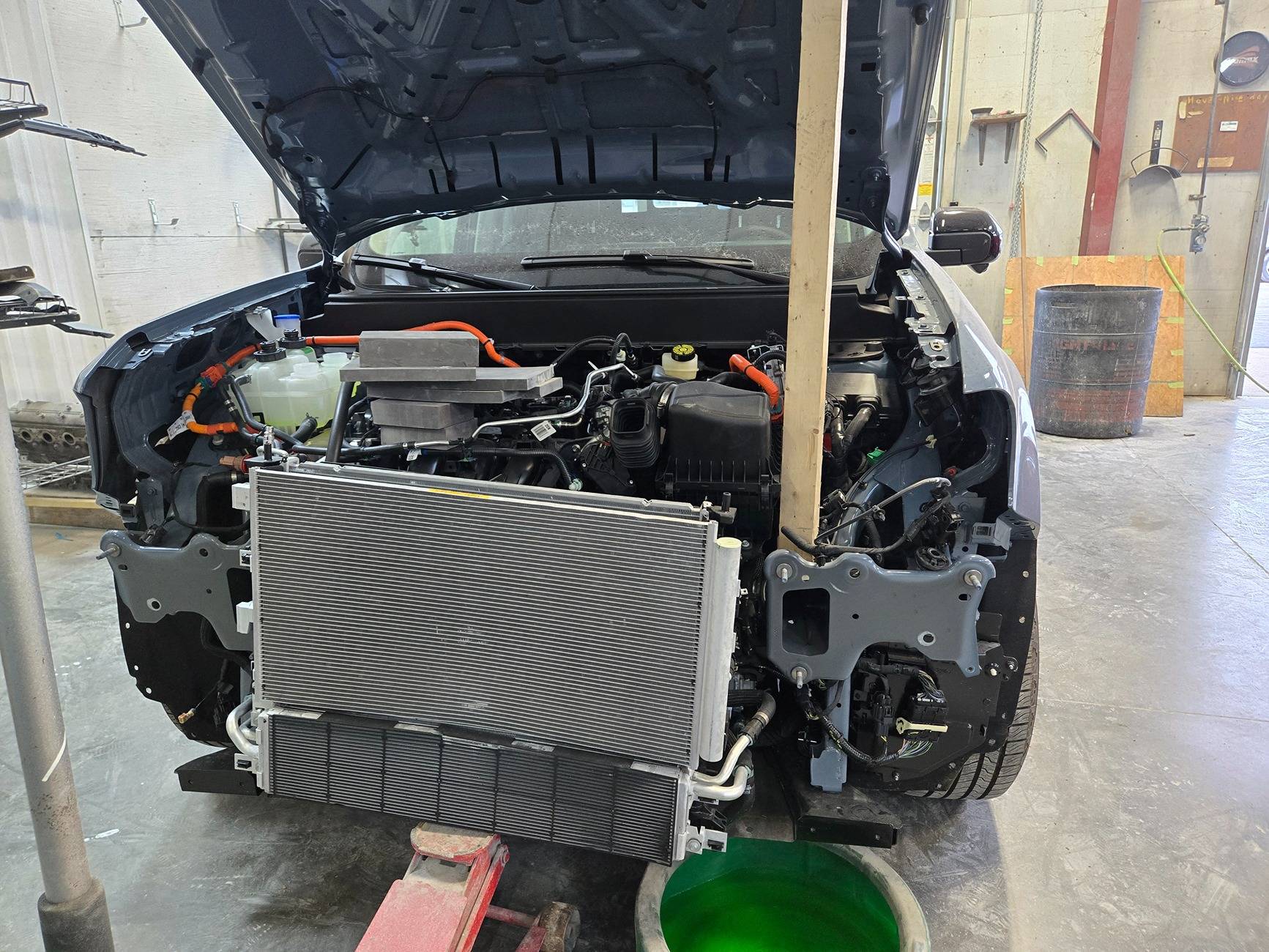

Damn! That idea would have saved me as nightmare! Thank you! My oily boot slipped off the brake and stabbed the gas pedal. After only driving my Maverick for three days, now in the body shop for six months waiting on a backordered $135 sensor harness. $10 in tape would have prevented $10,000 in damage.

(I reposted this to its own thread from the "is the gas pedal adjustable thread").

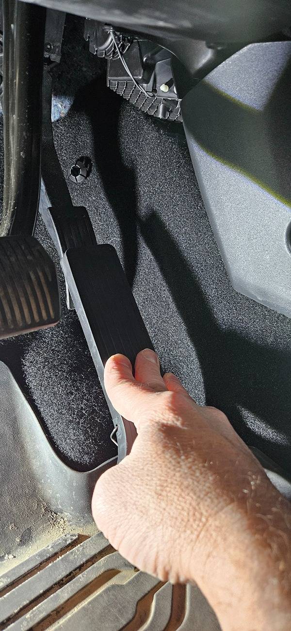

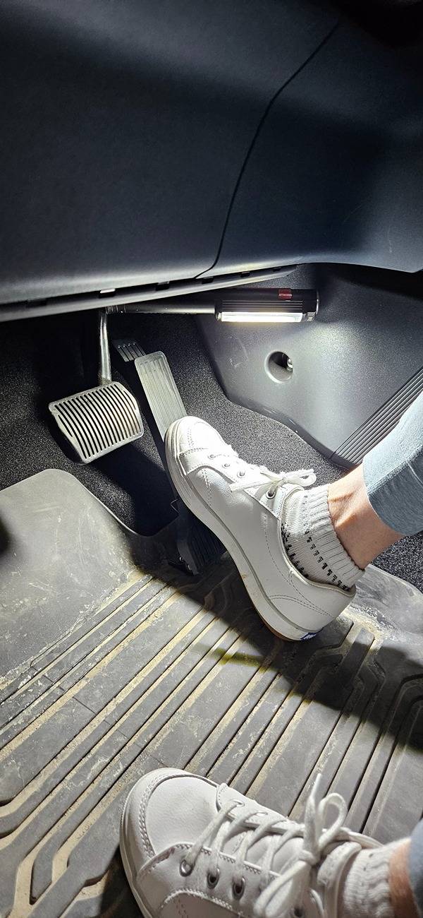

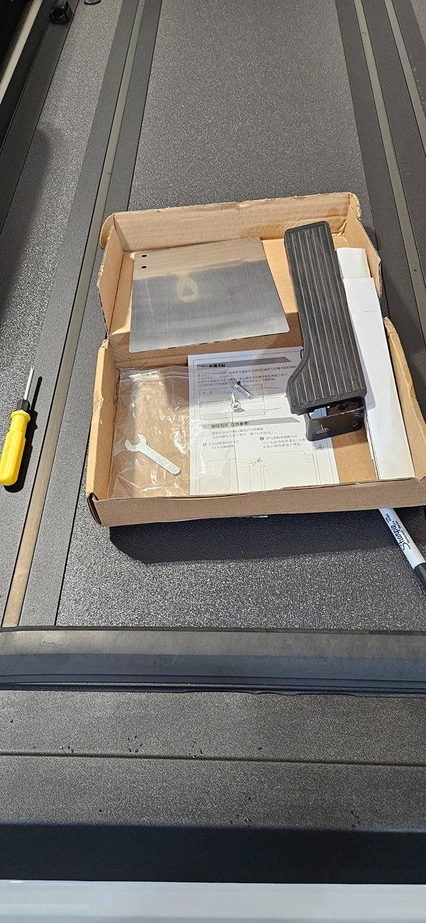

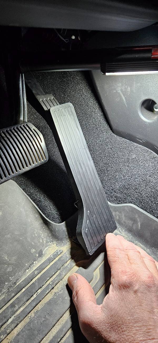

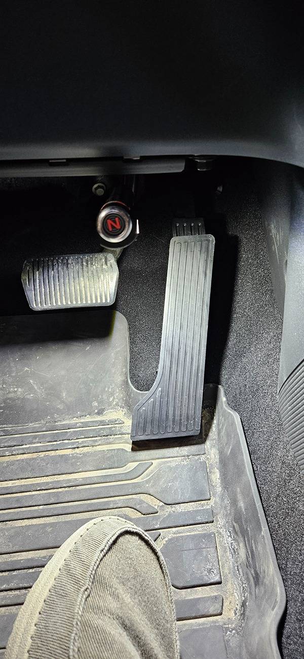

I have been reviewing several of the threads here for the problem of smaller statured people having their foot slip off the bottom of the gas pedal due to its position and smallish size.
So, after reading a lot of comments and exploring the inter-web for possible answers, my favourite solution is the one I laughed at the first time I saw it on Amazon.
Please let me explain my thought process. There were many, many intricate bolt on pedal extender solutions with even more points with potential for failure. And with what it's job is (operating the accelerator pedal), failure is not an option.
My solution (K-I-S-S principle)so that my wife (5 ft...er...tall...) can comfortably and safely drive the truck without screwing it up for me as I am the primary driver was what I call an "organ pedal". Same idea as I saw on one of the other threads from an older vehicle.
I now have a plate under my weather tech floor mat, 2 holes drilled through them after siting the organ pedal appropriately, and bolting the organ pedal down with 2 nuts. One of the nuts also has a spring attached to assist with the organ pedals return to neutral position when you take your foot off the accelerator pedal.
It is important to position the "organ pedal" so that it fully engages the trucks accelerator pedal with no chance of sliding off to the left or right. Or, slipping off the bottom if you stomp it hard.
I thoroughly tested it before mounting it to the floor mat and there is no way for it to lose contact with the pedal or jam it I any way...I am kind of persnickity about these things (okay, about pretty much everyrhing), but this in particular, right now.
The only thing I would say to add is a couple drops of locktite on the threads and then tighten/secure the nuts so they won't possibly back off.
I couldn't lock wire them in place but did witness mark them for inspection in the future.
I attached 3 straps of velcro to the bottom of the metal plate (they came with the pkg) and they secured nicely to the carpet under the floor mat. I like this, as it adds another layer of security that the plate will not easily move.
The reason this came to light this week is that it finally warmed up here in Manitoba that my wife didn't have her winter (snow) boots on, and they are quite a bit larger than warm weather footwear.
Okay, I hope this helps anyone else that runs into the same issue. I will now try to add photos to help those that need a photo or two to figure out if this is a solution for them...or not. Cheers!
Yes, the plate appears to be on the underside of the floor mat.

Good day, all.
I thought I would pop in a quick update on this modification, as we have had a bit of time with it in our truck.
The pedal extender has been working exactly as designed, with no problems or issues, which is definitely a good thing! No alignment issues, no slipping off the side of the gas pedal, no hooking or catching or any other impediment to safe operation of the gas pedal or driving comfort.
The only note would be thst the gas pedal feels just a little bit less sensitive, which is not an issue with us as I haven't noticed the difference after the first time or two we went out to run errands.
Now I am waiting for our first service at our Ford dealer (only half way to the 4 thousand mile/6500 km mark) as to what their thoughts may be on this improvement on the gas pedal actuation method!
