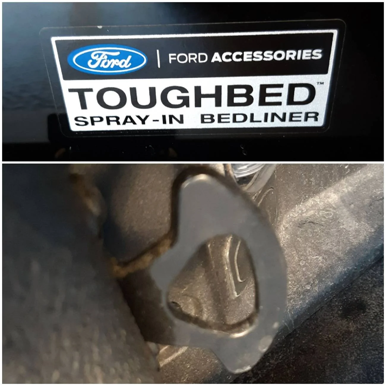

I am going to have a spray in bedliner done soon for my new Maverick XLT. I came across a thread about whether things such as the tie downs and D rings in the bed should be sprayed over as well? I know that the shop should plug or tape off the drainage holes when they spray but I hadn't really given any thought about the tie downs, etc until I came across this:
What are you thoughts on this matter?

A reputable shop will remove the hardware and not spray over it. Just ask the shop you are having the work done and they should be responsive to your concerns. I just looked at mine with the factory SIBL and nothing was sprayed over.

When spray in liners first started the companies that did them even pulled the bolts that held the bed to the frame. As time and cost increased, most just started spraying over everthing. That is why I got the one from the factory
