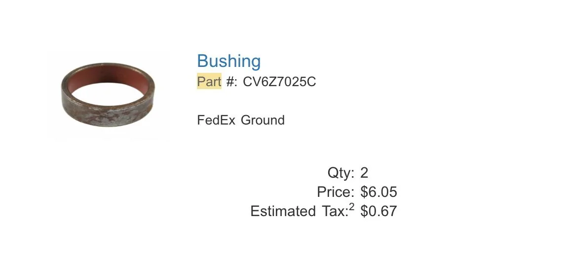

I still think it’s an issue the the case bushing/bearing. Still need to argue with dealership more but if I don’t get any resolution I’m going to replace the bushing myself. Will post updates as they come. Appreciate the input from everyone.

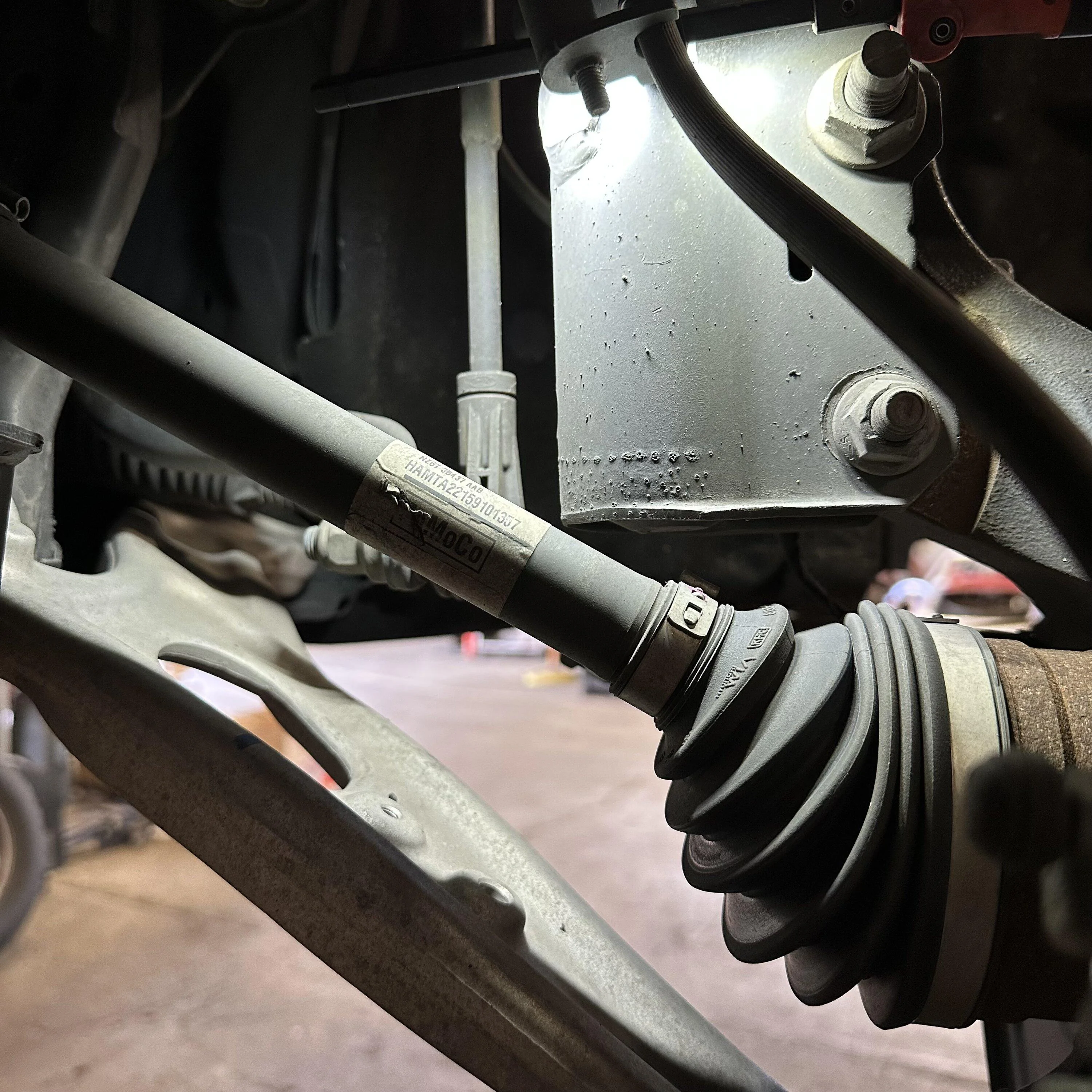

When you have the axle out, check the case bearing/bushing if you can. I’m not 100% that it is the issue with mine, but I’m fairly certain that’s where my problem is coming from. Below is the part I’m talking about.

Interesting. Recent '23 owner and have been looking at lifts/leveling and drops folks are doing on these Mavs. The lift angle difference in the CV shaft surely could be prematurely wearing these out slowly over thousands of miles. Once warped, it would just get worse. Perhaps a slightly more resilient bushing can be made since it is a quite a simple part? A 2" lift may not seem like much, but for a short rotating shaft, 2" can actually be a lot to compensate for (I can already hear the "that's what she said" reply coming :ROFLMAO:).

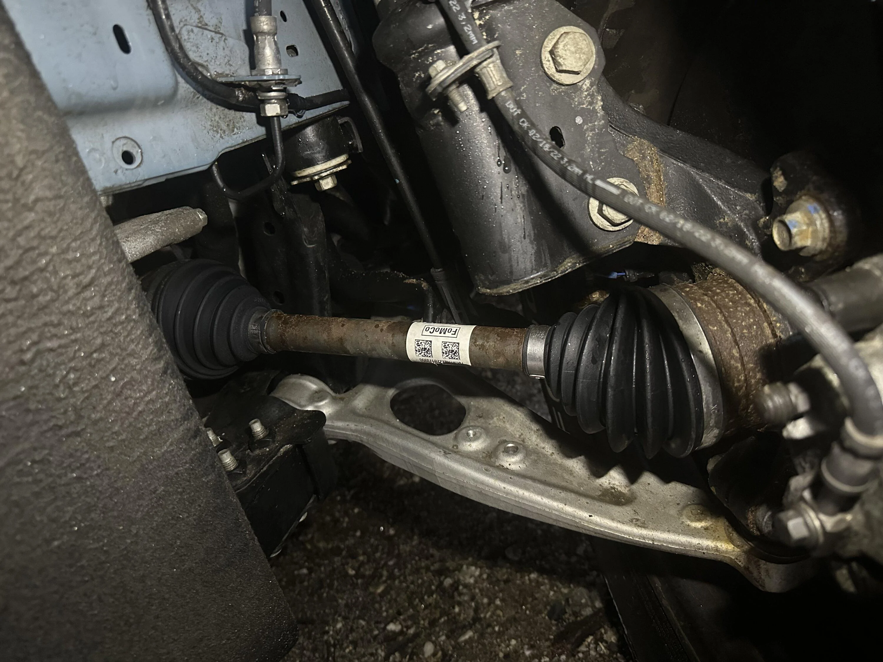

It was 100% my axle. My 2” spacer lift put my axles at such a drastic angle. One photo is my spacer lift, the other is with Eibach Spring lift. Replaced right front axle, swapped lift kits and an alignment today. No more wobble for now.

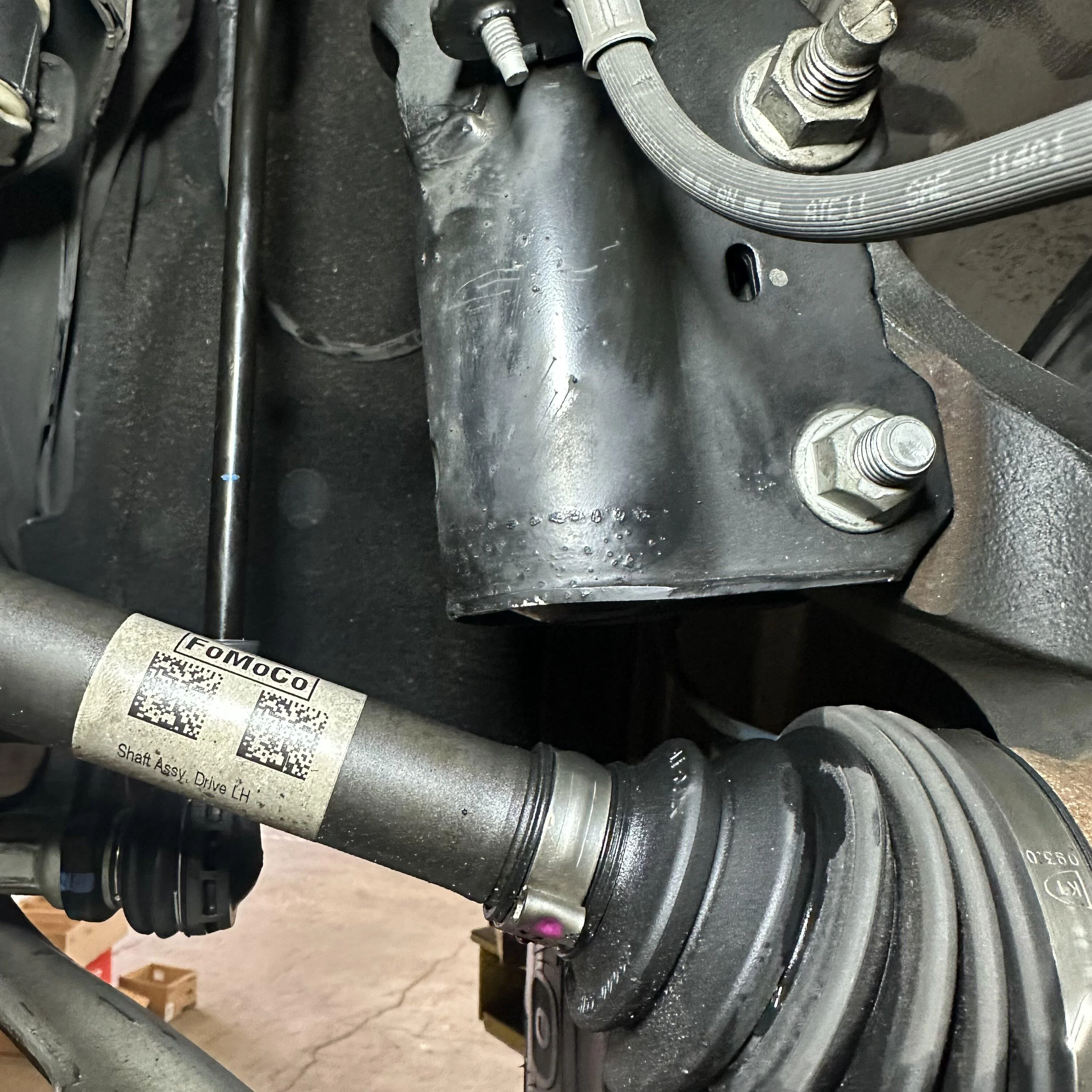

Were those pics taken while the truck is on a ship lift or is it sitting on the ground? The angle is way more drastic than mine.
This is a pic of my front left with the wheel turned all the way to the left. Not even close to what you have (if the pics were taken with the truck on the ground).
I agree that the life will cause more wear than normal, but 2” doesn’t seem like it would cause what we are experiencing so quickly. There are a few folks without the lift experiencing similar issues.
Full Droop on lift
