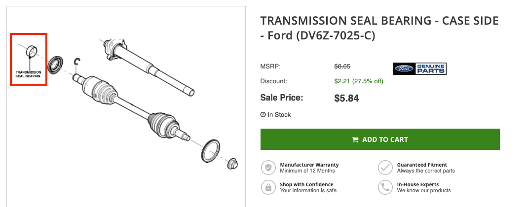

Would a loose driveshaft bolt cause movement where the CV connects to the transmission 🤔
Found a good picture of what I suspect the issue is coming from (transmission seal bearing/case bushing)

Just got back from the Ford dealership. They stated that the issue is cause by the lift and that the movement I'm seeing where the CV enters the transmission is "within the normal range". They noted that the lift is changing the angle of the CV, which is causing the wobble. So I basically got nowhere. They also did not inspect the transmission case bearing. Not too pleased that I shelled out $65 to have them not do a full inspection. But I guess at least I have documentation stating that the movement I'm seeing is normal.
Three main questions are still floating around in my head:
  1. If the lift is really causing the issue, why isn't it happening with the other CV shafts?
  2. If a 2" change in the angle is really that drastic, wouldn't the same thing happen on a non-lifted truck if you were on a slant that extended the suspension by 2"? I still have at least three more inches of travel beyond the lift :unsure:
  3. If it is the lift, why aren't we seeing postings from folks with the same lift having the same issue?
I did mention the Tremor that is coming out, and that that model has a 1" lift. The tech noted that the Tremor is going to have changes in the suspension that account for the angle change. Hard sayin' not knowin', but I have a feeling that the lift in the Tremor will be similar to the Rough Country lift I have installed.

I have work as an auto technician/ mechanic for the city of NY for 30 years . Judging from what I see on your video it seems to me that you have a bad transmission case bearing you said they did not check that bearing and I wonder why. The other side did not produce that amount of play. I don't know what there specification is on normal play. It's hard to make a diagnosis just from a video. Check it again.😊
Appreciate the input! They probably didn’t check it because it’s easier to say “there’s a lift on it, so that’s why you are having the issue” instead of properly diagnosing it. When I took it in I was supposed get the airbag recall done… but they forgot to order the airbag. Had the appointment for over a month and the service manager also called me the day before to let me know it would be better to drop off since the airbag replacement would take a few hours. Going to talk with the master tech when I go back to actually get the airbag replaced. Hopefully they are a reasonable person.
