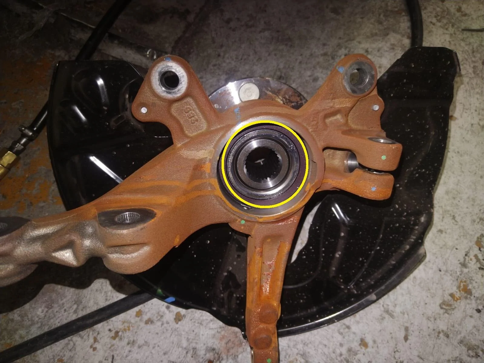

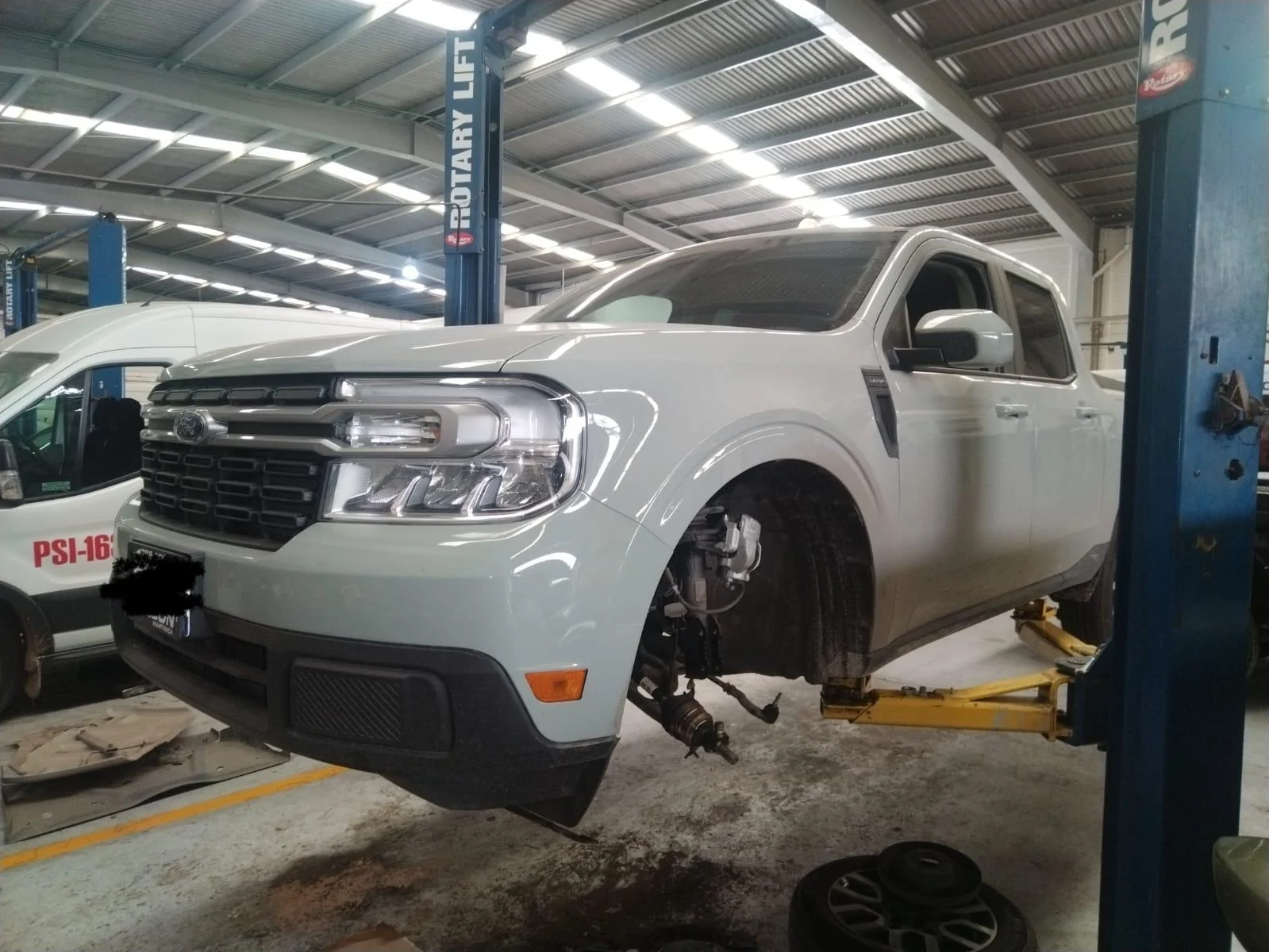

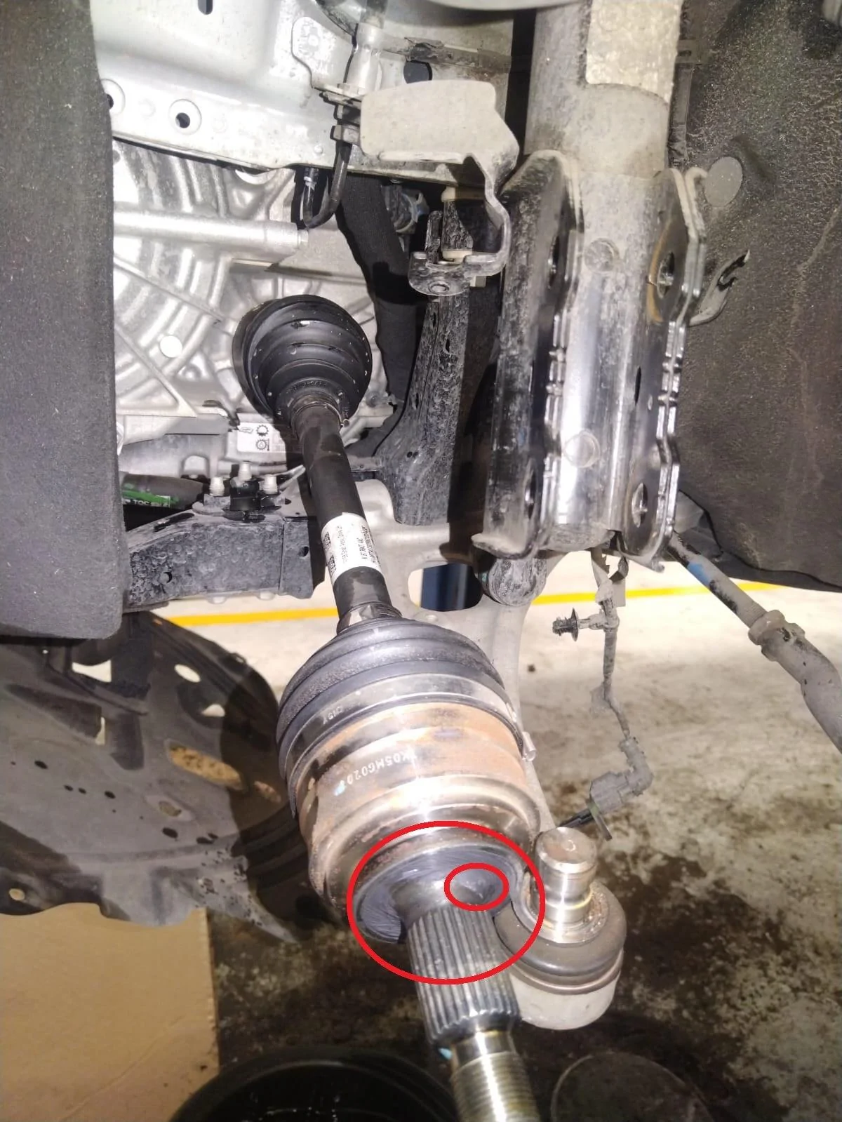

I'm from Mexico. I have a stock Maverick Lariat EB AWD and my Maverick started with the CV axle problem at 3000 km. It started making a knocking noise in the pilot wheel area during parking maneuvers.
In the process I told Ford Mexico many times that the problem was the CV axle and they denied it. He even told me that this was design noise. I helped the dealer to obtain the evidence with a route test.
Two days after my truck was repaired I heard the noise again but now in the transmission area.
I did a test with a glass of water to see if the engine vibration was transmitted to the cabin. And in the videos you can see that yes, I suspect that my problem was due to defects in the supports but Ford Mexico has denied that they are wrong.
Now even if they change them due to the time the truck was being used with problems, it would be very difficult to know what other components are affected.
I am trying to make a return for factory defects.
